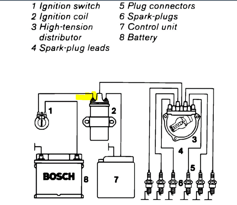

The first thing to check is if there is power the + on the coil. If there is and the coil is new, it could be the control unit. If there is no power, we need to trace it back to the ignition switch.
I attached a pic of the ignition switch below so you can see what I'm talking about.

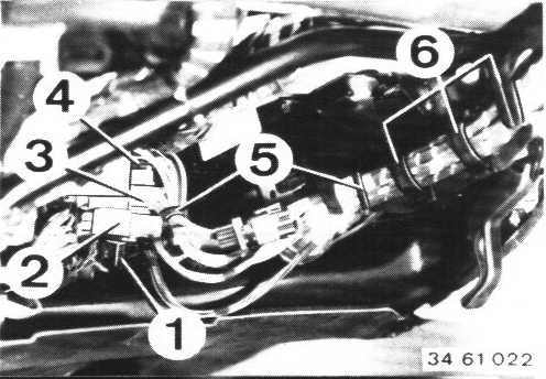

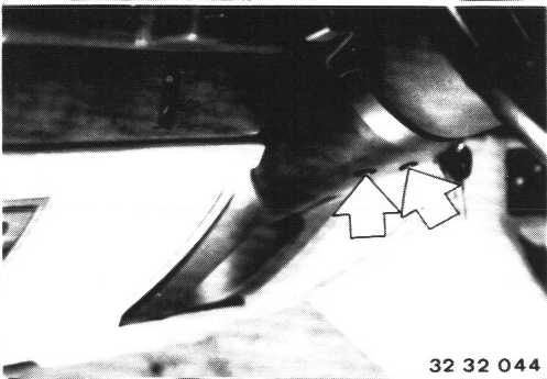

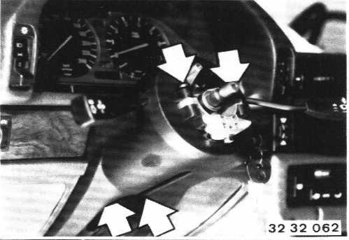

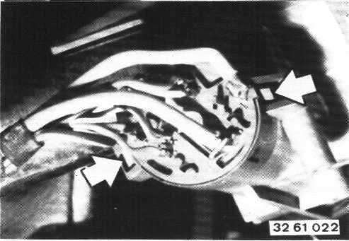

That means we need to go to the ignition switch and see if there is power out from the switch. This means the switch will need removed to access the wiring. At the switch, you will check the wire with the same color as the one on the + side of the coil. It should get power when the key is in the on position.
To remove the switch is a little involved. I am going to provide the directions for replacement. Although you are not replacing the switch, the directions explain how to remove it and then install it. The attached pics correlate with the directions.

Cars Without SRS:
- Remove steering wheel.
pic 1
- Unscrew screws and take off lower and upper sections of the steering column casing.
Cars With SRS:
pic 2
- Unscrew screws and take off lower section of the steering column casing.
pic 3
- Pull off plug (4).
- Cut off wire strap (5).
- Loosen holder (6).
- Lift out switch together with the wire harness.
pic 4
- Press in retaining hooks on both sides and pull out the switch.

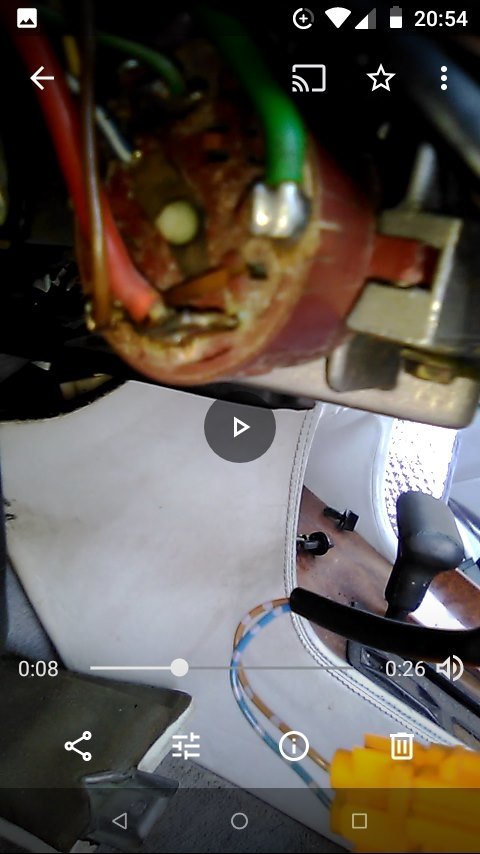

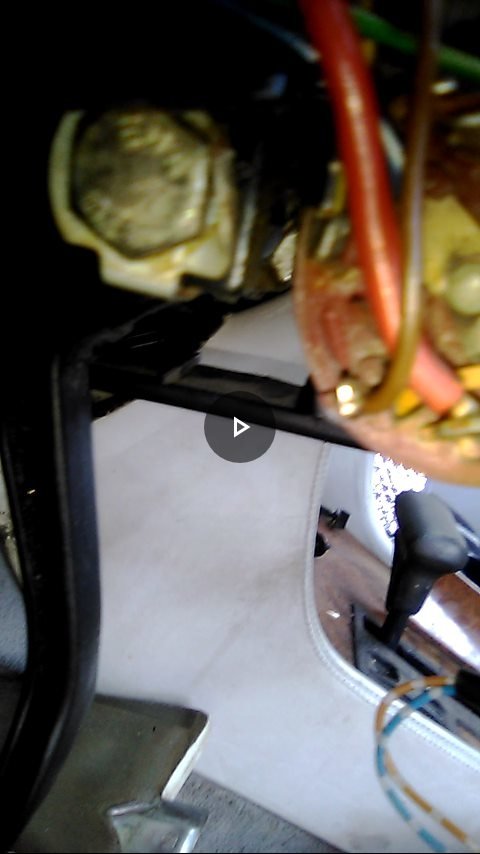

Hi, i tried to remove the ignition switch but it wont budge with the flat screw driver. I only saw a clip on one side only and i don't know what to do next. Here is a pic of the ignition switch:
Oct 14, 2020 at 12:01 PM
  • 110,248 POSTS
Do you see a color match for the wire at the coil?
Oct 14, 2020 at 12:07 PM
PALOSBB40
  • 53 POSTS
i don't understand, do you mean the same color wire for the positive on the ignition coil?
Oct 14, 2020 at 12:09 PM
  • 110,248 POSTS
Yes. The wiring schematic I have shows power from the switch direct to the coil.
Oct 14, 2020 at 12:14 PM
PALOSBB40
  • 53 POSTS
Okay, i just checked and both wires to the ignition coil are black for negative and positive.
Oct 14, 2020 at 12:19 PM
  • 110,248 POSTS
Because of the model year, my schematics are very basic and limited. What to do is see if there is a black on on the ignition. Using a test light, see if there is power when the key is turned on and no power when the key is off.

Hi, i didn't have access to the ignition switch properly, because i couldn't remove the top cover to the steering column, because my steering wheel will no longer tilt down because of damage caused by the tow the truck. i will get back to you when i get this resolved.
Oct 15, 2020 at 11:17 AM
PALOSBB40
  • 53 POSTS
Hi, i'm ready to start working on cranking and no spark. What's the next step for me to look for breaks on no power to ignition coil?
Oct 23, 2020 at 9:13 AM
  • 110,248 POSTS
Have you checked the wire between the two (switch and coil) for continuity? Is there power at the switch?
Oct 23, 2020 at 2:40 PM
PALOSBB40
  • 53 POSTS
Hi, there continuity on the ignition switch, but there no continuity on the wire between my new coil and ignition switch.
Oct 24, 2020 at 1:59 AM
  • 110,248 POSTS
Then there is a break in the wire. If you run power to the coil, will it run? If it does, the wire must have a break in it.

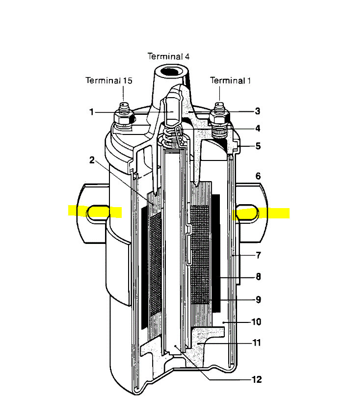

At this point, I recommend having the coil checked. If you ran power to it, the vehicle should have gotten spark and started. I am going to ask the site owner to look through this thread to see if he can add anything.
I attached a pic below and highlighted where the two retaining bolts are located. Most parts stores can check this for you. Just disconnect the battery before removal.
Take care and let me know what you find.
