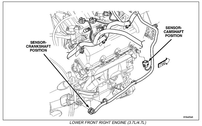

Hey everyone,
I recently purchased the vehicle listed above (Limited model). The engine is a gas engine for reference. I'll keep this short:
Vehicle has had fuel pump, and starter replaced and the battery is new.
When i go to start the vehicle after it has sat for more than 30 minutes or so, it will start up no problem. The idle on the vehicle is steady at 600 RPMs when i start it, after it's been down the highway, etc. Once i've driven it for any short or long period of time and i turn the vehicle off, i will need to wait for at least 30 minutes to turn it back on.
If I do not wait, it will crank with no issues, no lights dimming, etc. but it will not start.
To further this, I pulled my dipstick and it smells strong of gasoline indicating a lean run. Removal of the sparks (NGK) further indicates a lean run.
The only other item I can mention is that the alternator is beginning to whine (ordered part to replace) but doubt this to be the issue.
Anyone have any idea of what this can be? In a week I have the following parts coming to see if they fix the issue:
Spark plugs
Coils
Alternator
Camshaft sensor
Crankshaft sensor
PCV valve
Air filter (because why not)
Thanks everyone and I will keep you all updated on what I find as I've spent days now looking through threads with so many almost identical issues but no resolves other than fuel pump.. which I've replaced.

You're going about this the wrong way. Replacing random parts is by far the most expensive and least effective way to diagnose a problem. It would be much less expensive to have a mechanic do that for you. Instead, you have me, and together we should be able to solve this.
The place to start is by reading and recording the diagnostic fault codes. Chrysler made doing that much easier than any other manufacturer. Cycle the ignition switch from "off" to "run" three times within five seconds without cranking the engine. Leave it in "run", then watch the code numbers show up in the odometer display.
This doesn't work on newer models. If it doesn't work on yours, you'll need a scanner or an inexpensive code reader. You can go here:
https://www.2carpros.com/trouble_codes/obd2/p0100
to see the definitions, or I can interpret them for you.
The next problem is the relevant fault codes often do not set from just cranking the engine. Specifically I'm referring to codes for the crankshaft position sensor and the camshaft position sensor. Missing or lost signals from them need a little time to be detected, as in when a stalled engine is coasting to a stop. For that reason, don't assume a sensor is okay just because it hasn't set a fault code.
Additionally, one of the more common ways for these two sensors to fail is by becoming heat-sensitive. They'll work fine as long as natural air flow over the engine keeps them cool, but when a hot engine is stopped, heat migrates up to them, causing the temporary failure. They'll commonly work again after cooling down for about an hour. As this problem progresses, the sensor may fail while you're driving, especially in warm weather.
Let me know what you find with the fault codes.

Not running hot. It's normal under-hood heat from the engine that heats up all of its sensors, but it's just the cam and crank sensors that become heat-sensitive. We used to run into this all the time in tvs and vcrs. All we could do was cover them up with rags and a lamp, then wait for the intermittent problem to occur. Once something started to act up, we used a spray can of "Freeze Mist" to cool down very specific parts, one at a time, until the problem changed or cleared up. Unfortunately that doesn't always work on cars, especially when you have to drive it until the problem occurs, then run alongside it with the hood open, chasing it with that can of Freeze Mist".
Some sensors, like the older throttle position sensors, are strictly mechanical sensors that aren't affected by temperature. Some are magnetic with a coil of wire wrapped around a magnet. Older cam and crank sensors used to be of this design. They could be identified by having just two wires in their electrical connectors. Those could fail too from under-hood heat, but is was much less common. The very thin wire would expand and contract repeatedly with each engine warm-up cycle, which eventually led to a wire breaking off its terminal. Often those would work again as the wire and terminal cooled down, and that wire would just barely touch the terminal. Here again, natural air flow while driving usually kept them cool. It wasn't until the hot engine was stopped that the lack of air flow caused the heat-related problem to show up.
Cam and crank sensors with three wires are those that have delicate electronic circuitry inside them. Heat is always the deadly enemy of electronic components. Mass air flow sensors, used by every manufacturer except Chrysler, and MAP sensors, both have a lot of circuitry inside them, but they are both near constant air flow, so heat-related failures are less common. Even the heat from a hot, stopped engine rarely affects them because of where they're located away from the areas of high heat.
When you don't have any related diagnostic fault codes to indicate which circuit needs further diagnosis, you have to use a scanner to view the live data the computer is seeing. I have a Chrysler DRB3 for all of my older vehicles. It lists the crankshaft position sensor and the camshaft position sensor with a "No" or "Present". As soon as you start cranking the engine, they should immediately switch from "No" to "Present". When one of them remains on "No", that is the circuit that is not developing its signal. When either signal is missing, the Engine Computer will not turn on the automatic shutdown, (ASD) relay. That relay powers the injectors, ignition coils, alternator field, oxygen sensor heaters, and fuel pump or pump relay. All manufacturers use some variation of this system. If a fuel line gets ruptured in a crash, there would be a serious fire hazard from the raw gas being dumped on the ground. Instead, there can't be any fuel pressure in a broken fuel line. With no fuel pressure, the engine can't run. Once it stalls, there's no signal pulses from the cam and crank sensors. That tells the computer to turn the ASD relay off, thereby stopping the fuel pump.
