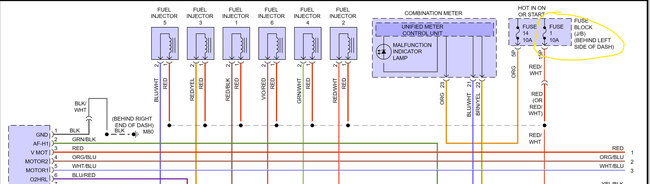

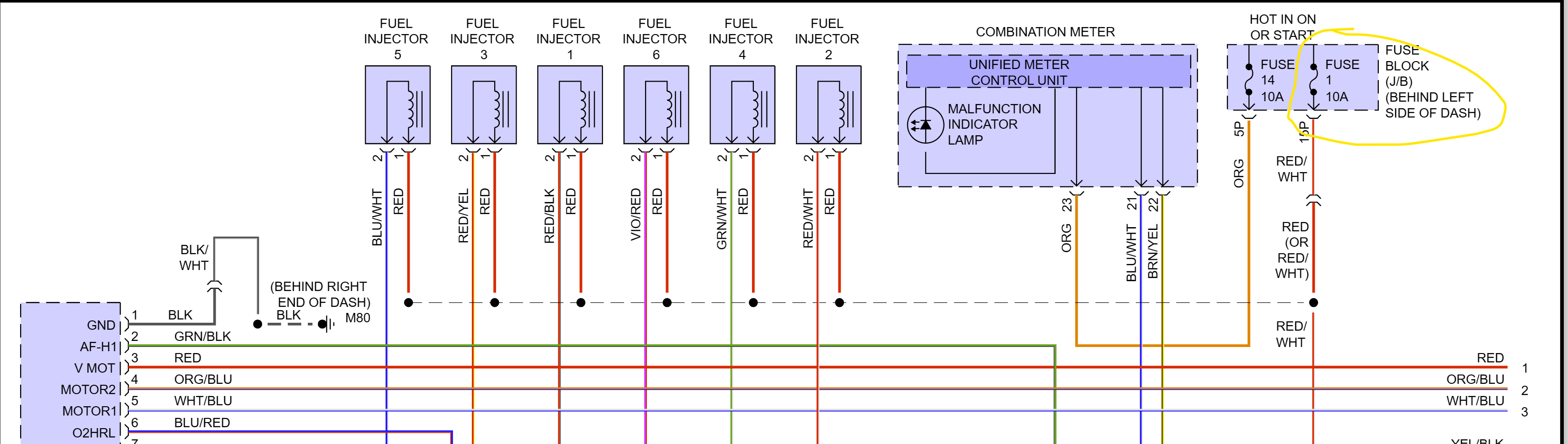

Also, I would check every fuse first. There is a 10 amp in the fuse box behind left side of dash my information says, I am assuming they mean the side. This is the power supply to the fuel injectors. See if this fuse is good or not.

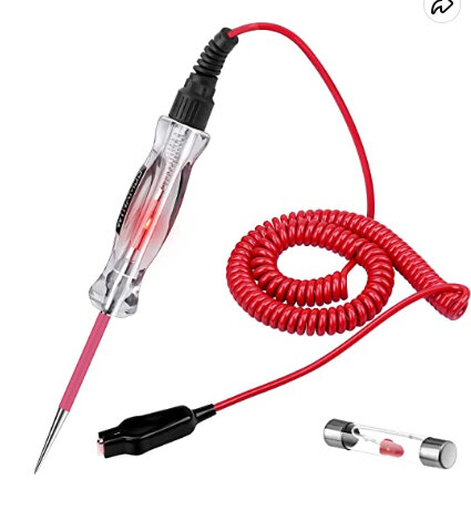

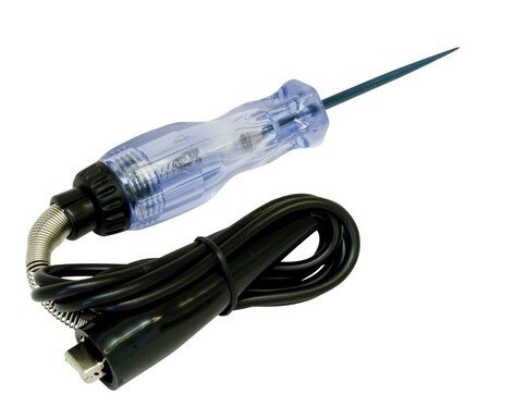

The best way to test fuses is by using a test light. This article will show you how to do that:
From here I would check every fuse and see what has power and what doesn't.

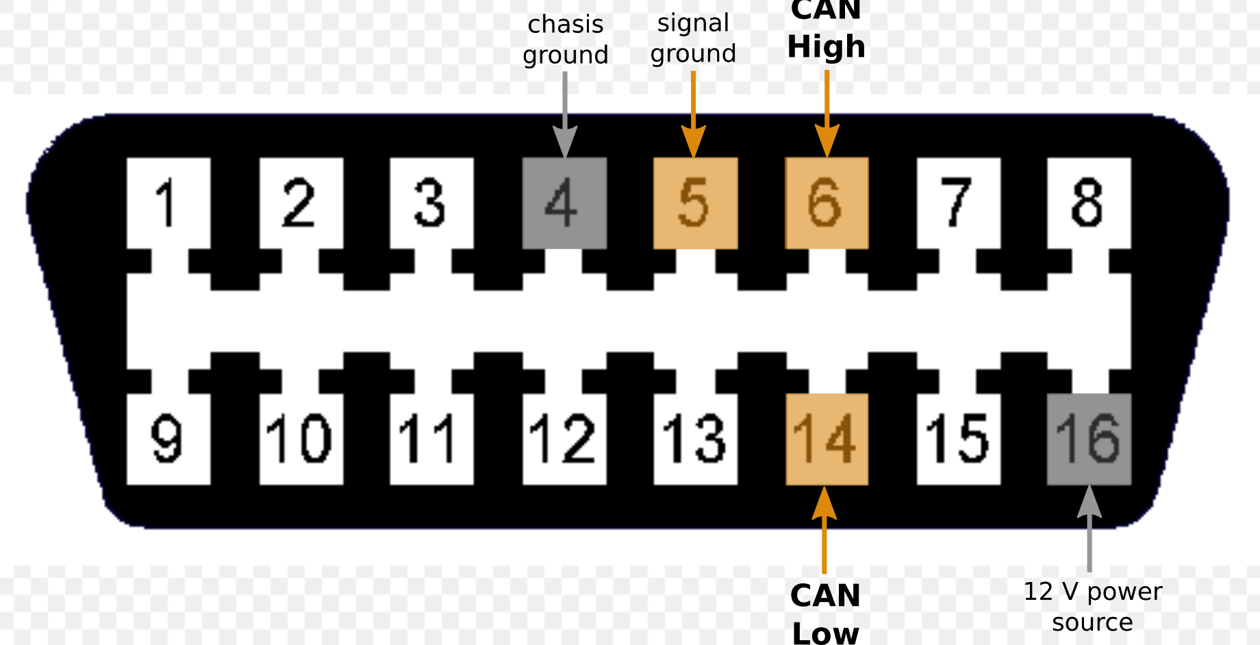

If you have a scan tool, plug it into the OBD II port and see if it powers on and communicates with the PCM or you can take a test light and go from pin 16 on the same connector, bottom row last one on the left. I included a pic for you. Take the other end and touch it to a known good ground.

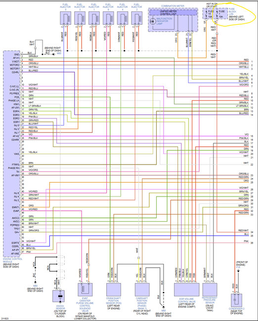

There are 2 wires to each injector. One is that power wire going through the 10 amp fuse I spoke about and is red. The other goes directly to the PCM. I would unplug each injector one at a time and touch the terminal for the RED wire only and clip other end to the battery so we can see if we are getting power at each injector. I have added a wiring diagram for you.
I don't think it's your injectors, I just want to make sure the harness is supplying power to each injector.
Be careful with the test light because it doesn't have any protection in it to prevent you from burning something out.

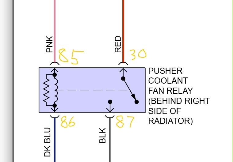

I have added a diagram for you for a relay, it's just a random relay. On your fuel pump relay, it should have a wiring diagram showing which is pin 30. If you connect you test light with the relay removed to that terminal on the relay/fuse box, do you have power at that terminal?
