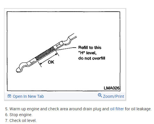

The car cranks but doesn't start. history: the car hasn't been driven for six months at that time it ran rough but ran. It does throw out a p301 code and a code for fuel level sensor or something like that. 1/8 tank of gas in it. it just sat for six months through a very hot Las Vegas summer. when I checked the oil, it comes almost halfway up the dipstick. I'm not sure if that's normal for a car that has just been sitting. if it's not then it's way too high like to know that too. I'm no mechanic but do have general knowledge I can turn a wrench read a multimeter etc., follow instructions what's my best starting point to get this car started.

As for the oil, it should not be halfway up the dipstick. Keep in mind that you do not want to start the engine will excess oil as it can do some damage. The oil should be at the top of the hash mark at the bottom of the dipstick (look below).

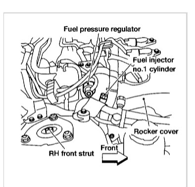

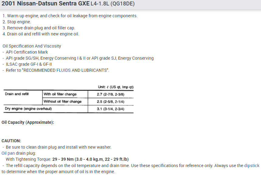

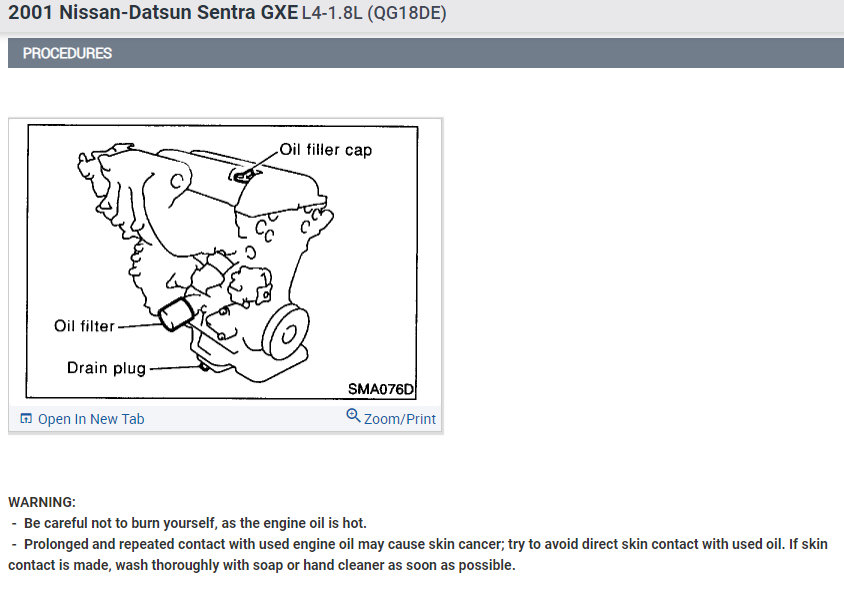

Tuesday morning I've just gotten back to the Sentra I got so far as draining the oil and it smells like gasoline. I know this isn't good but how bad is it?
Nov 9, 2021 at 2:37 AM
SQM
  • 6,383 POSTS
It is possible that the injector seal had failed and got fuel in the engine. That might be why the oil level was so high.
Keep in mind that just because there is fuel in the oil does not mean it will need major repair. It all depends on the where the leak is coming from.
Best step would be to do the oil change as usual. Check for any fuel leak from the injector area.

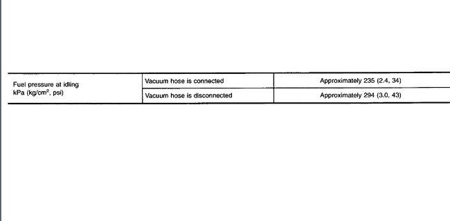

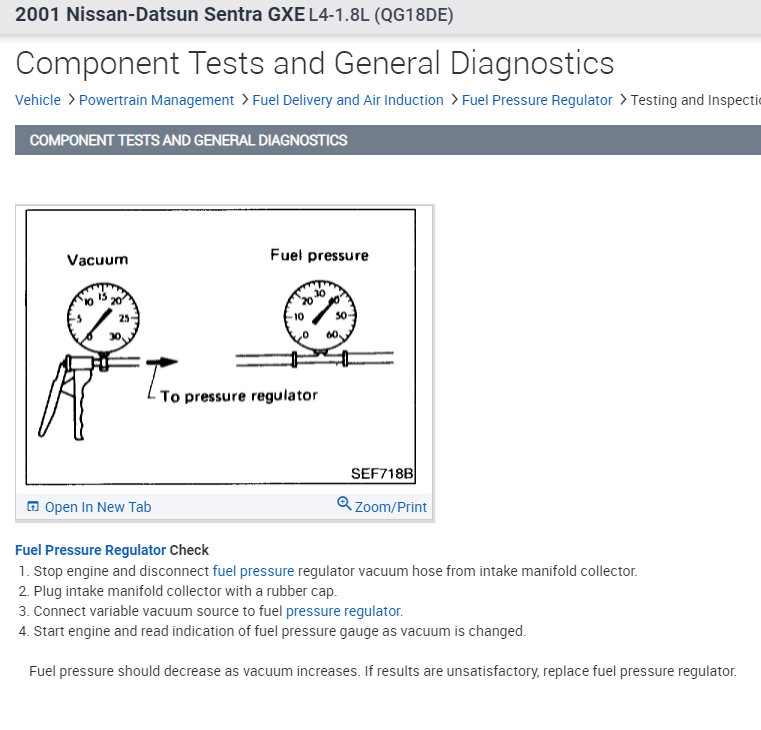

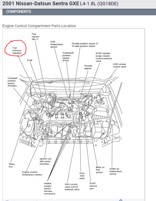

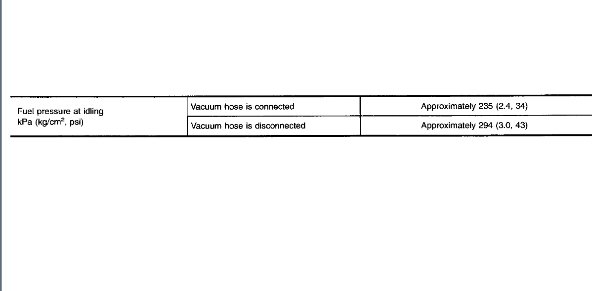

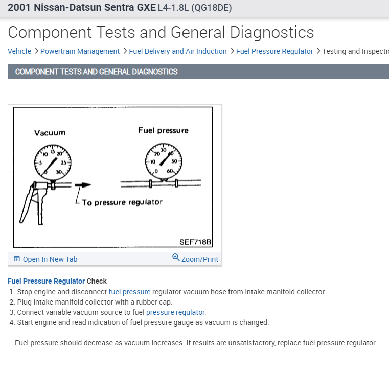

Thank you so much and for continuing. do you think that a bad at fuel pressure regulator on this car could cause that problem? and if so, how would I test that the fuel pump is good?
Nov 9, 2021 at 4:41 AM
SQM
  • 6,383 POSTS
Bad fuel pressure regulator can either not allow enough fuel or too much fuel into the engine.
When you turn the key to the on position, do you hear the fuel pump come on?
Check out this guide on how to test the regulator:

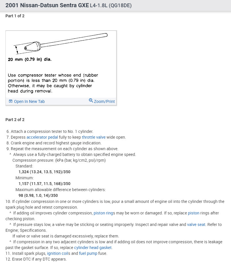

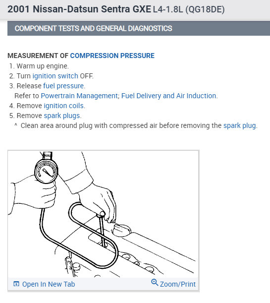

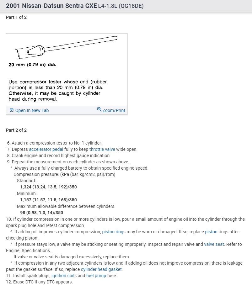

You still with me SQM? I took a break from that Nissan. I'll be back at it Tuesday I did get the oil changed to where it should be. The spark plugs were completely fouled. I put four new ones in and that's when I left. on Tuesday I'm going to check and see if it's getting spark and fuel and if it's not gone from there. I have a question: Everything I've read says check the compression with the engine warmed up. If you got no start, can you check it without starting it first or would I be wasting my time?
Nov 13, 2021 at 7:36 AM

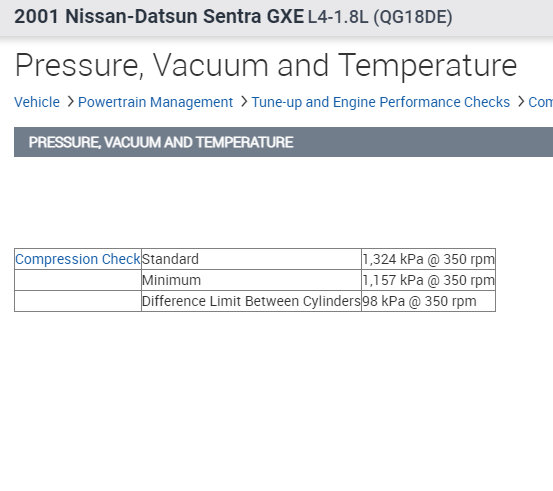

SQM
  • 6,383 POSTS
Hello again,
It is ideal to check the compression when the engine is warm.
However even with a cold engine you can still check the compression to get an idea if that could be the issue. You might get a little lower but still should provide good information.
This engine compression should be between 167 PSI to 192 PSI. With the maximum variance between the lowest and highest cylinder should be less than 15 PSI.
So, if the compressions are 170, 175, 180, 178; then that variance is 180-170 = 10 PSI.
Here is a helpful guide on compression test:
