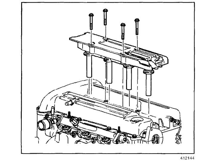

Have the car listed above Ecotec. It threw a P0300 code a week ago. It shook bad when stopped, ran fine down the road. If put in neutral it would be a little better. If you put on the A/C it would shut off. The next day it wouldn't start. It would crank but not start. Plugs are about four months old. Just replaced O2 sensor two weeks ago. 1.) Replaced coil pack( plugs are getting spark) 2.) Replaced ignition control module on coil pack 3.) Had starter tested( it's good) 4.) Replaced crankshaft position sensor (don't think it's getting power, when I crank engine, tachometer doesn't move) 5.)Fuel rail is getting fuel (I sprayed starting fluid in throttle body and didn't even try to start) 6.)Fuel pump is pumping 7.) New idle air control valve 8.) New throttle position sensor 9.) Kinda sounded like timing chain, so checked that and it's still on and okay 10.) Checked all fuses and relays 11.) No security light on, still tried to reset security just in case Looked for loose wires and electrical connections. Still won't start, doesn't even try. Could it be the ignition switch, alternator? Any help would be much appreciated, it's my work car and can't afford another one right now. Thank you

Good evening,
In these cases, I replace the coils, cap, wire ends, and module.
The cap is what causes the failures of the coils and the module. It was a lousy design for the ignition system.

  • 52,797 POSTS
What about the cap? It carbon tracks like the old distributor caps.
Wednesday, April 3rd, 2019 AT 4:24 PM
ZOMBIE850
  • 11 POSTS
I don't believe it has a cap. (Distributor cap?) The picture you posted with the coil pack, I replaced that whole thing but there aren't any coil wires. Just the wire harness going into the ignition coil on top. I really appreciate your help. I'm at a complete loss.
Wednesday, April 3rd, 2019 AT 4:53 PM
  • 52,797 POSTS
There is a cap that the coils bolt into. The piece that has the four bolts and is the length of the valve cover is the cap.
Wednesday, April 3rd, 2019 AT 5:04 PM
ZOMBIE850
  • 11 POSTS
Okay, yeah, I thought that was the coil pack. Sorry, yes that has been replaced twice as well as the ignition control (the silver part on the top end of the cap).

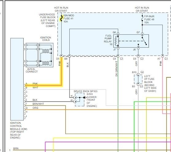

  • 52,797 POSTS
Okay, check the wire in the diagram for power with the key on.

  • 11 POSTS
Thank you Roy, I'll have to try it tomorrow, I'll let you know if it has power.
When I checked the other day each of spark plugs would spark when I turned it over, I put it all back together and sprayed starting fluid in the throttle body and not even a hint of it firing, just cranks. When I crank it over I noticed the tachometer isn't moving which leads me to believe that there isn't power going to the crankshaft position sensor. I followed all the wires and they look okay. That's why I'm possibly thinking the ignition switch isn't providing power to the ignition but it is to the starter. But just a theory. But if that wire you said to check isn't getting power, the ignition switch may be the issue.

  • 11 POSTS
I tested the pink wire with the ignition "on" and read 12.3 volts. I wasn't able to rent a fuel pressure gauge or compression test kit yet. I'll probably do that on Sunday.
