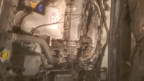

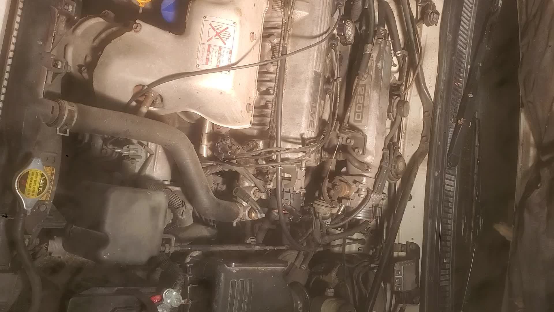

Car shut off and stopped running after I started it one morning. I was letting it warmed up before work in the winter. When I was ready I got in and tapped the accelerator with my foot and it immediately shut off. Tried jumping it and that didn't work. Couldn't hear the fuel pump running at all so I replaced that but that didn't fix it. Replaced the spark plugs now and it still won't run. Not sure what to do next besides replacing the distributor cap and rotor. Looking for some help.

I forgot to mention this but the reason I am going through the electrical part of the ignition system is because there was no spark at the plugs. I should also mention that there was no check engine light before or when it shut off.

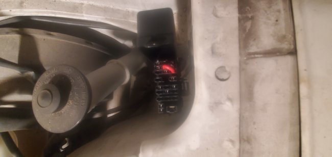

I just attempted to check my codes and when I turned the ignition to on the check engine light just continuously blinked with no pauses . I'm not sure what that means of if I am doing something incorrectly. Do you know?
Feb 15, 2021 at 2:14 AM
  • 110,240 POSTS
That's an odd one. If you followed the link, it should provide codes. Are you certain you are getting the correct pins in the connector?

Joe,
I double checked the pins for the diagnostic port and as far as I can tell the pins I'm using are correct. I included a photo of the pins I'm using just to be safe. I also checked if the rotor was spinning and It was indeed spinning. I also included a video of the engine cranking. In the video the distributor cap is off and you can see the rotor spinning. If there's anything else you need let me know.
Feb 15, 2021 at 10:29 AM
  • 110,240 POSTS

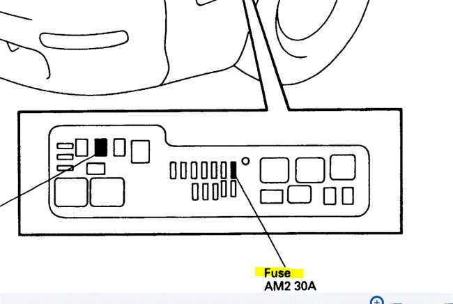

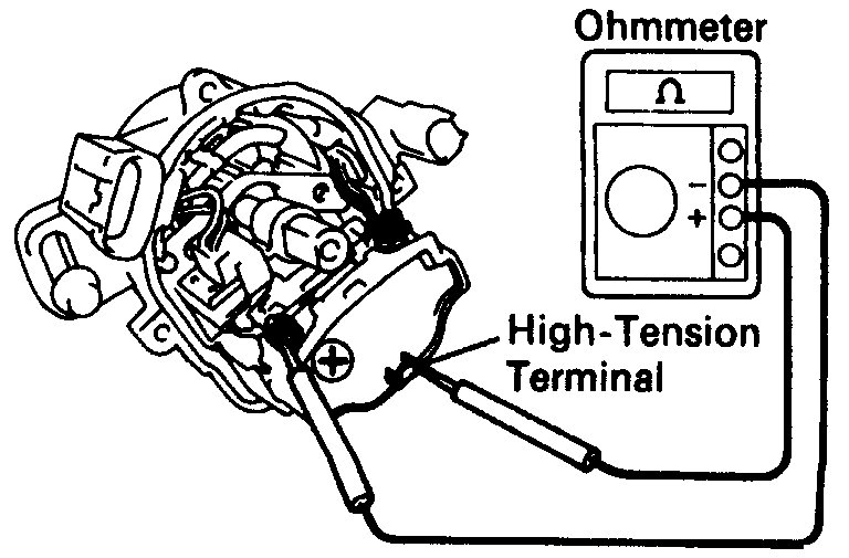

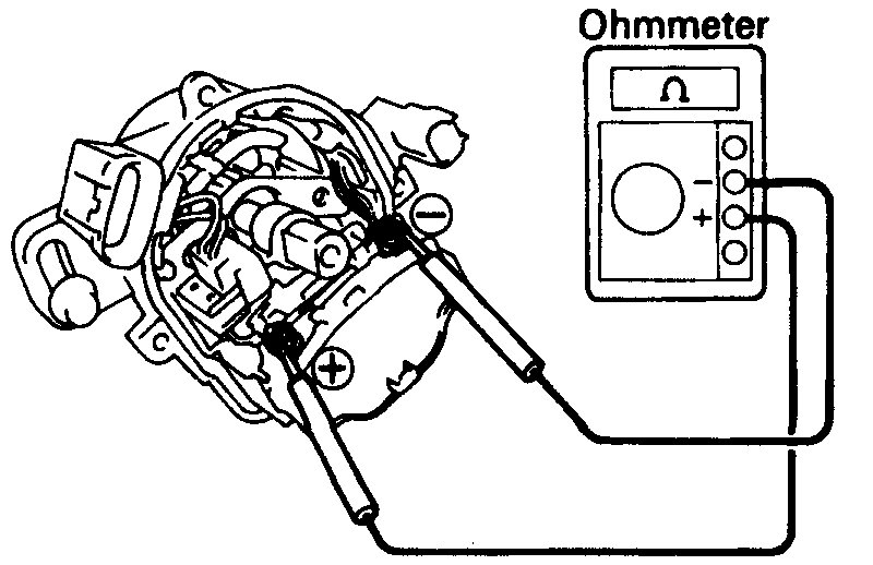

It looks correct. We need to do a few more checks. Let's start with the ignition coil. Here are the directions. The pics correlate with the directions.

5. Inspect primary coil resistance.
-Using an ohmmeter, measure the resistance between the positive (+) and negative (-) terminals.
Primary Coil resistance:
Cold: 0.36 - 0.65 Ohms
Hot: 0.45 - 0.65 Ohms
^ If the resistance is not as specified, replace the ignition coil.
6. Inspect secondary coil resistance.
-Using an ohmmeter, measure the resistance between positive (+) and high-tension terminals.
Secondary coil resistance:
Cold: 9.0 - 15.4 k Ohms
Hot: 11.4 - 18.1 k Ohms
^ If the resistance is not as specified. replace the ignition coil.

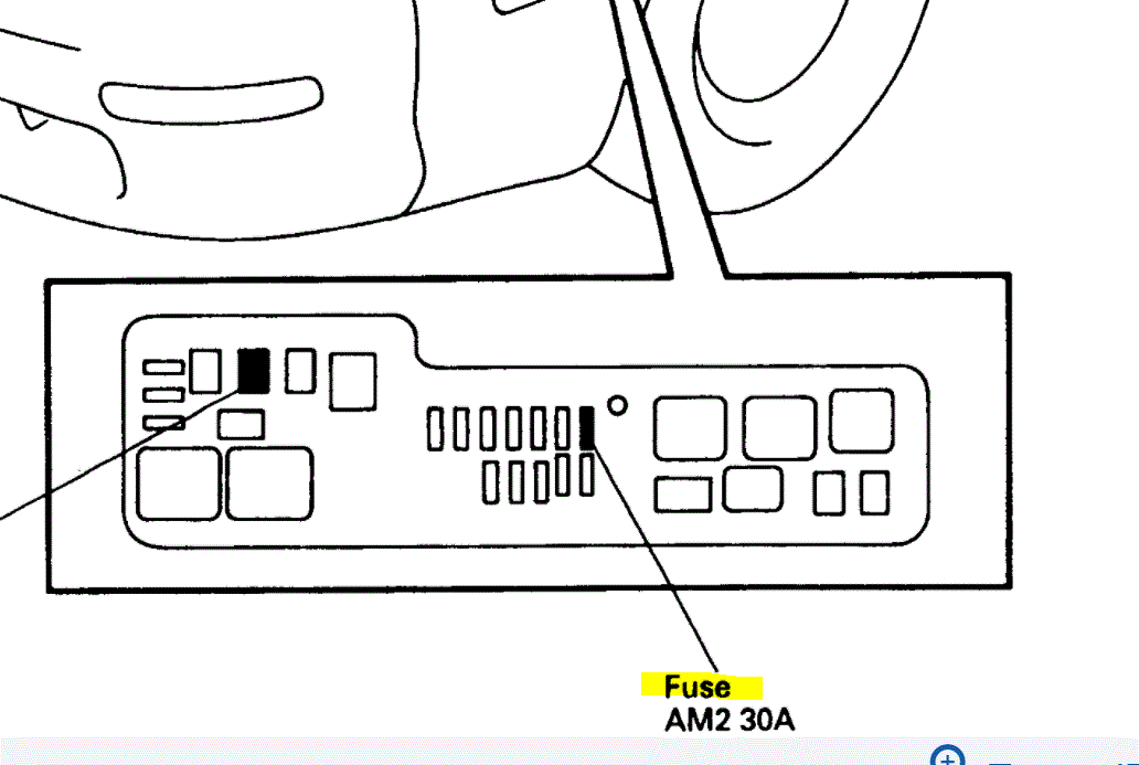

Note: I provided info for a vehicle having Federal Emissions. If you are in CA, I need to know.
If you are in CA, check the fuse indicated in pic 3.

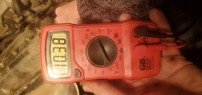

Joe,

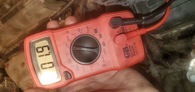

I just preformed the checks and these were my findings:
Primary coil resistance: 1.9.
Secondary coil resistance: 10.38k.
Both checks were performed in cold weather. To be clear does this mean that I need to replace the ignition coil?

  • 110,240 POSTS
It sounds like the primary circuit is bad. This sounds like the problem.

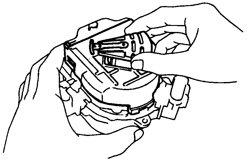

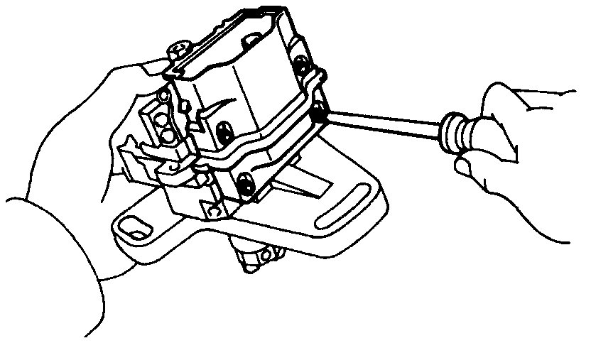

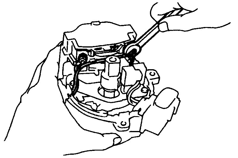

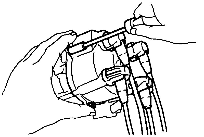

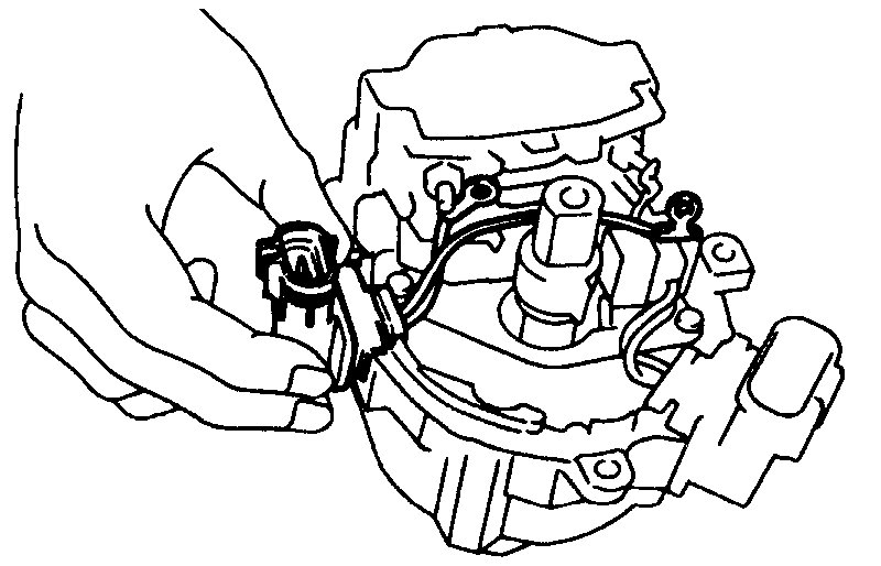

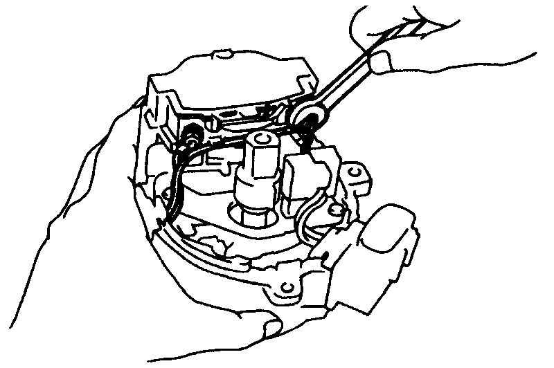

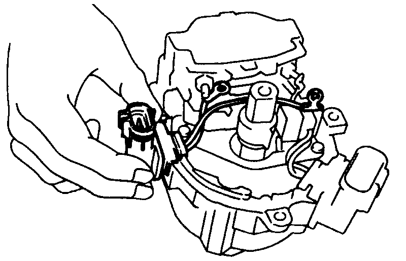

I don't know if you need them but here are the directions for removal and replacement. The pics attached correlate with them
DISTRIBUTOR DISASSEMBLY
1. Remove distributor cap.
pic 1
-Remove the 3 bolts and distributor cap.
pic 2
2. Remove rotor
3. Remove ignition coil dust cover.
a. Remove the dust cover.
b. Remove the packing.
4. Remove distributor wire.
pic 3
a. Remove the 2 nuts, and disconnect the 3 wires from the ignition coil terminals.
pic 4
b. Remove the distributor wire from the distributor housing.
5. Remove ignition coil
pic 5
Remove the 4 screws and ignition coil.
