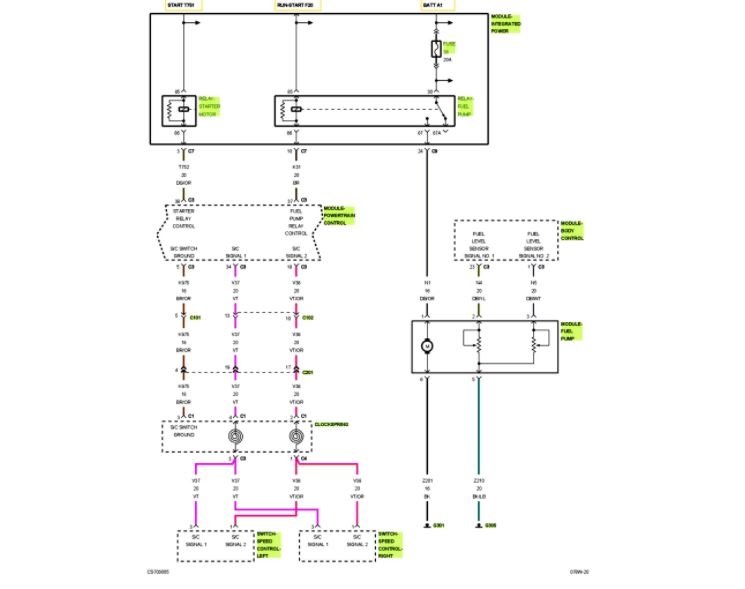

Touring model. The first signs of trouble was a erratic gas gauge. I checked the fuses and relays. I have since replaced the battery both the camshaft and crankshaft sensors. The car cranks but will not start. I replaced both the primary and secondary fuel pumps and still it will not start. The scan tool I have is not reading any codes. I also checked the ground wire from the battery to the transmission it was okay. I almost forgot it is getting spark and acts like it wants to run when using starting fluid.

Have you checked the actual voltage to the fuel pumps?? I will get a diagram??

Okay, diagram attached. check the listed fuse for power on both sides.

Sorry it has taken me so long to respond but found the problem. The auto shut down fuse must of blown after changing the fuel pumps and reconnecting the battery. Thank You for your help
