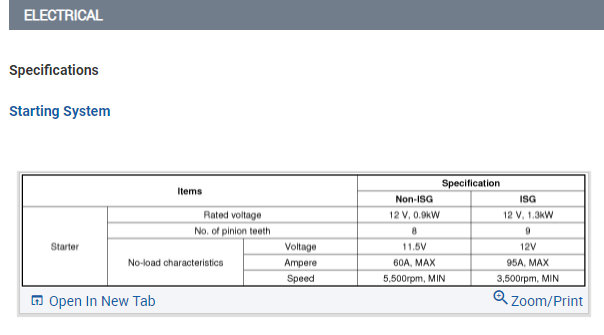

Even though the lights come on, the battery may not have enough power to start the engine.
You should first get the battery tested, in case this is bad.
https://www.2carpros.com/articles/symptoms-of-a-bad-car-battery

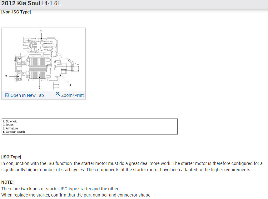

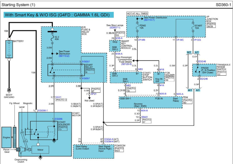

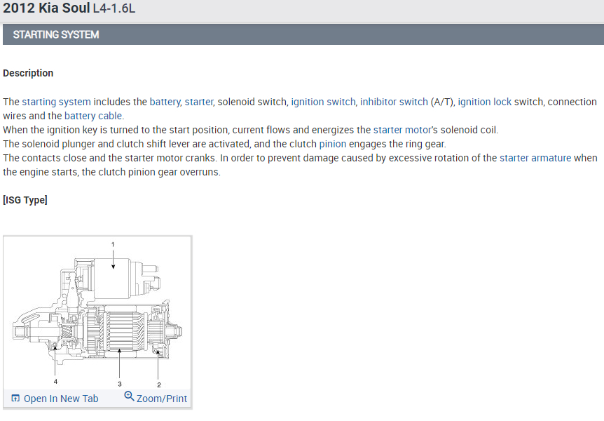

The second item needs to be checked is the starter. As when you do a rolling start you bypass the starter to start the car.
https://www.2carpros.com/articles/how-a-starter-and-solenoid-works
