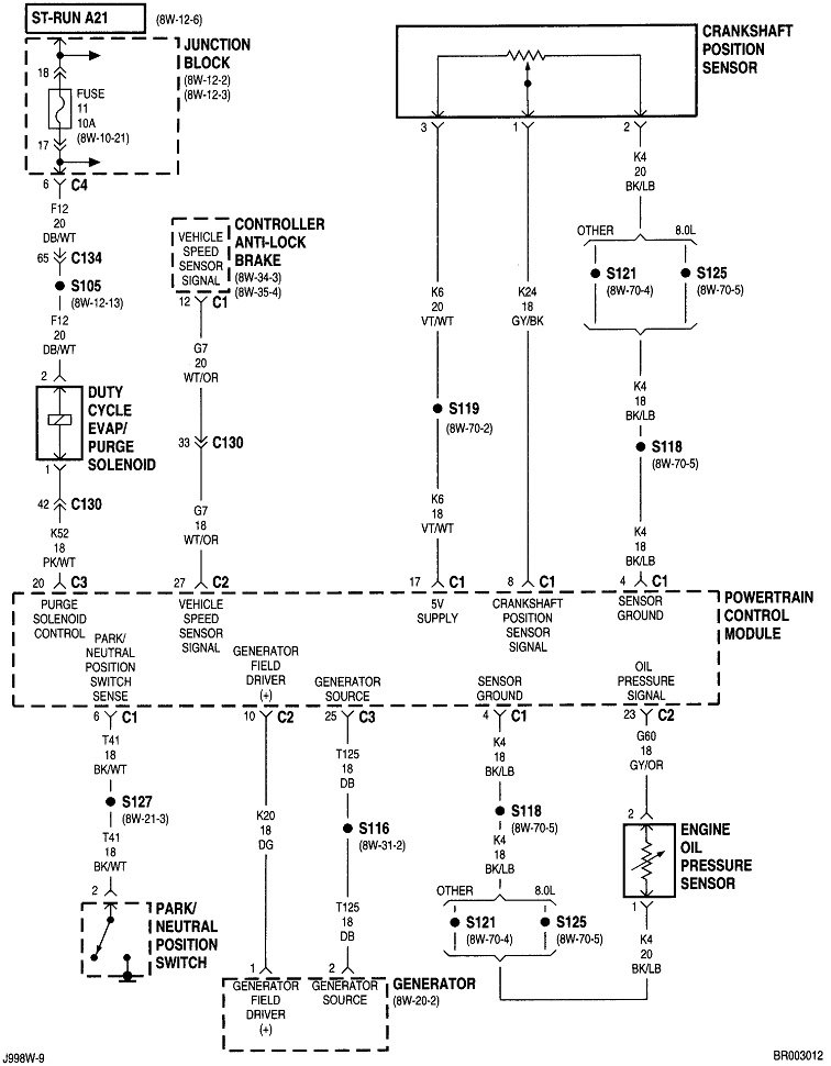

After getting gas I was returning home. The truck lost power and shut off. I pulled over and tried to start the engine, crank but no start. I held the pedal to the floor and turned it over. I could smell gas. After about 5 minutes I tried again. This time it started.
Continued on home. After about a mile the truck shut off again. I repeated the previous start attempt but after 30 minutes finally had to have it towed.
I'm thinking it's either the coil or a crank position sensor. Please give me some direction.

First we need to read the diagnostic fault codes. Chrysler made doing that yourself much easier than any other manufacturer. Cycle the ignition switch from "off" to "run" three times within five seconds without cranking the engine. Leave it in "run", then watch the code numbers appear in the odometer display. You can go here:
https://www.2carpros.com/trouble_codes/obd2/p0200
to see the definitions, or I can interpret them for you. Be aware diagnostic fault codes never ever say to replace a part or that one is defective. They only indicate the circuit or system that needs further diagnosis. When a sensor or other part is referenced in a fault code, that part is actually the cause of that code about half of the time. First, we have to rule out wiring and connector terminal problems, and mechanical problems associated with that part.

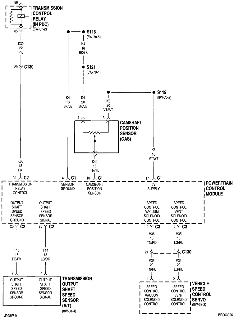

If we're lucky, you'll find a fault code related to the crankshaft position sensor or camshaft position sensor, but lack of those codes is not conclusive. Defects with those circuits need some time to be detected. Simply cranking a dead engine in particular usually won't set a code. They're more likely to be detected when a stalled engine is coasting to a stop. To add to the confusion, the Check Engine light should not be on if you do get the engine restarted. That light only turns on for about half of the 2000 plus fault codes; the ones related to something that could adversely affect emissions. An engine that won't run can't pollute, so a failure to run caused by a cam or crank sensor won't turn the Check Engine light on.

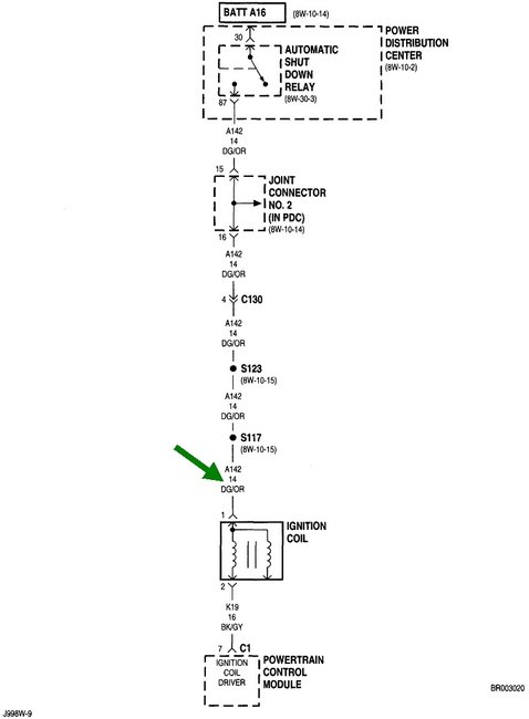

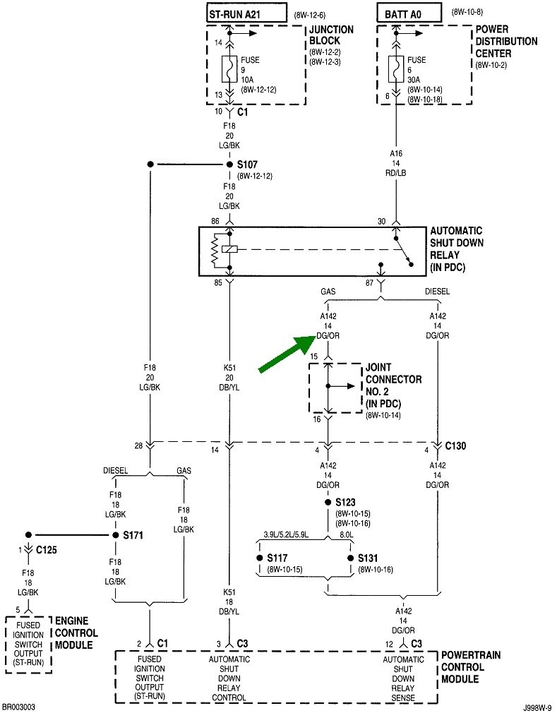

If you find a fault code related to either of these sensors, let me know, otherwise the next step is to see if the automatic shutdown, (ASD) relay is turning on. It will turn on for one second when you turn the ignition switch to "run", then it will turn off. You may be able to hear the hum of the fuel pump for that one second. Next, the relay gets turned back on during engine rotation, (cranking or running). The Engine Computer does that when it sees signal pulses from the two sensors.
About 95 percent of crank / no-starts are caused by a loss of fuel and spark at the same time due to one of those missing sensor signals. Perhaps three percent of those no-starts are caused by a failed fuel pump, but Chrysler pumps rarely stop working while you're driving. When they fail, they almost always fail to start up.
Only about two percent of no-starts are caused by a failure in the ignition system. That's when you would smell unburned gas at the tail pipe.

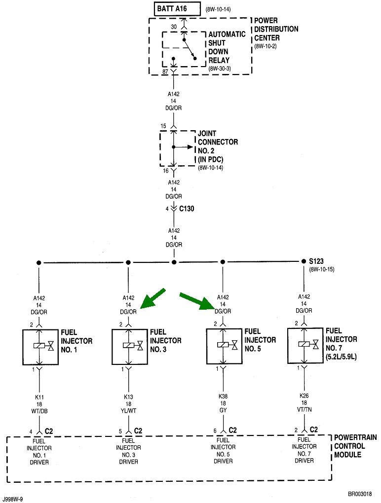

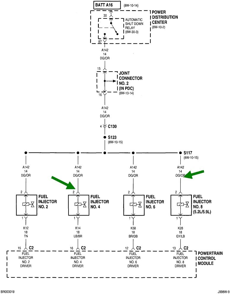

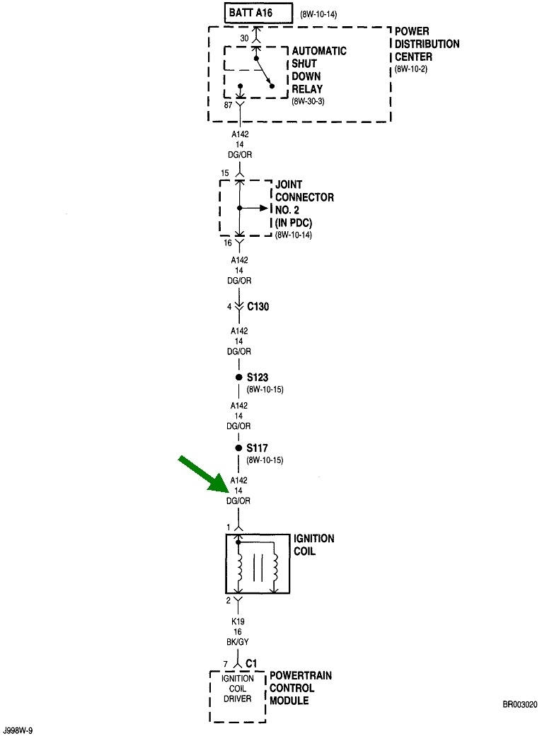

The easiest way to check if the ASD relay is being turned on is to use an inexpensive test light to check the dark green / orange wire at any ignition coil, any injector, or even the two smaller terminals on the back of the alternator. Digital voltmeters usually don't respond fast enough. You should see the test light turn on full brightness for one second, turn off, then turn back on when you start cranking the engine. If it does turn on for that first one second, it proves the ASD circuit is okay and the Engine Computer has control of it. If it doesn't turn back on during cranking, we have to look at the two sensors.

I checked for fuel by spraying starter fluid in the intake. It was getting gas. Then I checked the coil, it was giving a spark but looked weak. Then I replaced the crankshaft position censor still no start. Finally, I replaced the coil. She started and ran great.
A side note, I've always had a problem with the AC cutting off when pulling a hill. I've checked for vacuum leaks with no success. Replacing the coil fixed the A/C problem.
Thanks for your suggestions.
