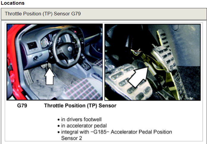

Hi Ken,
Thanks for your reply reply, just to confirm, the the TP sensor sits in the pedal itself? Or is it the plug(wiring) that plugs into pedal?

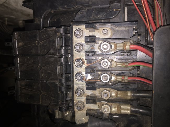

I have taken a picture of the battery last night I noticed that on the battery where all the connections are, there is about three of the plates that no more makes contact but looks like the previous owner just connected it with a copper wire. Any idea what these are for? As in what is connected to it?
See picture attached.

Oh man, yes you should not have them like that because it is a fire hazard. It looks like the second one from the top is broken? I would replace these with new and see what happens from there.

Is it hey? Well then it has to be done fast.
I actually phoned Goldwagen and battery Centre to try and get the metal plate where I turn the 10mm bolts onto. Apparently they are so scarce and I should make my own using copper. I have made them all make contact with each other with the copper wire. But as you say, I should try to get that plate first.

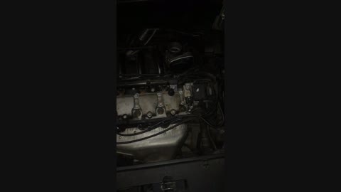

Left the battery terminals on overnight and during today and tried to start and nothing. Only swing. A very strong swing so battery is good I would think. There are so many things that it could be but no one is sure. It is frustrating spending money on something you did not need to replace. But I am taking it in to an auto electrician this weekend and I am praying for the best. I will post the video of the idling tomorrow after I have left the terminals off overnight.

Morning Ken, see attached video. This time around it sounds a bit weirder than before. Let me know what you think? Thank you.
Wednesday, February 21st, 2018 AT 8:55 PM
KEN L
  • MASTER CERTIFIED MECHANIC
  • 49,182 POSTS
Looks like you are not getting fuel into the engine. Lets do a fuel pressure test to see what you have.
You can also crack a fuel line loose at the engine and then turn the key on and it should spray from the loose fitting.
Can you spray carburetor cleaner in the throttle bore will the engine run?
Thanks for the video really helps.

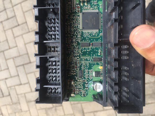

KIDROS
  • 14 POSTS
Howzit Ken, thanks for your response once again.

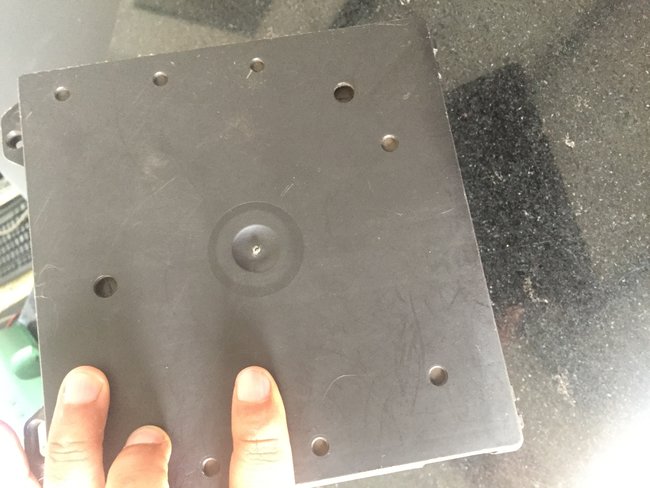

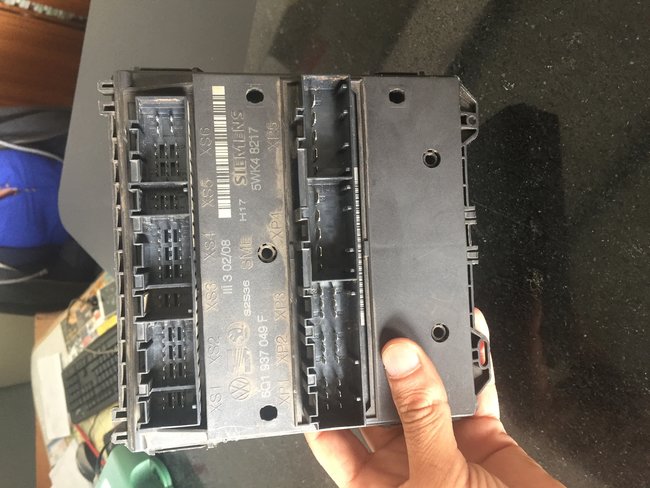

So I took the car to an auto electrician to see what they say and take it from there.
Apparently my comfort control module has blown? Says water went into it and that’s the reason the car is not starting or doing whatever it’s doing? No idea how water went in there?
I have attached a picture of what this unit look like. Please reply with your thoughts.
Thanks,
Keith
Friday, February 23rd, 2018 AT 7:56 PM
KEN L
  • 49,182 POSTS
Water in the module will definitely cause the issue. So they replaced it and now the car runs? I would make sure water can get to the new module do you live in rainy weather? Make sure the car is sealed up tight.
Saturday, February 24th, 2018 AT 10:58 AM
KIDROS
  • 14 POSTS
Thanks Ken,
So I bought the part and he fitted it and that seems to have sorted the starting problem I think. No idea how water could have got in there though. That sits under the steering wheel? He has mentioned that the erratic idle is still there and took out spark plug number 2 and says it seems wet. Also the exhaust is blowing like water. No idea what that means. But I’m waiting for a call today and hopefully be told that it’s sorted and ready. Thanks for all your help this far. I will let you know outcome.

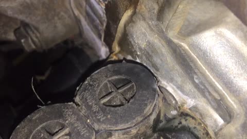

So remember the problem it initially had before going there? (No starting, erratic idle, switching off. Also accelerator pedal didn’t respond). Changed the blown control module and that sorted out starting and idling problem. It now has no power, when I drive in low revs it hesitates very much unless I rev a bit harder. On higher revs and faster speeds it still doesn’t feel normal but the car moves ok. I changed plug leads last night, took it for a test and still hesitates a lot at take off?
Furthermore, I noticed a water leak coming from something that Sits just behind the thingy that the plug leads come out of? I don’t know if that’s the coil? But the leaking thing is behind what I think is the coil. (Video attached) please tell me what this is called and how the leak can Be fixed?

I will be glad to help you but because this is a different issue we must start a new thread.
Please copy and post your question here and re-upload the video please.
