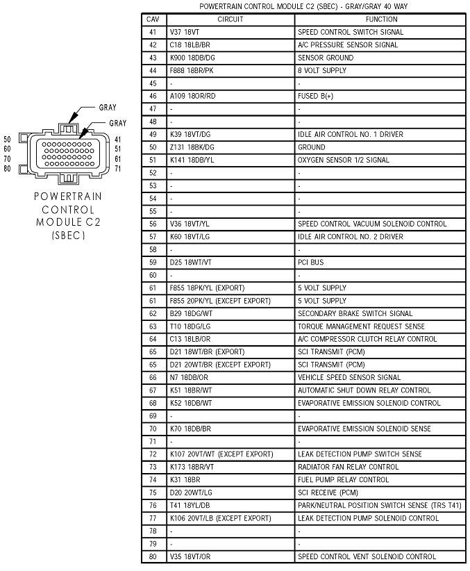

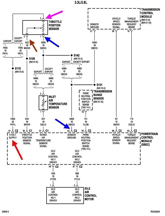

The numbers confused me. Forget about readings with the ignition switch off. Those don't mean anything. Also, to be valid, all sensor voltage readings have to be taken with them plugged in. Back-probe through the rubber seals the wires go through.
You should find 5.0 volts on the TPS supply terminal, and 0.2 volts on the ground terminal. The signal wire will read close to 0.5 volt at idle, and typically around 4.2 volts at wide-open-throttle. The exact values aren't important, but if you unplug the sensor, you'll see the signal voltage gets "pulled up" to 5.0 volts. That is to force the computer to detect a defective condition and set a fault code. Anything outside roughly 0.5 to 4.5 volts is what triggers the appropriate fault code.
For these circuits, it is never appropriate to use the positive post of the battery for a meter lead. All readings are in relation to ground, the negative post. Using the positive post is why you got 7 volts in some places. That is an invalid value.
I'm having trouble tonight with the online wiring diagrams. I'll try to post them tomorrow for you. In the meantime, I'm interested in what you have on the ground wires for those sensors. If that wire is open, you'll find 5.0 volts where there's supposed to be 0.2 volts. If that circuit is open, first look for a connector that could have some corroded terminals. Next, look near the Engine Computer to see if a really large bundle of wires runs under it on top of the inner fender. Those harnesses have been known to slide back and forth as the engine rocks, then a wire will rub through. Normally they short to the body, but it's still a good place to look for an open circuit.

Step 3: DMM (-) to Bat (-) & DMM (+) to sensor wire ground (plugged in, back-probed & key on) showed NO continuity.
Step 1: DMM (-) to Bat (-) & DMM (+) to pcm wire #43 DID have continuity.
Step 2: DMM (-) to pcm wire #43 & DMM (+) to sensor wire ground DID have continuity.
Step 1 shows continuity between ground and pin 43.
Step 2 shows continuity between pin 43 and the TPS.
Step 3 puts those two halves of the circuit together, (the two halves that have continuity), and now you have an open circuit. The only way that can be true is if the probe going into the back of the TPS connector wasn't making contact with the terminal, a common problem. Now's the time to unplug the connector and touch the probe right on the exposed terminal.
If there's 7 volts on pin 43, there has to be a break between that point and ground. For this type of problem, voltage tests are more accurate than resistance tests. All you need is one tiny strand of wire still intact to get a good resistance reading, but when current tries to flow through that little wire, a voltage drop will be developed that is easier to measure. This works best in high-current circuits like those for starters and charging systems, but it works best here too.

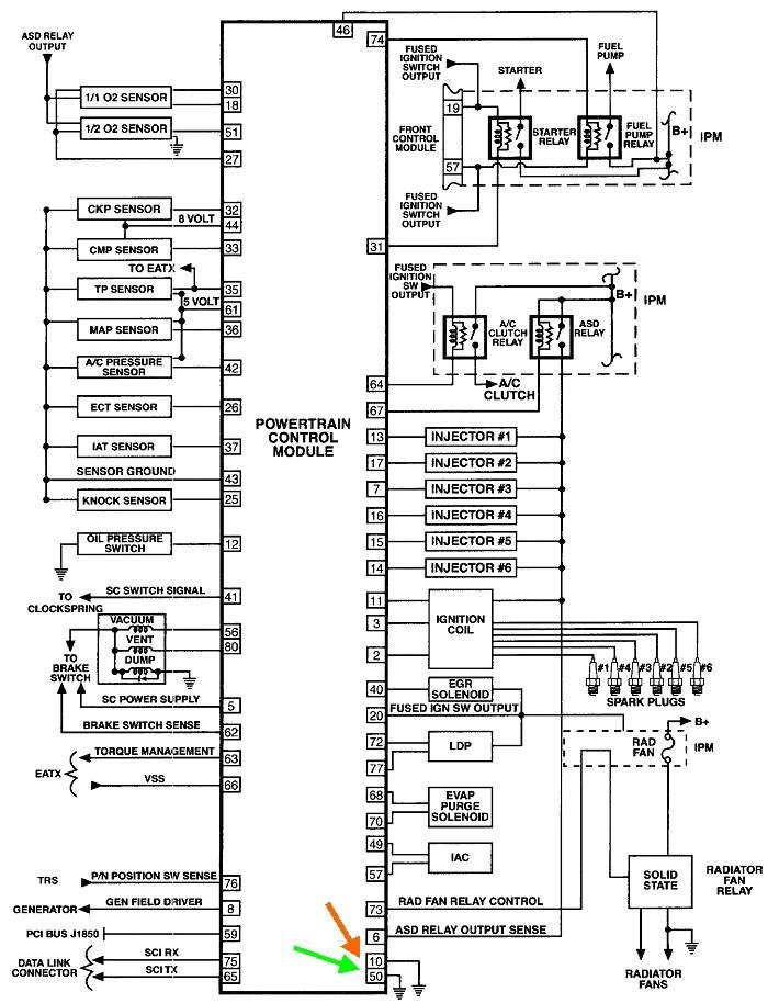

I'm surprised to see only two ground wires on the PCM. Normally there's four; two "sensor" grounds and two "power" grounds. They don't specify which is which here, so we'll have to check both of them. Start with the ignition switch off, back-probe terminal 10, and check the continuity. If you find an open circuit, the meter probe isn't making contact with the terminal. Once you verify you have continuity, switch to the "DC Volts" scale, then watch what happens when you turn on the ignition switch. You should hear the automatic shutdown, (ASD) relay click on for one second, then click off. All this time you should see 0.00 volts. Digital voltmeters don't respond fast enough to see any errant voltage show up for that one second, and auto-ranging meters respond even slower while they're selecting ranges, so you're going to miss any pulse of voltage for that one second, but it's highly unlikely there will be anything there to measure anyway. Focus on what you see after the ASD relay clicks off. That should be a steady 0.00 volts. If you see anything higher than that, there is a high-resistance in that wire, typically where it is bolted to the body.
If that looks okay, do the same test for terminal 50.
Now, to be fair, one of those two wires is for the power ground, meaning circuits that have pulsing current flow. That's injectors, ignition coils, relays, and solenoids. There is always a little resistance in any wire, so you can expect to see a small voltage dropped across the power ground wire when the engine is running. The reason they use separate ground wires is that small pulsing voltage that's dropped across the power ground wire would show up as the same small voltage on the sensor grounds if they shared the same wire and circuit. That wouldn't be a factor with relays and solenoids, but 0.01 volts means a lot to a MAP sensor, and that inaccuracy could affect engine performance. The point of this sad story is if you do find as much as a tenth of a volt on one ground wire, we'll attribute that to being the power ground and there's a lot of current flowing through it. With your crank / no-start condition, after the first one second of turning on the ignition switch, the ASD relay will be off, so there won't be the 12-volt feed to those high-current circuits, and therefore there should be no current flow through the power ground wire and no voltage dropped across it.
The 5.0 volt feed for the sensors does stay on with the ignition switch on and the engine not running, so you can do the voltage tests in those circuits.
If you find 0 volts on terminals 10 and 50, but something significantly higher than 0.2 volts on terminal 43, the computer has to be defective. Before I'd condemn it, I'd want to verify that with a scanner. That will display live data readings and will show what the computer is seeing for sensor voltages. If it shows the correct 0.5 volts for the TPS, at closed throttle, we're doing something else wrong somewhere. You can't have 5 or 7 volts on the feed circuit, 7 volts on the ground circuit, and something less in the middle on the signal circuit.

If you look at this diagram, you'll see a lot of sensors share the same ground circuit, so you should be getting a lot more fault codes if the ground circuit really is open.
