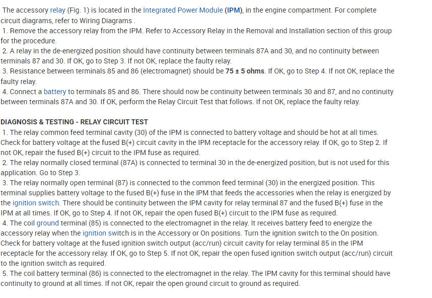

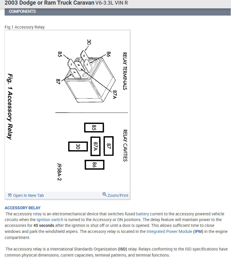

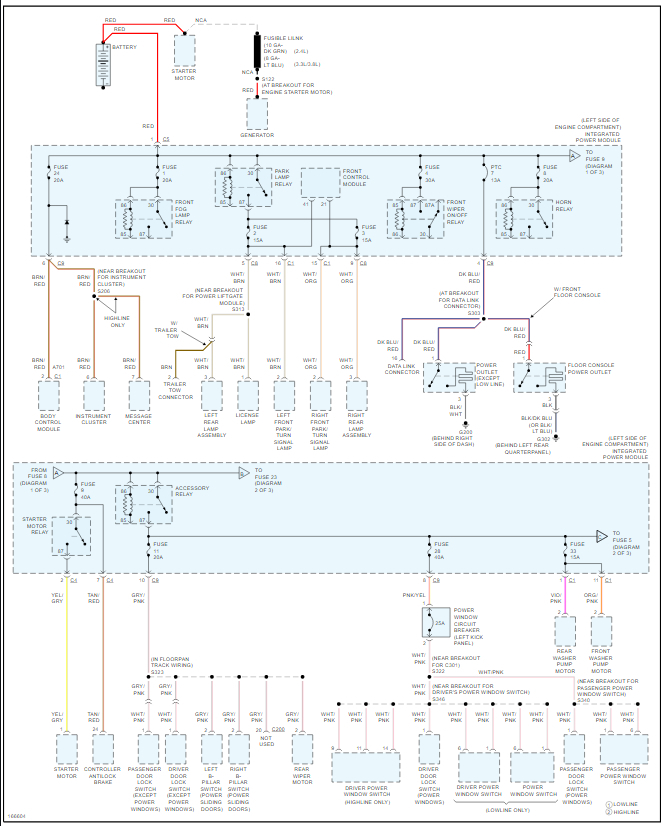

There are few possible reasons why you could have no start.
Check the power distribution relay under the hood.
First check for any corrosion or burnt pin on the plug
You can also test the relay as-well.
Other possibility is that the ignition switch could started to malfunction.
As when you turn the key it does not make any noise, it it a good chance that the ignition switch is malfunctioning. That's why you are not getting power to the gauges.
