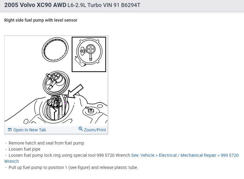

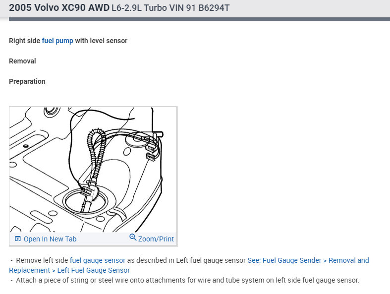

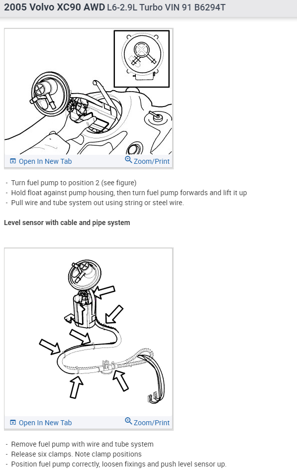

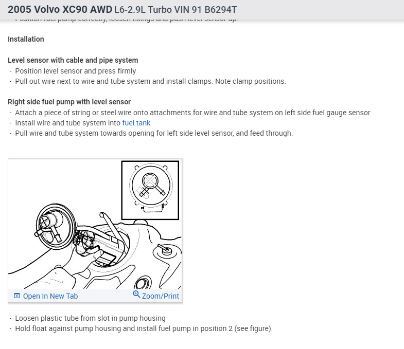

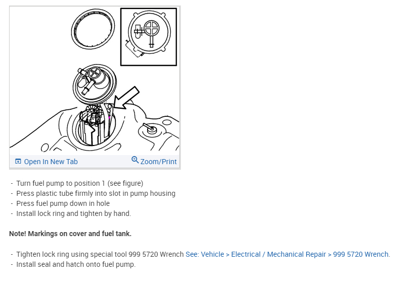

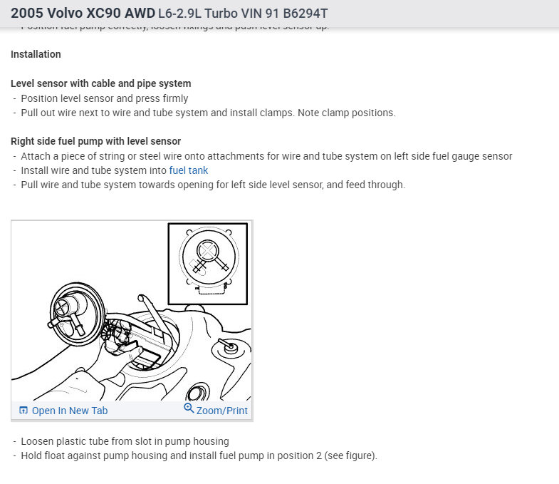

When the engine cranks over strong but does not start, it could be due to not getting fuel or spark. It can also be due to low to no compression.
When you turn the vehicle to the on position, can you hear the fuel pump come on for a few seconds?
One way to test if the issue is fuel, is by spraying starting fluid into the intake and try to start. If the engine starts and runs for a few seconds, then the issue is fuel related. Which could be bad fuel pump, or even having a clog in the fuel line.
Also, if the spark plugs are not producing spark, it will prevent the engine from starting. Which could be due to worn plugs or faulty coils.
Take a look at this helpful guide:
Let me know what you find or if you have any questions.

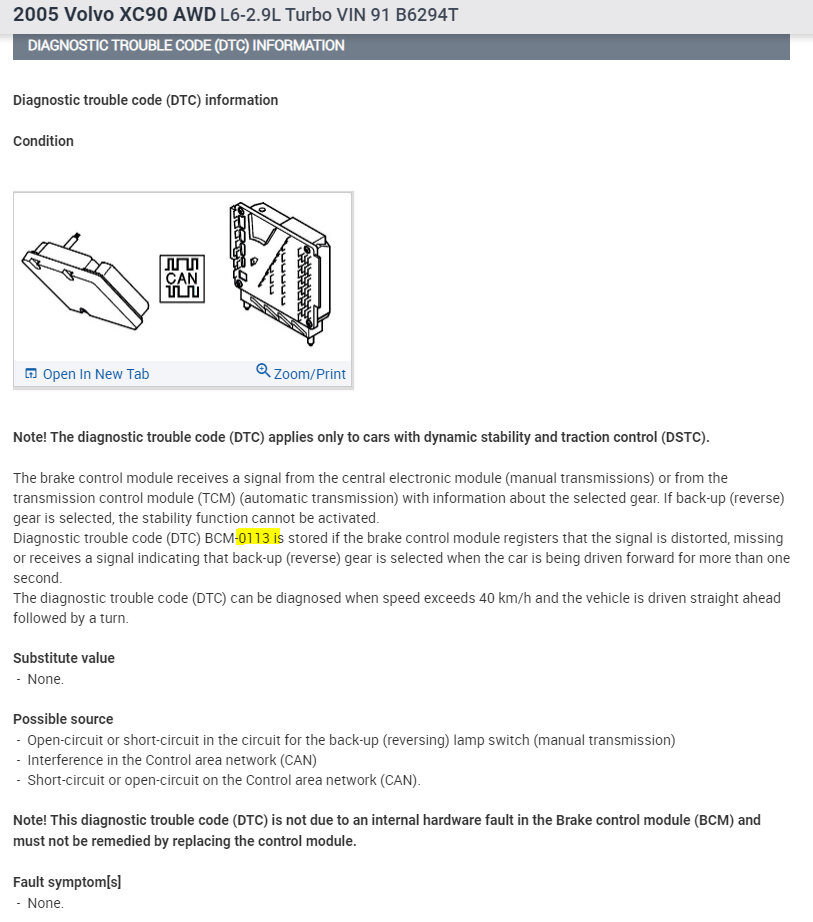

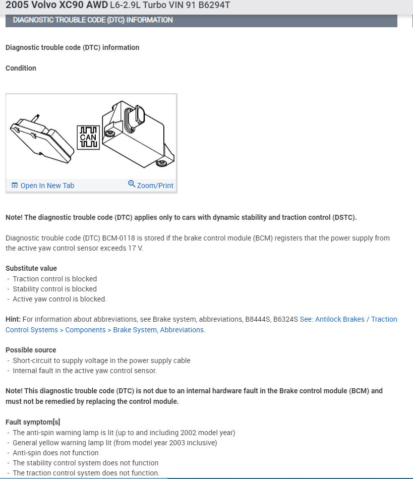

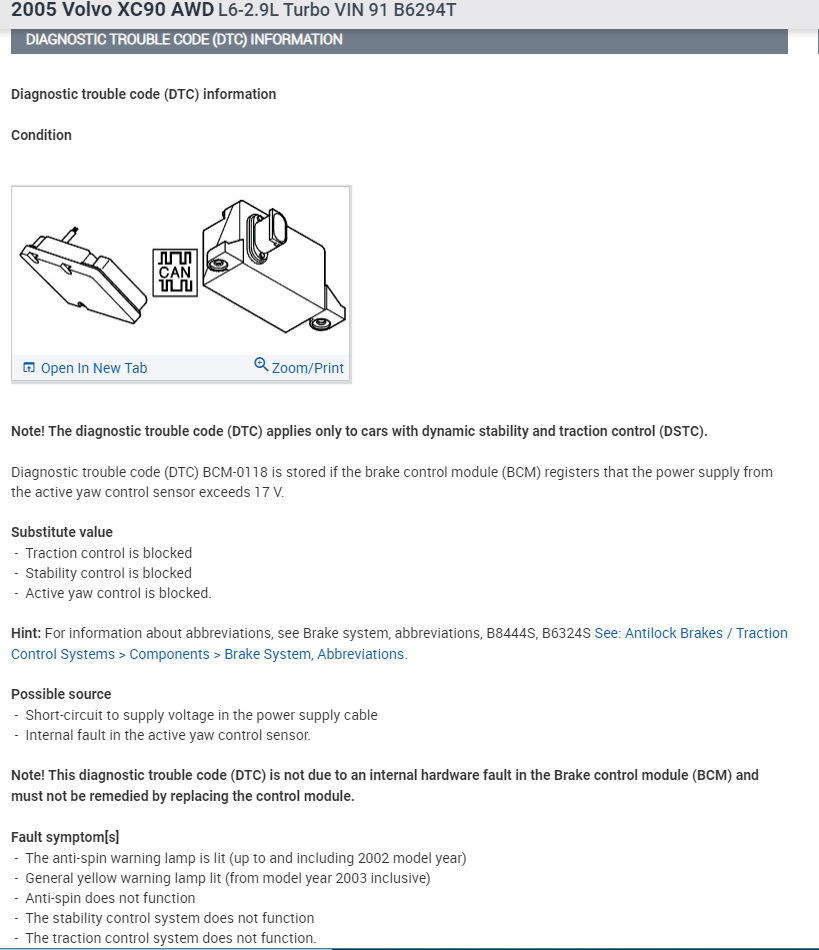

same Volvo XC90 T6 turbo six cylinders 2005 the car was running without any reason crank but won't start my two analyzers show no codes on the messages window appear code 113 and 118.what does that mean?
Nov 16, 2022 at 1:53 AM
SQM
  • 6,383 POSTS
Those 113 and 118 gets triggered when the brake control module gets in correct signal or has wiring issues. Usually that will lead to non functioning ABS and traction control.
Take a look at the fault code overview below.
That should not keep the engine from starting.
