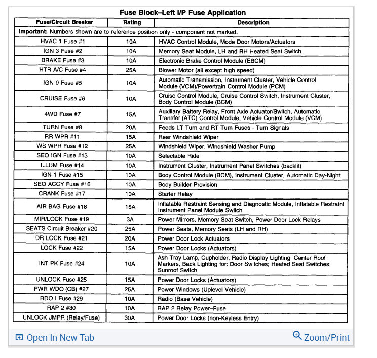

Okay, so my husband changed the transmission. The next day we got to drive it. It went in reverse and everything. Well, that night the horn went crazy at 3:00am. We went back out to leave round 11am and now it wants to crank, start but then shuts off instantly.
Apr 14, 2023 at 7:06 PM
  • 55,721 POSTS

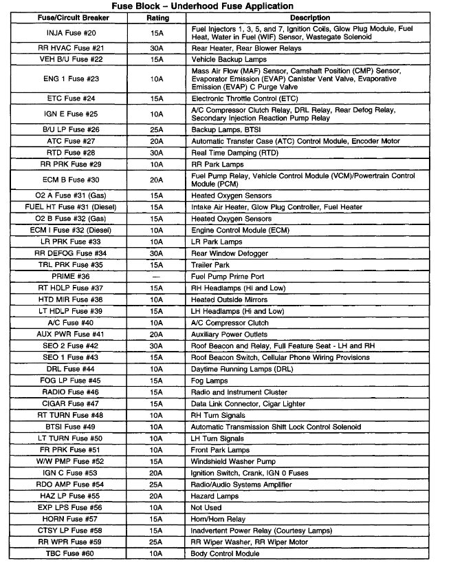

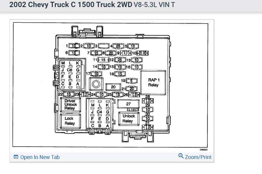

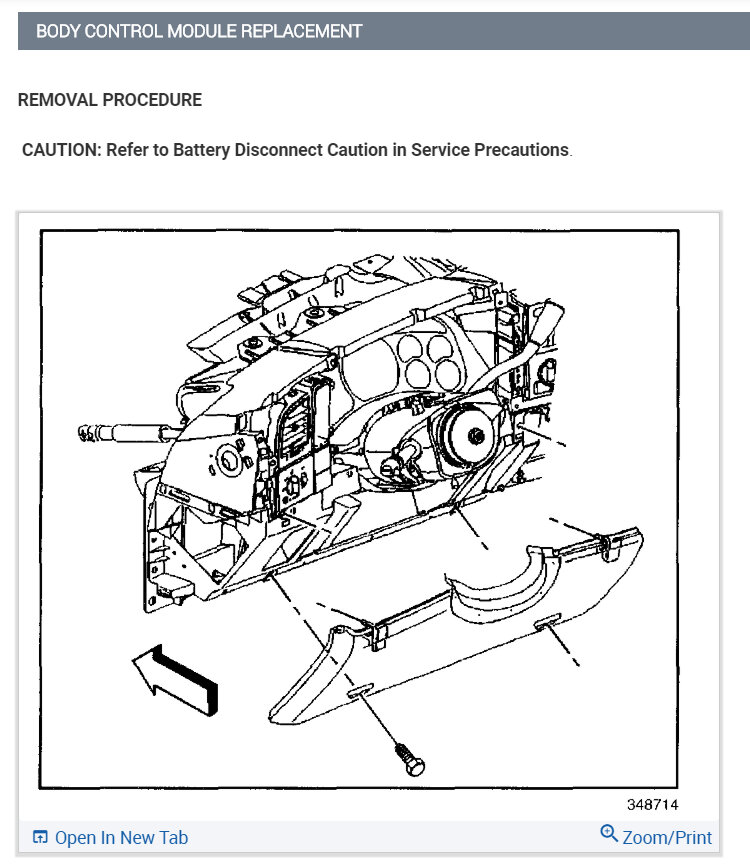

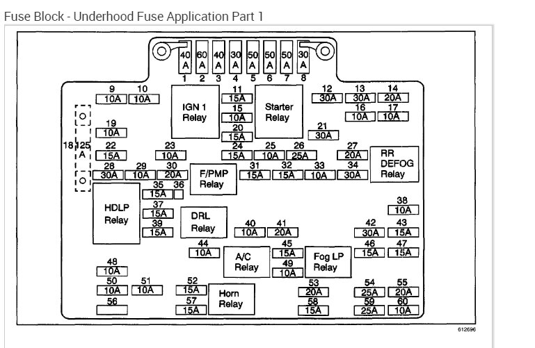

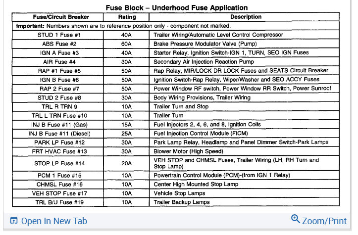

There are a few ground wires that need to be checked at the bellhousing. Can you please recheck the connections? Also check the fuses as well.
Here is a guide to help and the fuse locations as well:
Apr 15, 2023 at 4:30 AM

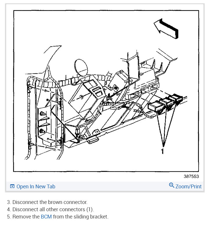

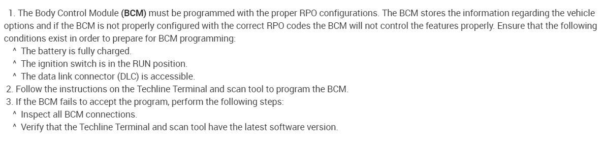

Yes, there should be a ground wire at the bellhousing bolts if not you may have had a voltage spike when the battery was connected. Did you check the fuses? If they are okay, it sounds like the BCM when out but to be sure we should do a CAN scan which is easy. You can get a CAN scanner (Controller Area Network) which will work on most cars from Amazon.
https://youtu.be/u-4syLc-ifQ
and
Here is one for about $99.00 if you need it:
https://amzn.to/3ZixY4v

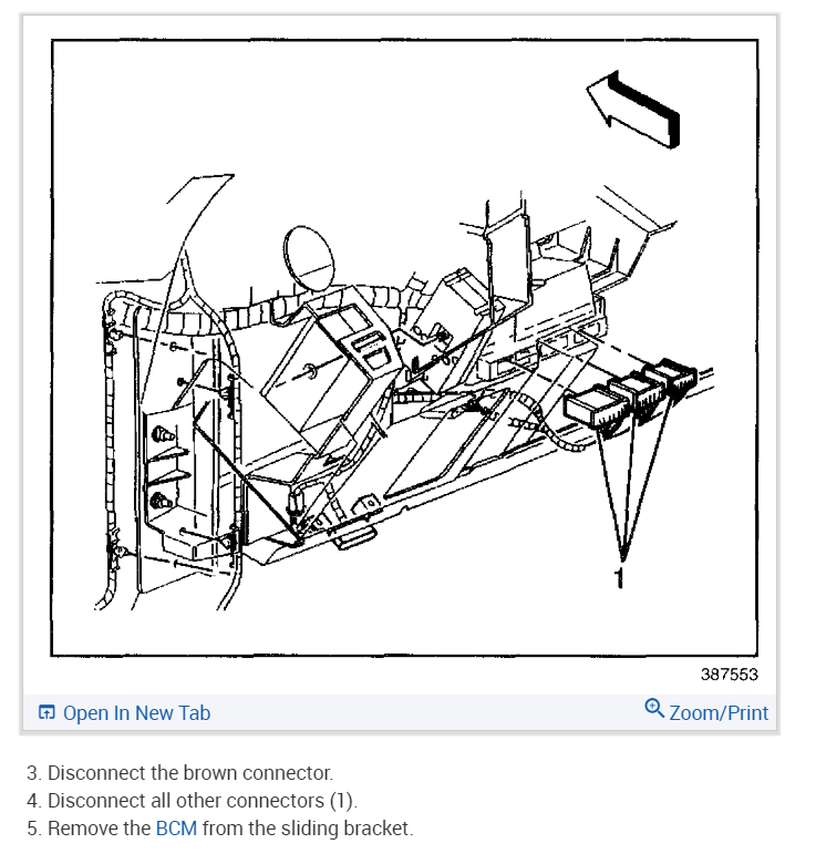

Here is the location of the BCM and how to replace it in the images below. Check out the images (below). Please let us know what happens.
