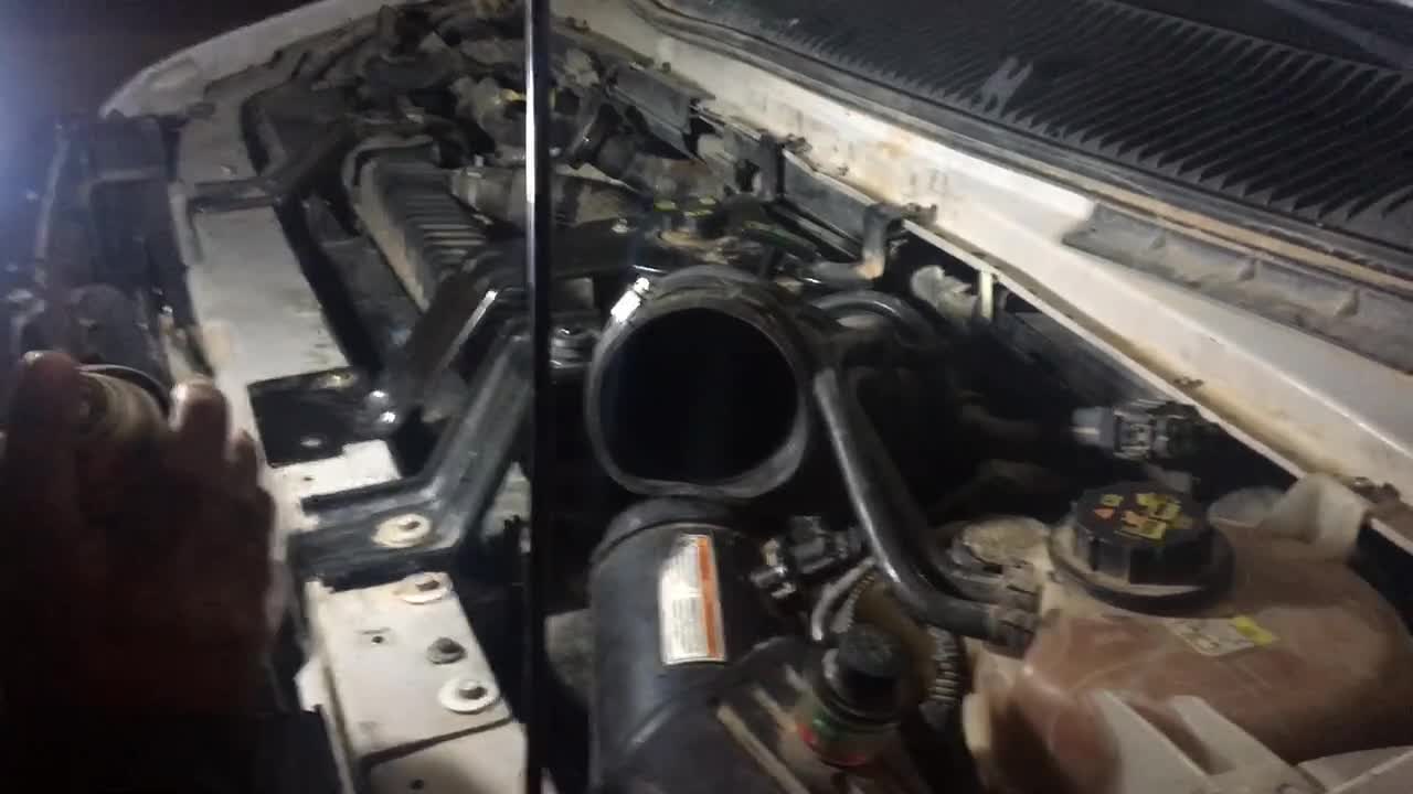

Engine cranks would not start, but when I sprayed as shown in video it started right away?
2010 FORD F-450
82,000 MILES
AZZAM12AZZAM
  • 86 POSTS

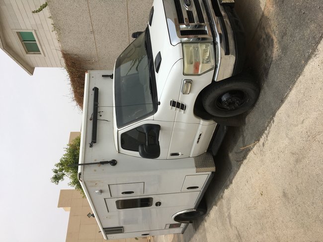

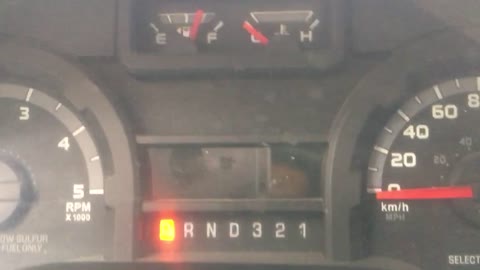

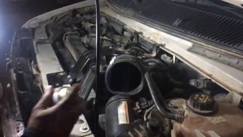

Dear sir, i have a Ford e450 diesel 6.0 year 2010. My problem i crank but wouldn't start but when I sprayed as shown in video start right away. i drive everything is perfect even i stop the car for 3 hours and crank start fine without spree. But my problem if i park overnight and after approximately 10 or 11 hours when crank wouldn't start, so I have to do the spray process again to start and so on. I checked the oil regulator. It seems fine i was wondering if it is a fuse or sensor. where is it located? If this is the problem where can i look to solve this problem? Thank you. Pic for the car and two videos explaining what i did.

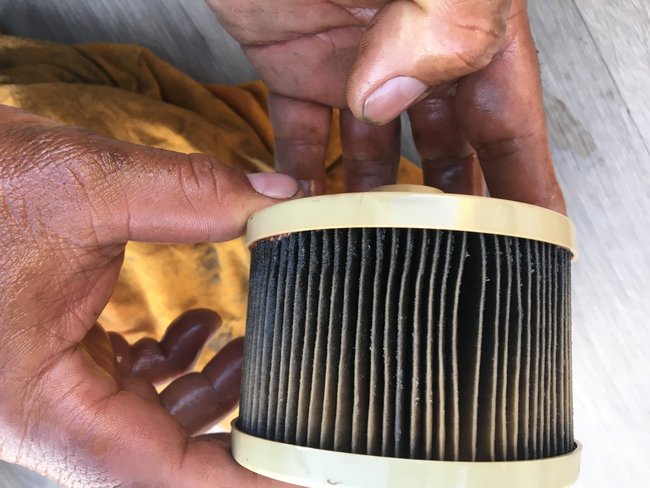

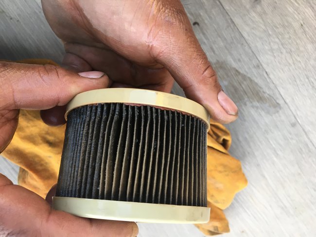

AZZAM12AZZAM
  • 86 POSTS
After i sent replay i checked the fuel filter under chase and this is how it looks. i will buy new hopefully this is the problem.
Thanks
Aug 20, 2022 at 8:04 AM
AZZAM12AZZAM
  • 86 POSTS
This is.
Aug 20, 2022 at 8:05 AM
  • 110,194 POSTS
That certainly can be at least part of the cause. If you have a chance, could you let me know if it helps? I'm interested in knowing.

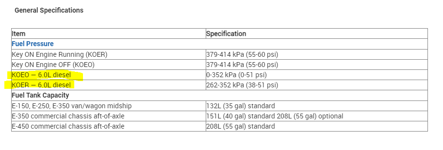

  • 110,194 POSTS
No problem whatsoever. You can ask as many questions as you want. LOL
I feel cycling the switch the first time allowed the fuel pump to build enough pressure to start it. If you tried it after replacing the filter, it may have required more time because the filter needed to refill and build pressure.
If I have to guess, I feel there is fuel pressure drop-off. When the engine is off long enough, the pressure is dropping too much and it won't start.

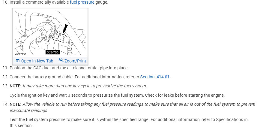

Try the key cycling again now that it has run and let me know if it works.

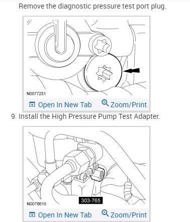

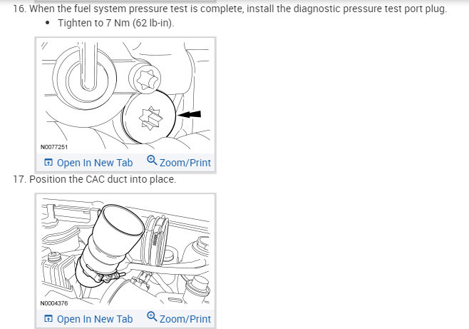

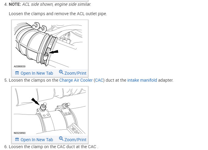

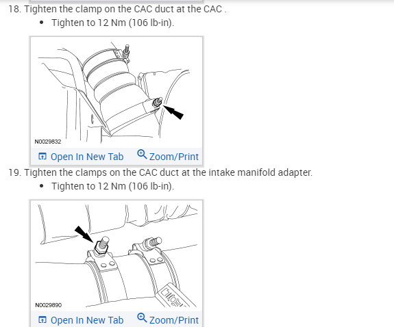

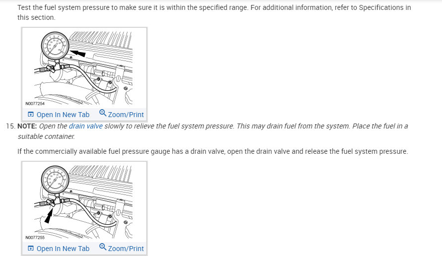

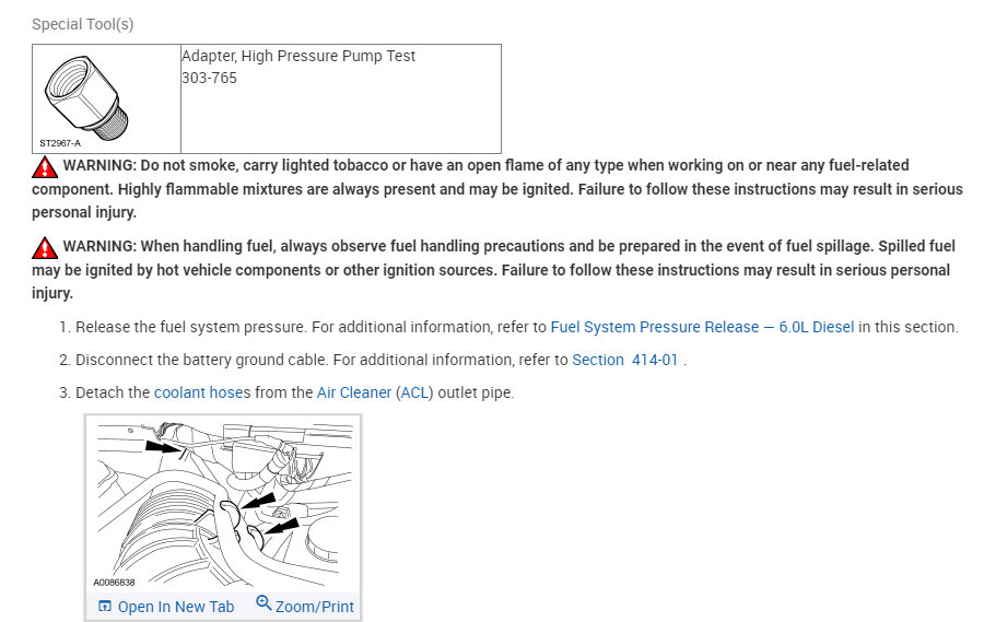

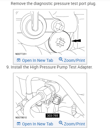

Also, the next step would be to test the fuel pressure to see if it jumps to the manufacturer's specifications.

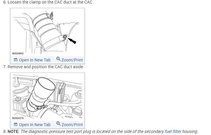

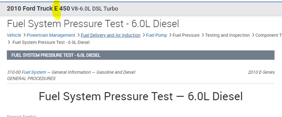

If you look below, I attached the directions. The last pic has the specs. Also, the 6.0L wasn't offered in the F series. It was in the E series. Could you confirm that for me?

I am still using the starting fluid every morning.
What amazes me Joe, is cycling the key worked perfect first but then i try every morning no luck I don't know why.
Secondly the car keeps running and cranks right away the whole day even i leave it for 4 or 5 hours but what i have noticed when i park it for 8 hours or more went start from your point of view, why?

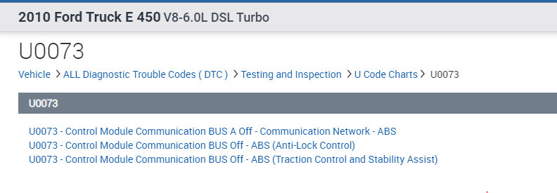

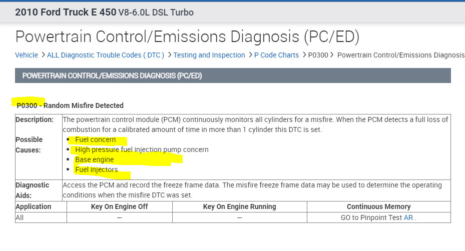

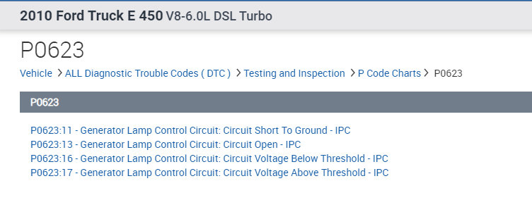

It took some time to for the job, we checked the fuel pressure was in range also no bubbles i have but nre ipr and EGR new oil and filter i still have the same problem sometimes it start after long crank sometimes with spray but i notice when it is hot start right away within 2 second i scan with OBD i got these code:
U0073
P0623
P300a
Even though I am not sure the guy who did this scan professional
I suspect may be sensor i will keep tracking but does the code above mean something that helps.
Thanks Joe.
Sep 15, 2022 at 4:09 PM

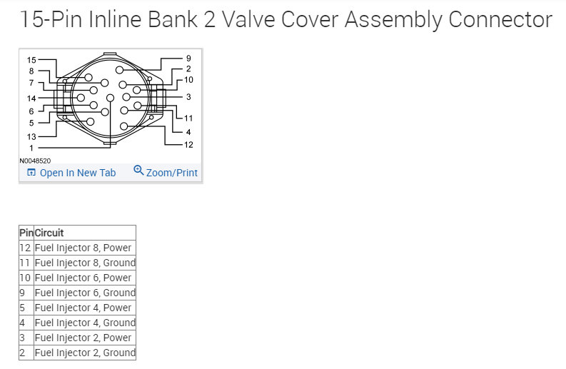

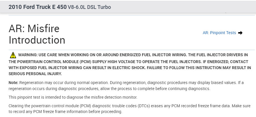

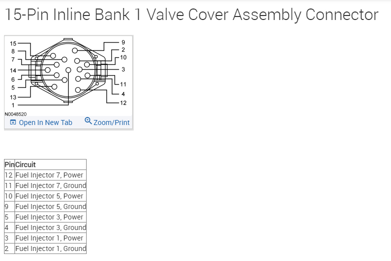

  • 110,194 POSTS

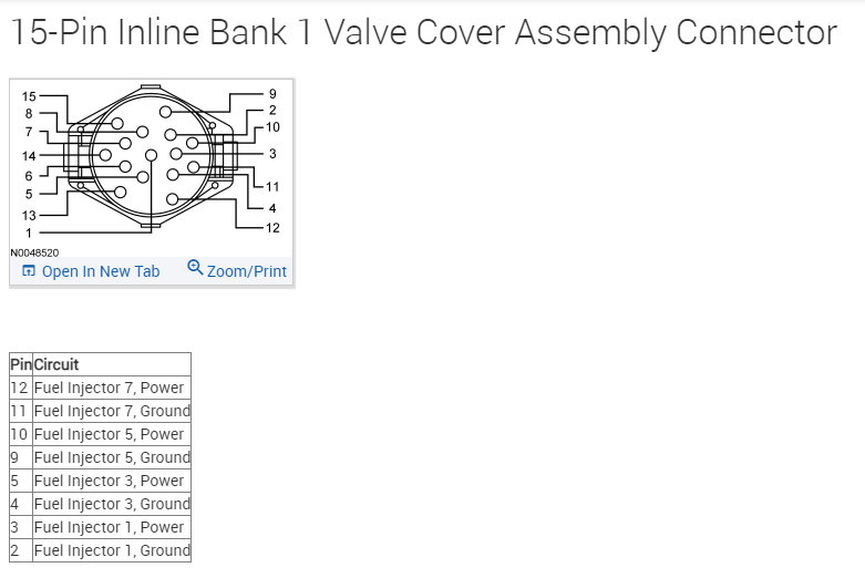

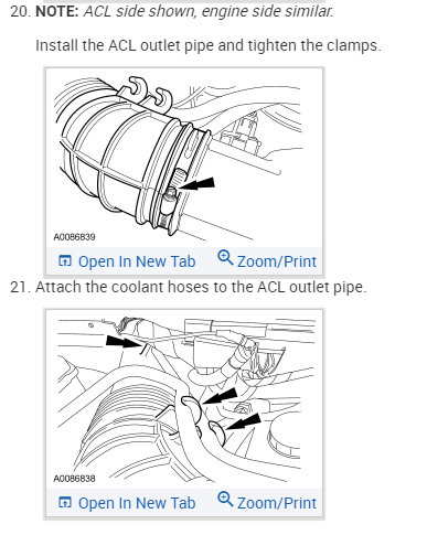

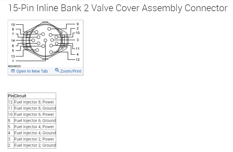

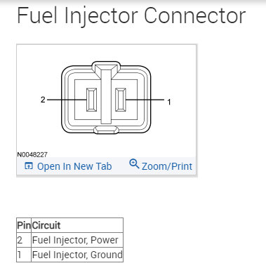

The P0300 is likely related. It indicates a random misfire. The other two codes are not related. One is an issue with the ABS, and one deals with the alternator lamp. If you look at the first three pics, they indicate what each code indicated.
The remaining pics are to check the misfire monitor. Check to make sure there are no wiring issues.

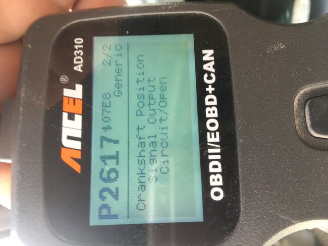

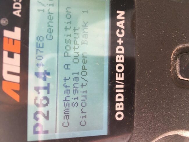

If i may ask, while i was trying to figure out where is the problem i have installed a new camshaft i had these code in OBD but did not come again. may I know what's that and how to fix it in case appears again?
I am really thankful for everything you did for me.
Oct 5, 2022 at 4:16 PM
  • 110,194 POSTS
Thank you for the update and you are very welcome. I'm glad to know you found the issue. As far as your question, which codes did you have related to the camshaft position sensor?
Oct 5, 2022 at 6:48 PM
AZZAM12AZZAM
  • 86 POSTS
Thanks Joe.
These codes:
P2617
P2614
Oct 6, 2022 at 2:04 AM
  • 110,194 POSTS
Both codes indicate an open circuit. Have you checked for damaged wiring, a faulty connector, or anything that may prevent the circuit to be completed?
