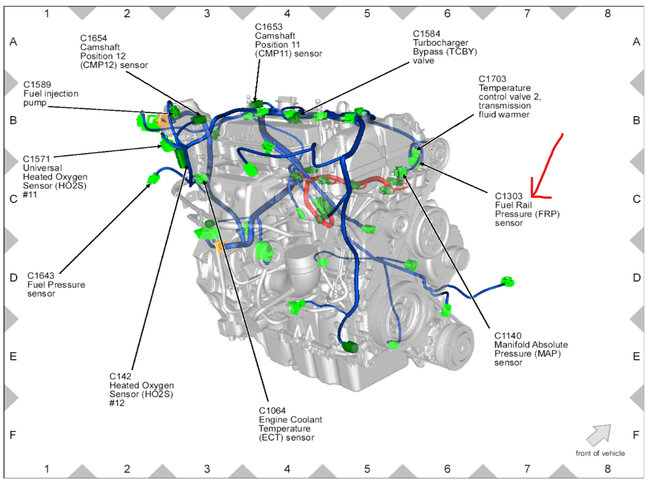

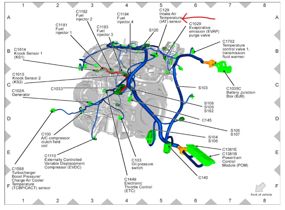

Car will turn over but will no start. Have a DTC P0088 Fuel Rail/System Pressure - Too High and also a DTC P0113 IAT Sensor Circuit High.
Jun 18, 2023 at 10:29 AM
  • 55,456 POSTS

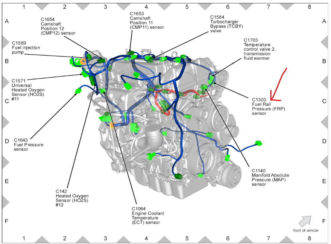

Yep, a shorted fuel rail pressure sensor can cause the engine not to start, here is the location of the sensor and additional information on the codes as well:
The code P0088 is a generic OBD-II trouble code that stands for "Fuel Rail/System Pressure - Too High".
Here is the air intake sensor as well so you can swap it out or see if it is plugged in.
