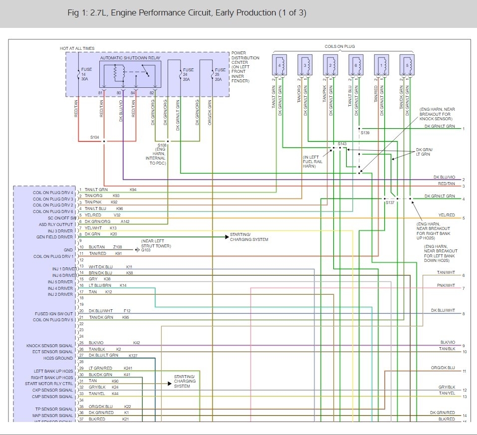

No start only signal from PCM on one cylinder
DARREN LEE WATTERS
  • 2004 CHRYSLER SEBRING
  • 2.7L
  • 6 CYL
  • 122,000 MILES
Has new timing chain tension-er, cam sensor, crank sensor, ignition coils, spark plugs, spark plug boots.

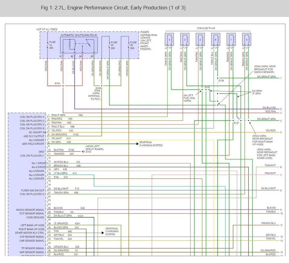

Every ignition coil has continuity to the PCM.
cav1 of PCM to cylinder four (ignition coil).
cav2 of PCM to cylinder three (ignition coil).
cav3 of PCM to cylinder two (ignition coil).
cav4 of PCM to cylinder six (ignition coil).
cav11 of PCM to cylinder one (ignition coil).
cav21 of PCM to cylinder five (ignition coil).
these wires all have confirmed continuity.
However, when cranking the engine I only have fire on one cylinder (i.E. Signal)
Thus, the Chrysler beast won't start.
I know that the one wire from the ignition coils go to the PCM, but what about the second wire from the ignition coil as these are two wire systems?

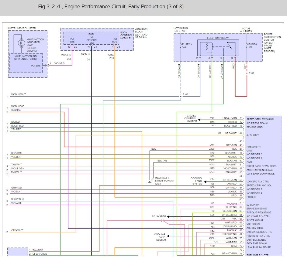

It sounds like it could be the ASD relay. Here is some wiring diagrams and a guide so you can see how to test the wiring.
Please run some tests and get back to us so we can continue helping you.

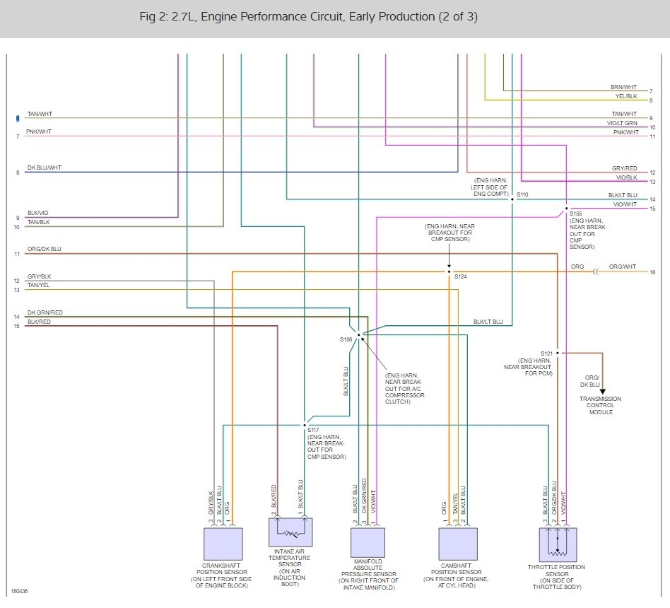

The crankshaft sensor is brand new, The camshaft sensor is brand new. Both sensors were tested for power (both were good), both were tested for grounds (both were good), both were tested for signal but cam back with no pulse/signal noted! All wires were tested for continuity and came back good.
The Coil Over Plugs - all 6 - coils were good for power, yet all 6 coils like that of the crankshaft sensor and camshaft sensor all came back with no signal/pulse noted. All the wires came back good for continuity.

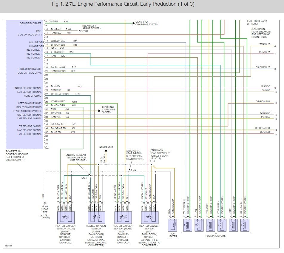

The Fuel Injectors - all 6 - were good for power, yet all 6 fuel injectors like that of the crankshaft sensor and camshaft sensor all came back with no signal/pulse noted. All the wires came back good for continuity.

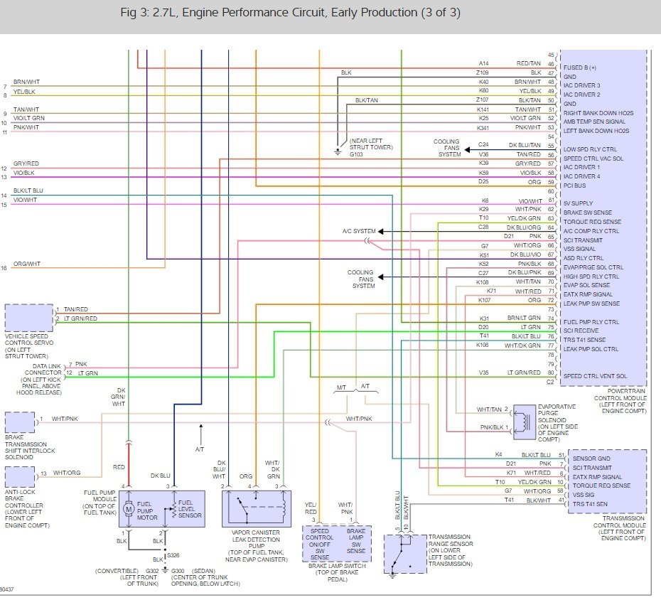

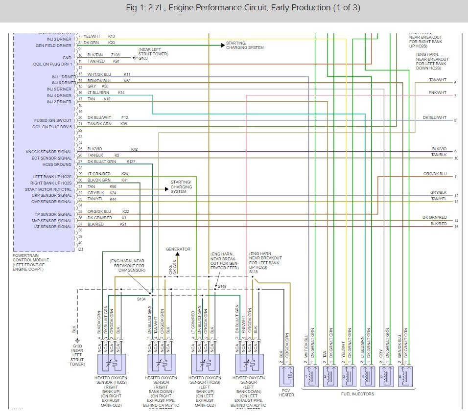

That just means you have interrupted the power to the PCM. Here is an engine wiring diagram (BELOW) so you can check for power and computer reference volts among the sensors.
Here is a guide to ehlp you do some testing

The Cam Sensor, Crank Sensor, all 6 fuel injectors, all 6 coils, test good for power, and good for grounds on crank and cam sensors. Likewise, continuity check on all the wires for everything is good. Since resetting the PCM through disconnection of battery the car has been cranked a good 30 times with only the battery code showing up now. Prior to that, as stated, there was numerous codes. Still crank - no start. As stated the rpm needle does move to about 300-500 rpm when cranking.
Friday, May 26th, 2017 AT 10:35 AM
LEE WATTERS
  • 14 POSTS
As I stated before everything tests good accept for there is no signal pulse noted for the sensors, the injectors, or the coils.

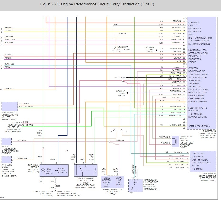

This sounds like a computer has gone bad in this car. Try to find a used one to plug in and try. Did you ever check the wiring from the diagrams I gave you?
Monday, May 29th, 2017 AT 3:36 PM
LEE WATTERS
  • 14 POSTS
This is the second PCM with the same issue noted with the original, the first replacement, and now this one. Yes, I used the diagrams. The grounds on the crank and cam sensors are grounded through the PCM. When cranking both the ASD and TCM relays are shown as good. Likewise, as they are operating accordingly and the rpm is seen as jumping to the 300-500 mark in the instrument cluster panel is an indicator that the PCM ground is good. Thus, is it possible that the TCM somehow is interfering with the PCM. I.E. Not providing signal to the PCM?
Is there a way to test the TCM?
