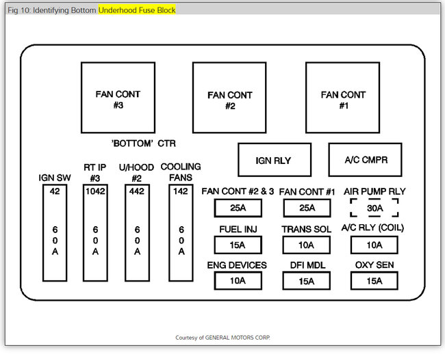

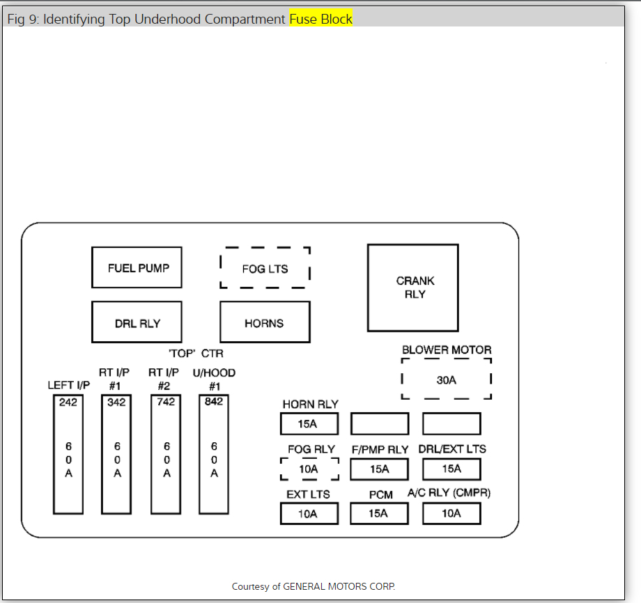

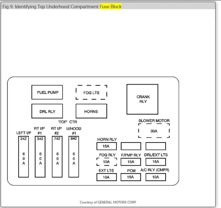

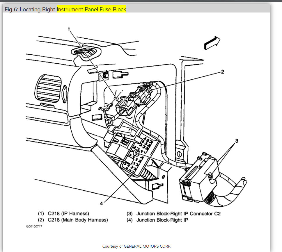

I'm working on the car listed above 3800. It cranks but doesn't have spark. I've tried everything I can think of and haven't had any luck. I've replaced the ignition switch, ignition lock cylinder, ignition control module, coils and crankshaft position sensor. I've cleaned the engine ground for the ICM that is shared with the oil level sensor to be sure it's getting a good ground. I'm kind of at a loss at this point. Any help would be greatly appreciated. Thank you

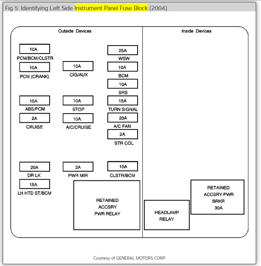

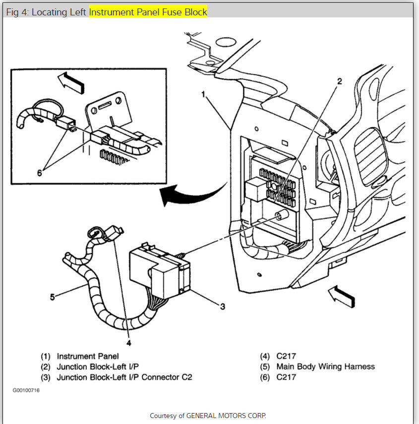

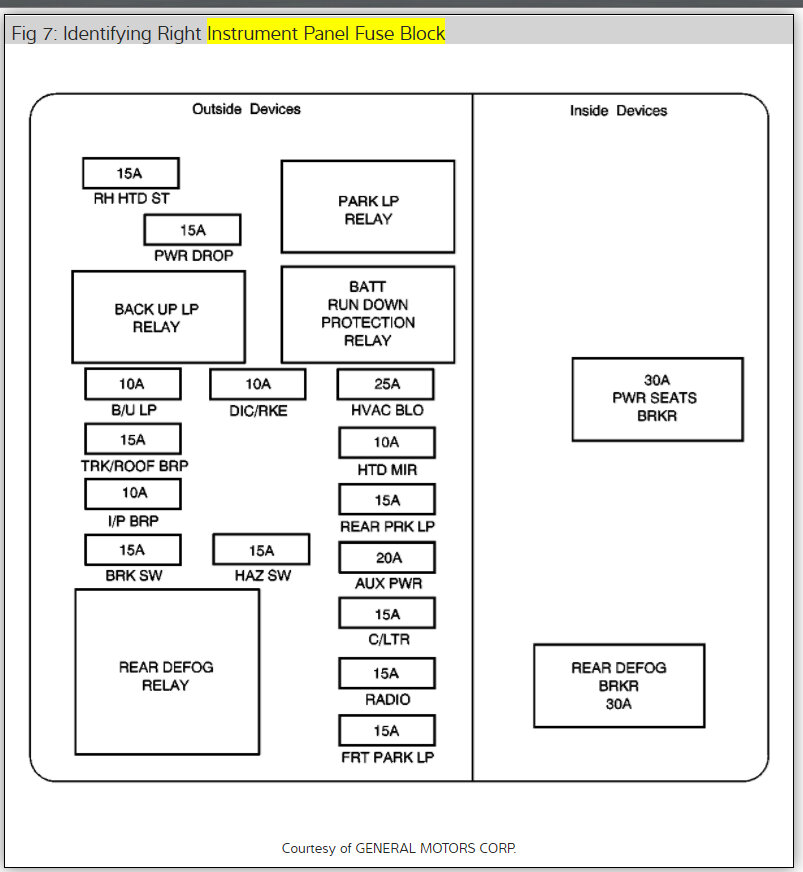

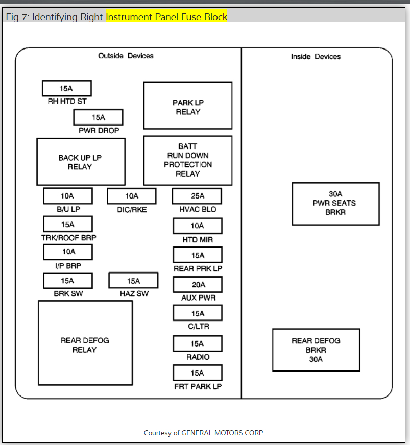

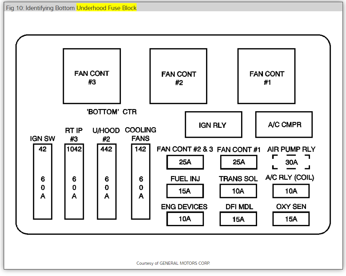

Let's run the codes to see what comes up, Also, is the security light flashing? We should check all fuses with the key on, here are three guides to help us get started on fixing the problem:
and
and
https://www.2carpros.com/articles/car-not-running-advanced
