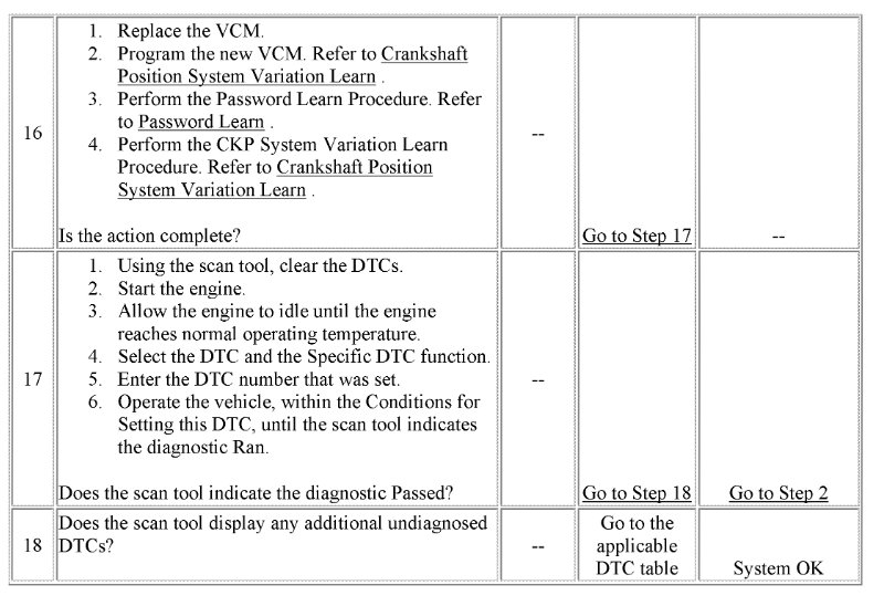

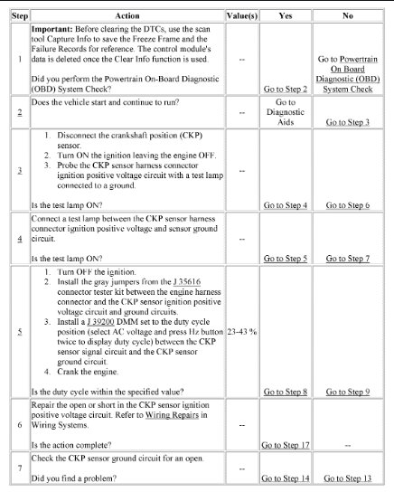

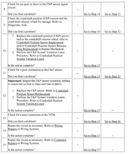

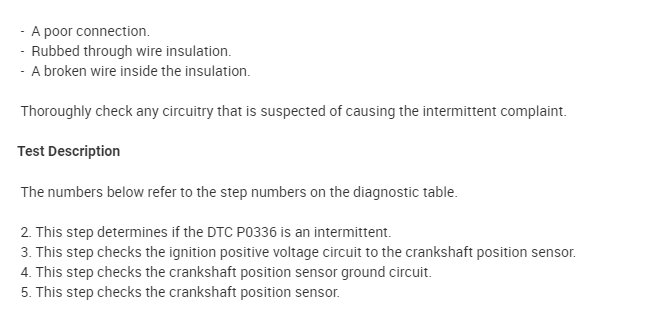

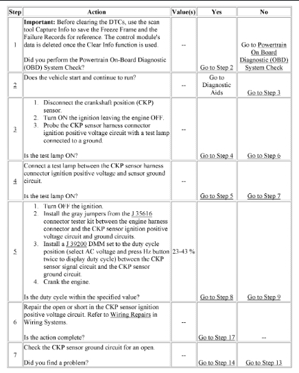

If there is no spark, I attached diagnostics below specific to the code you provided. Take a look through them and let me know if you are comfortable performing them.
