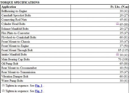

I need the torque specs for main cap and any other parts that get torqued

i will need the 8th digit of your VIN so i can get the correct torque specs for your engine

the 8th didget is H

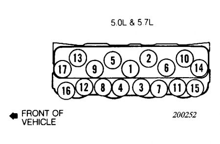

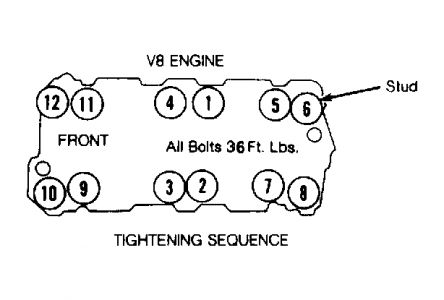

thanks for that. below is the information you requested..
https://images.2carpros.com/forum/automotive_pictures/261618_Noname_1828.jpg
FIG. 1

FIG. 3
https://images.2carpros.com/forum/automotive_pictures/261618_3_42.jpg
