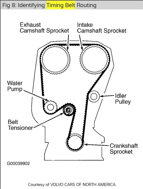

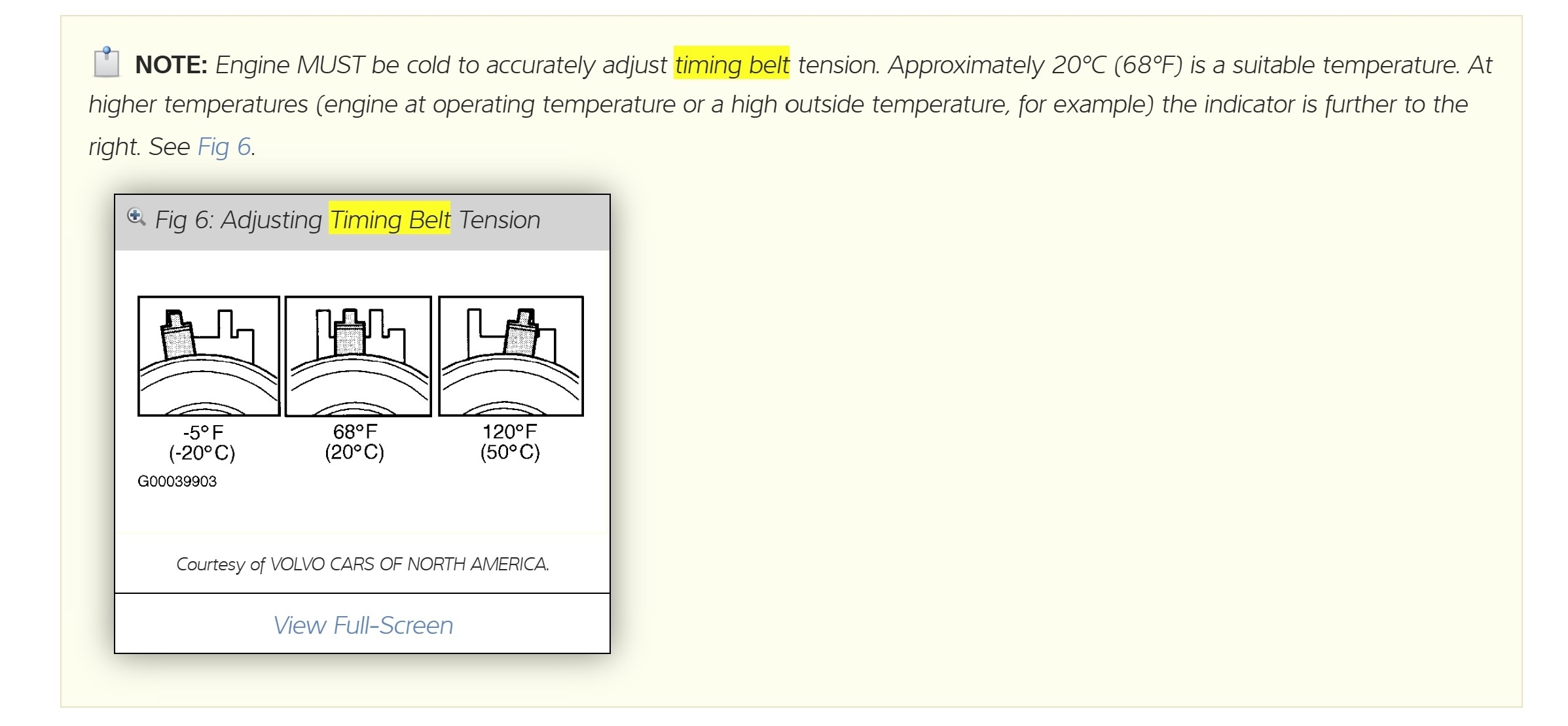

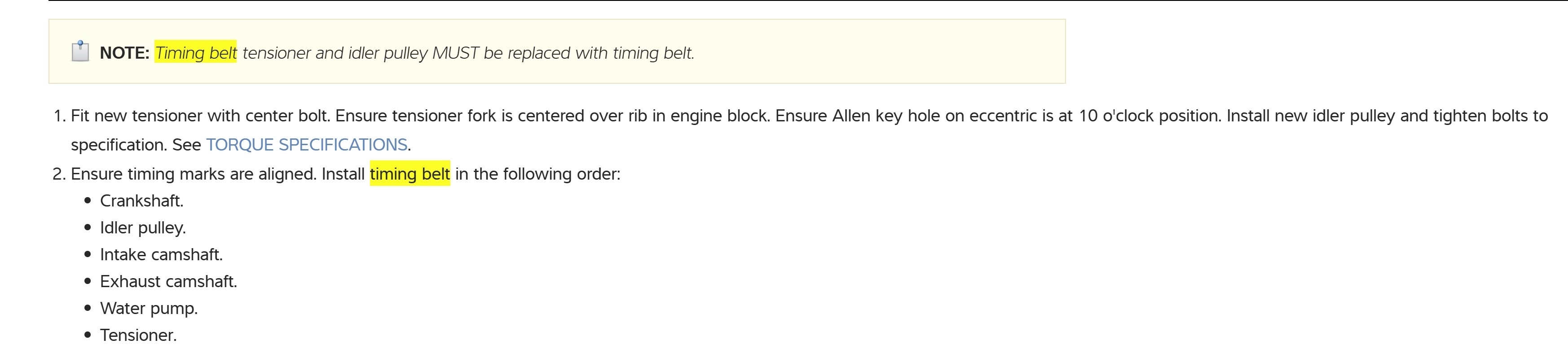

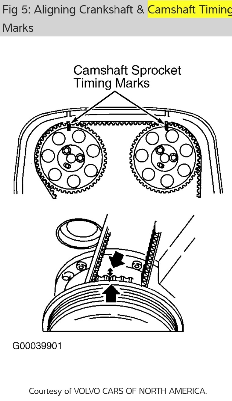

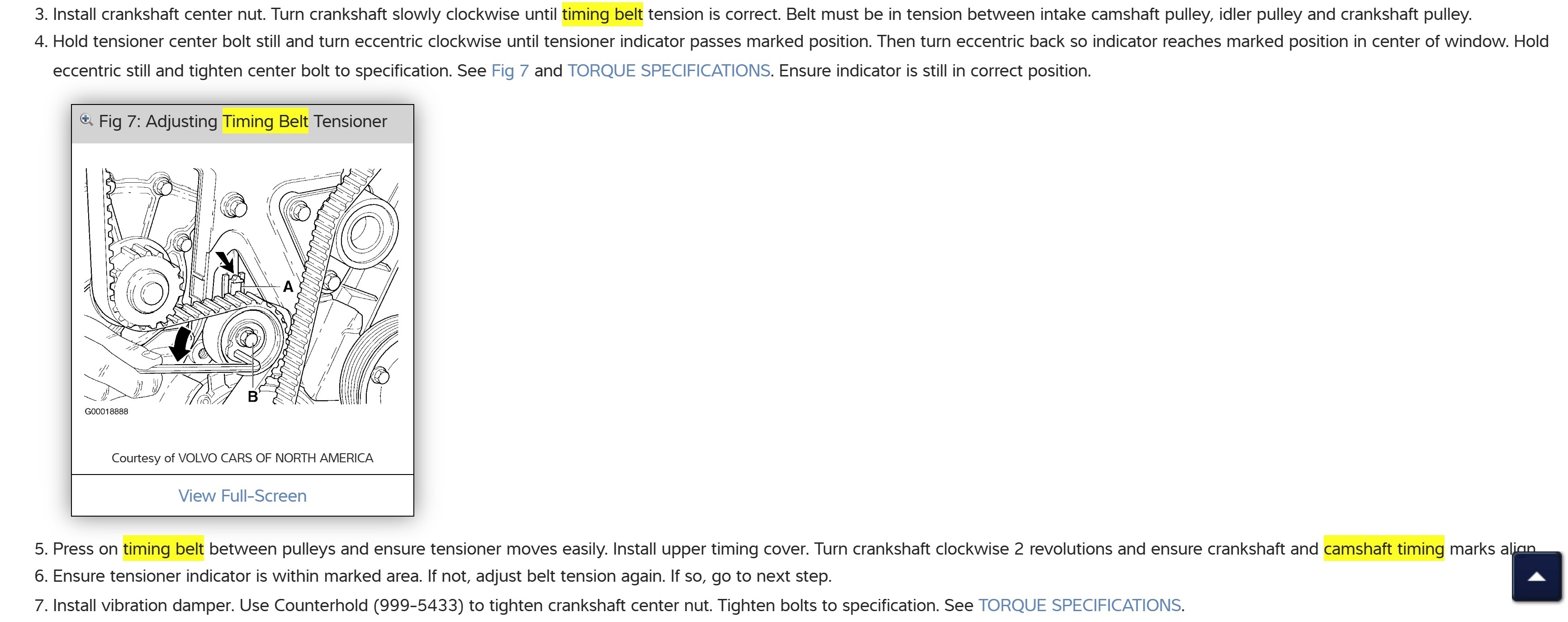

I originally replaced the timing belt, water pump, and idler pulley on the car listed above. Everything was okay, the car started up and ran fine for about 2 weeks until the car had an oil from the cam seal and valve cover. While replacing the seals and valve cover, I removed the timing belt again to clean everything. After I got everything back together the car wouldn't start. I checked and made sure everything was lined up to the marks. Checked for fuel and spark. Everything was good. Is there something else I need to check for or is there something I could have missed and forgot to do in the process of putting everything back together? Please help and thank you in advance for any help.
Mar 15, 2023 at 3:56 PM
BRENDON S
  • 653 POSTS

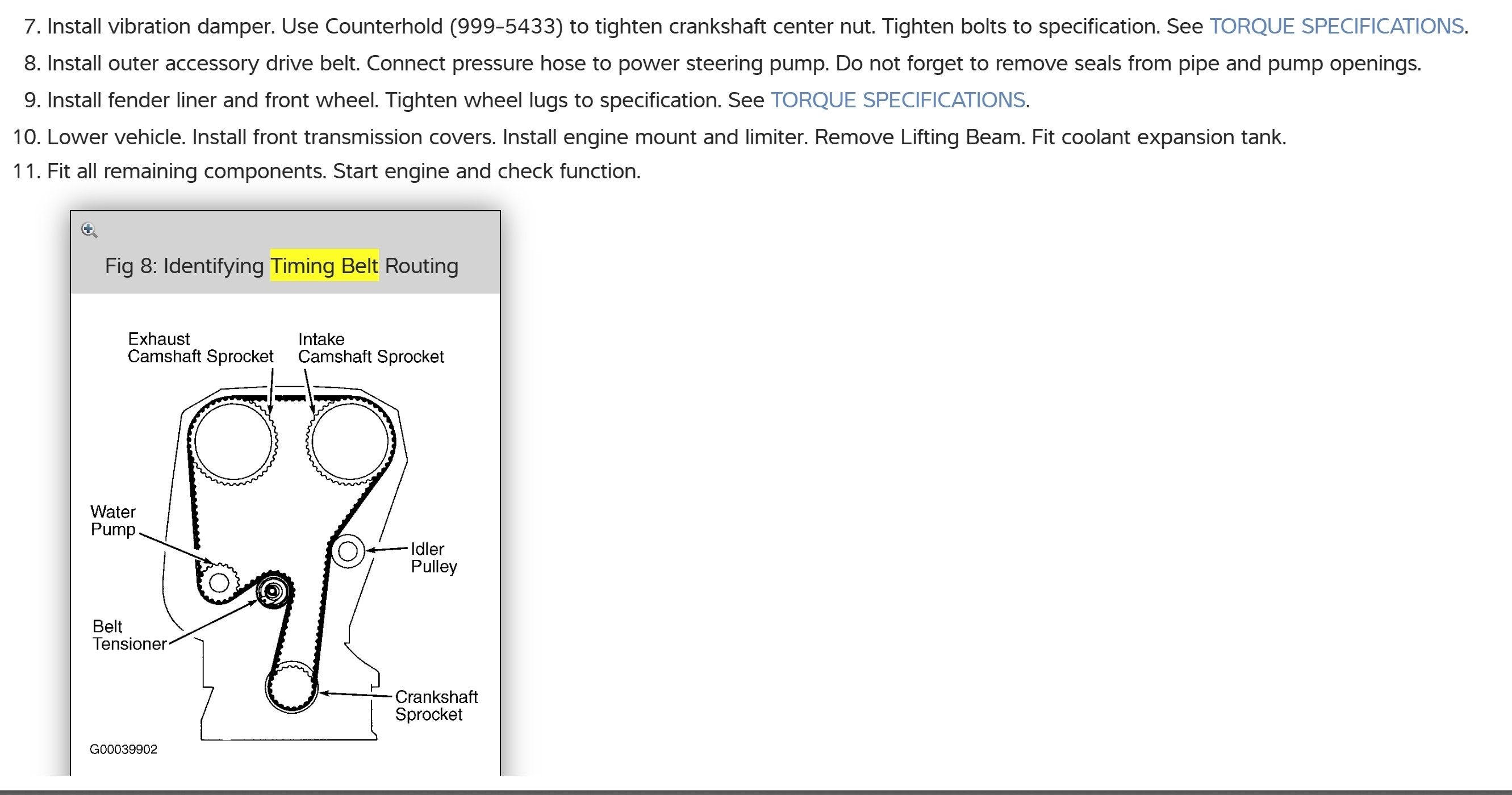

Good morning, BAYNH,

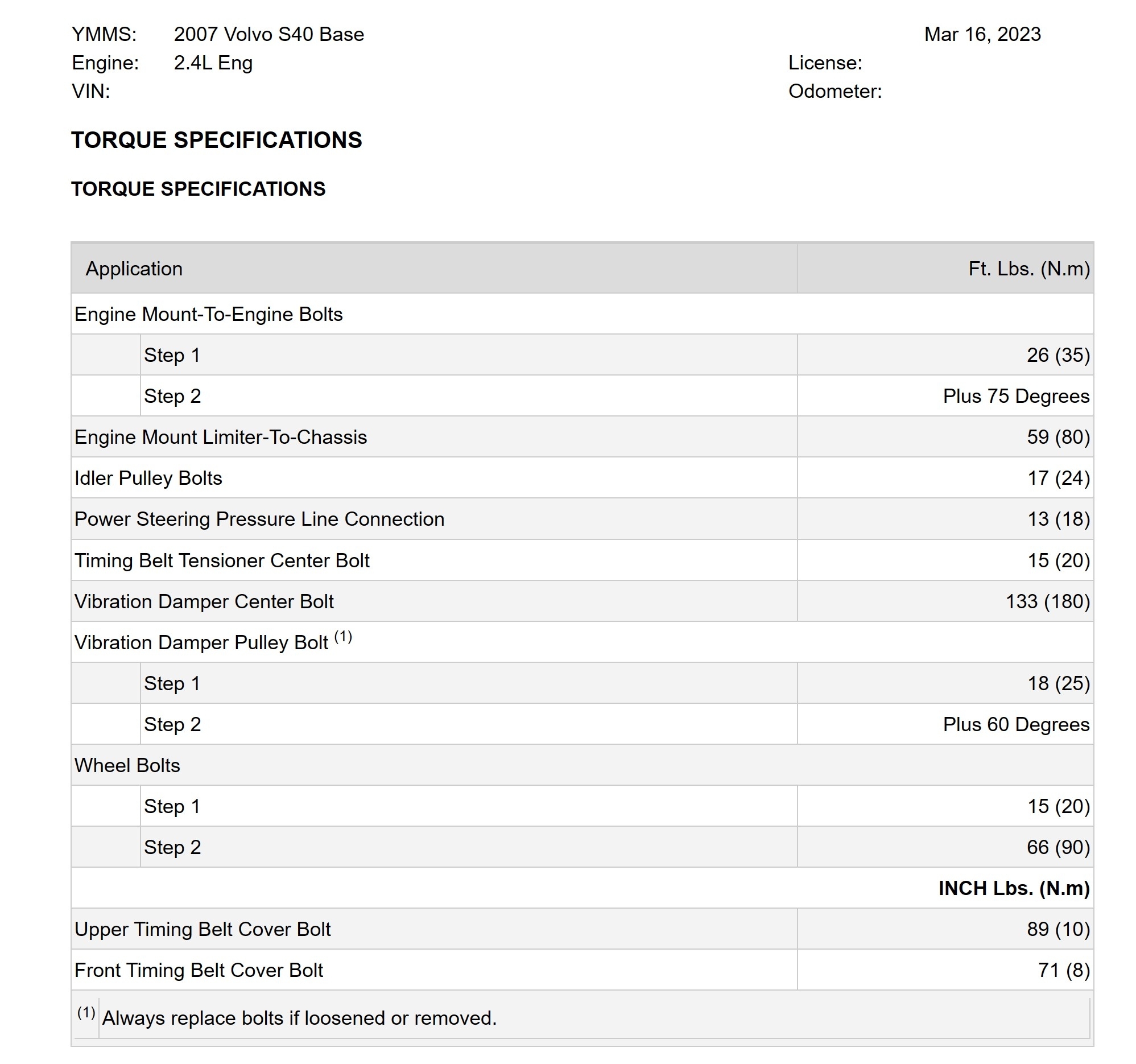

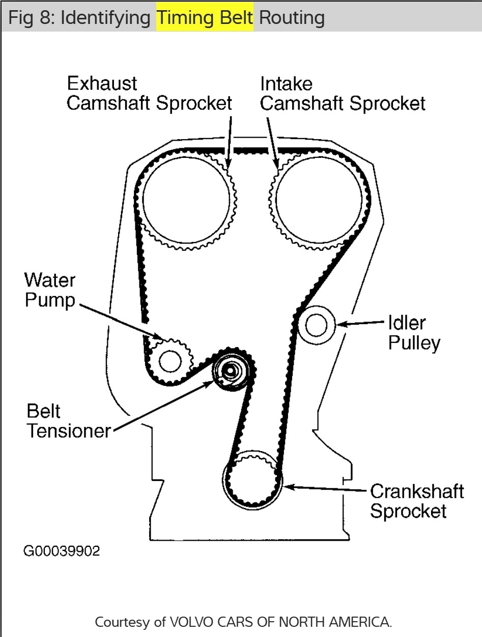

It sounds to me like it might be slightly out of time. If it were me, I would take it back apart. You might have overlooked something. Don't worry it happens to the best of us. It's frustrating I know but you have to check everything.

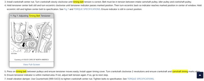

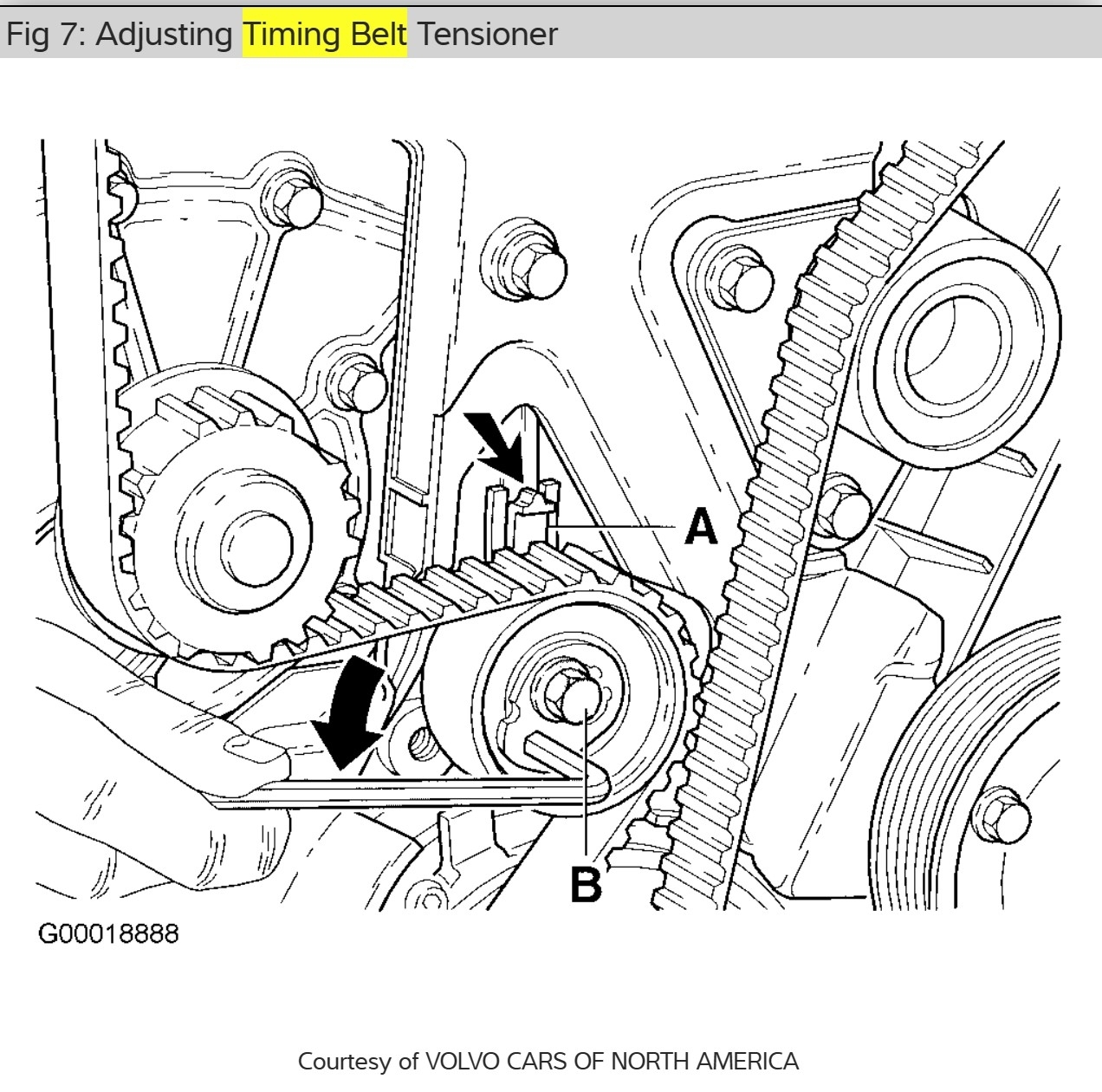

I am adding the installation procedure for the timing belt as well as the torque specs and a couple of other illustrations that I think will be helpful for you.
I would go through it step by step and see what happened. Sounds like it just needs to be adjusted.

I got it running. Thank you. I had the tensioner set wrong. But now I'm having misfiring issues. Cylinder 1 at startup, cylinder 4 comes and goes but cylinder 5 is consistent. Any suggestions?

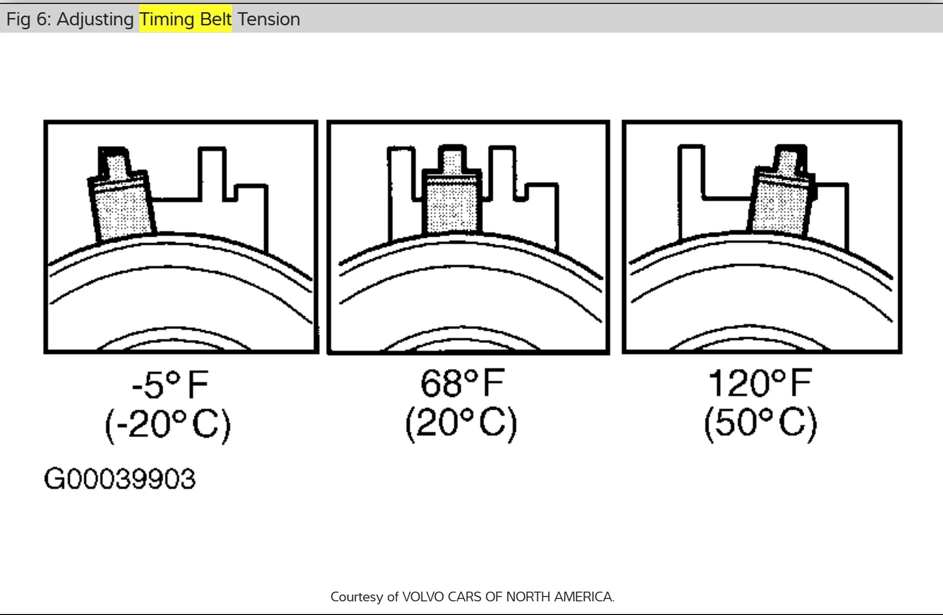

Thats awesome glad to hear it and you're welcome. My thought is you are still slightly out of time but getting closer. I would try adjusting the tension just slightly more and see what changes.
The temperature of the belt matters when adjusting it so if you are working in the cold you should need to move it less than if it were at room temperature.
I would say you are very close but need to adjust a little more and see what that does. Sounds like you are losing compression because one of the valves are open slightly.

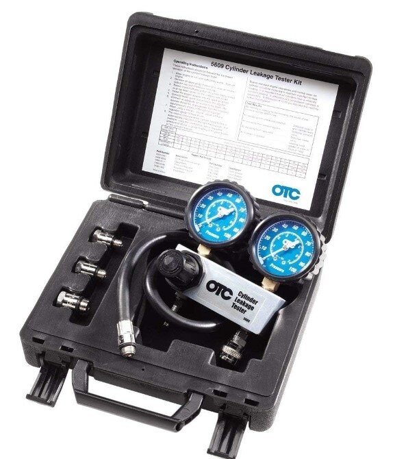

In this case you should put each cylinder at TDC on the compression stroke and put compressed air into the cylinder and listen to the intake to see if is coming through there if not try to listen and see if it is coming from the exhaust. This is referred to as a leak down test. There is a tester you can get to help perform this test. I will add an image for you of this tester. The brand OTC is a good, decently priced brand that I recommend.
Here is the link:
https://www.amazon.com/OTC-5609-Cylinder-Leakage-Tester/dp/B0030EVL60/ref=asc_df_B0030EVL60?tag=bingshoppinga-20&linkCode=df0&hvadid=79920806880888&hvnetw=o&hvqmt=e&hvbmt=be&hvdev=c&hvlocint=&hvlocphy=&hvtargid=pla-4583520382784329&psc=1

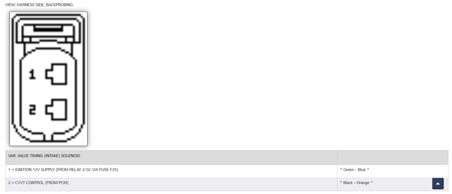

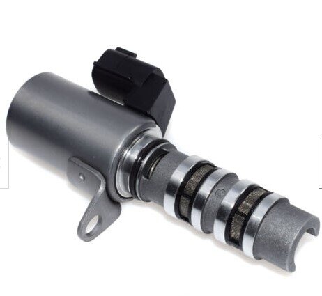

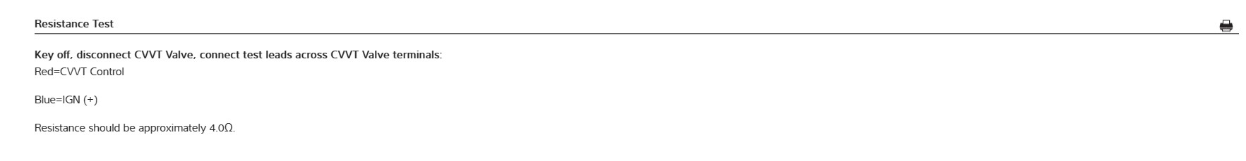

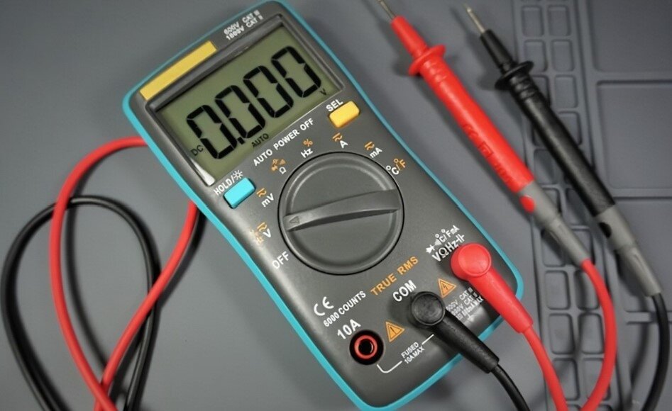

Looks like there is a Variable Valve Timing solenoid on the intake side under the top timing cover. I suspect you might hear the air through the intake. But let's see.
See if you can test the resistance of this solenoid as well. I am sending the test over to you.
