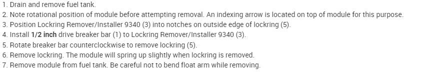

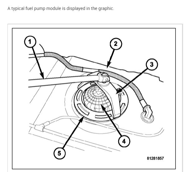

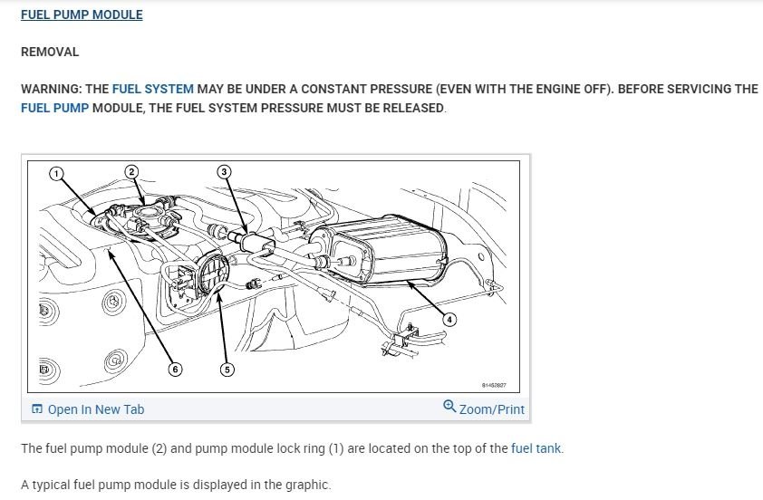

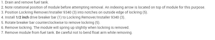

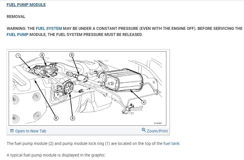

Good afternoon,
You need a pressure gauge to measure the actual pressure to be sure it is good.
It sounds like the new pump has failed. There is no adjustment for the pressures at all.
The correct fuel pressure is 400 kPa ± 34 kPa (58 psi ± 5 psi).
https://www.2carpros.com/articles/how-to-replace-an-electric-fuel-pump
Let me know if you have any other questions.
