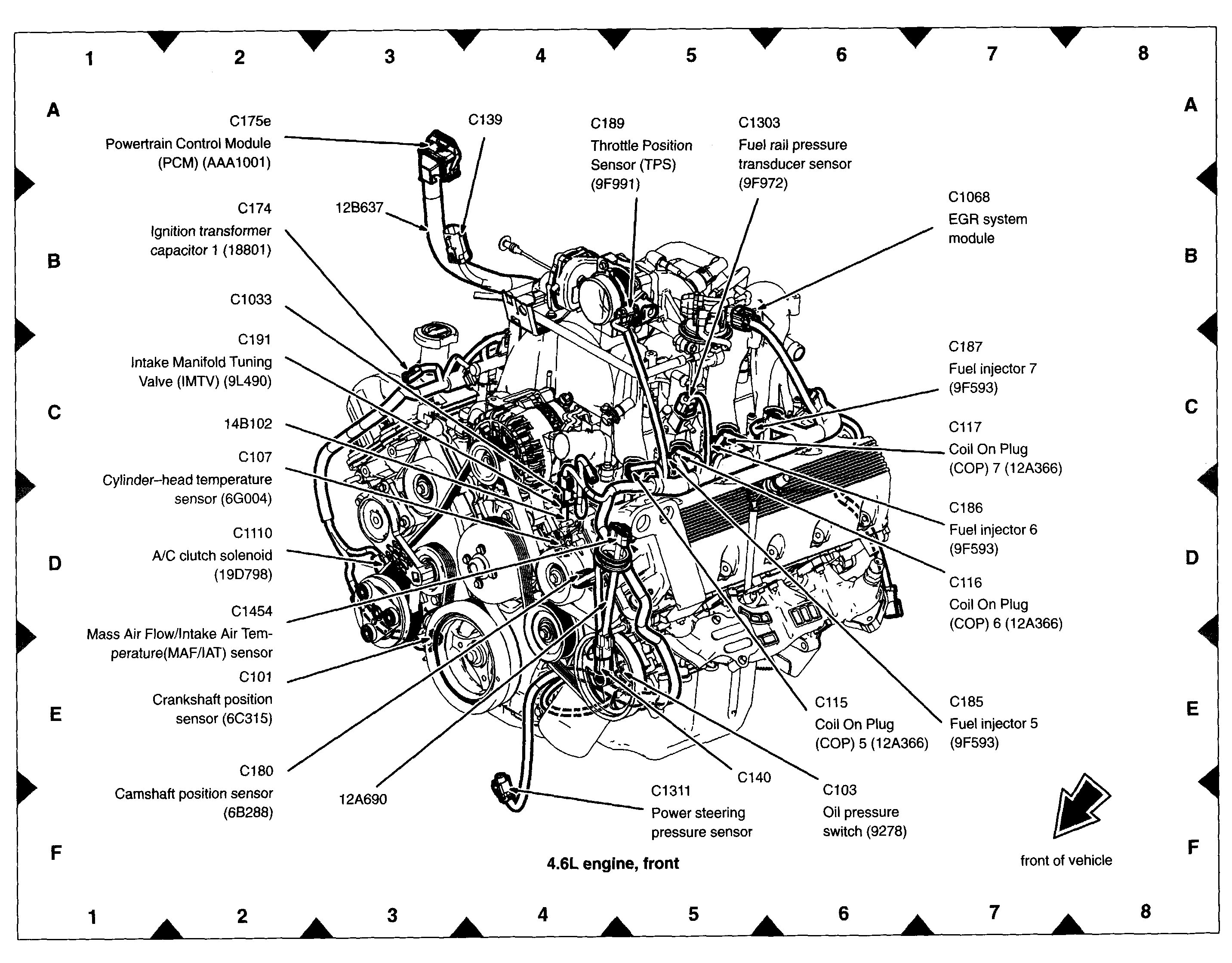

I had a problem with the starter, so I changed it. Cranks over. Then it shut off on me on the road. I hauled it back home and found that it was getting spark but no fuel. Fuel pump was bad so I changed it. Also put in a new fuel pump driver module and fuel filter. Dropped the tank and cleaned it. New battery, new alternator. No schrader valve so I pulled the fuel line to the fuel rail and I am getting fuel to the rail. Hooked up OBD scanner and it will not link. Tested power and ground to the port and they are good. Will crank but not start. Sprayed starter fluid into throttle body and it started for a second and shut off. Thinking maybe the PCM? I am going to test the injectors for power tomorrow. I know I am getting fuel to the rail and I know I am getting spark. Any ideas?
Aug 22, 2018 at 2:37 PM
  • 110,248 POSTS
I was wondering if the injectors are getting power. Also, have you checked the camshaft position sensors? They are what tells the PCM to fire the injectors. I attached a picture of their locations on the engine.
Let me know your results.

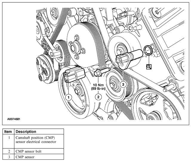

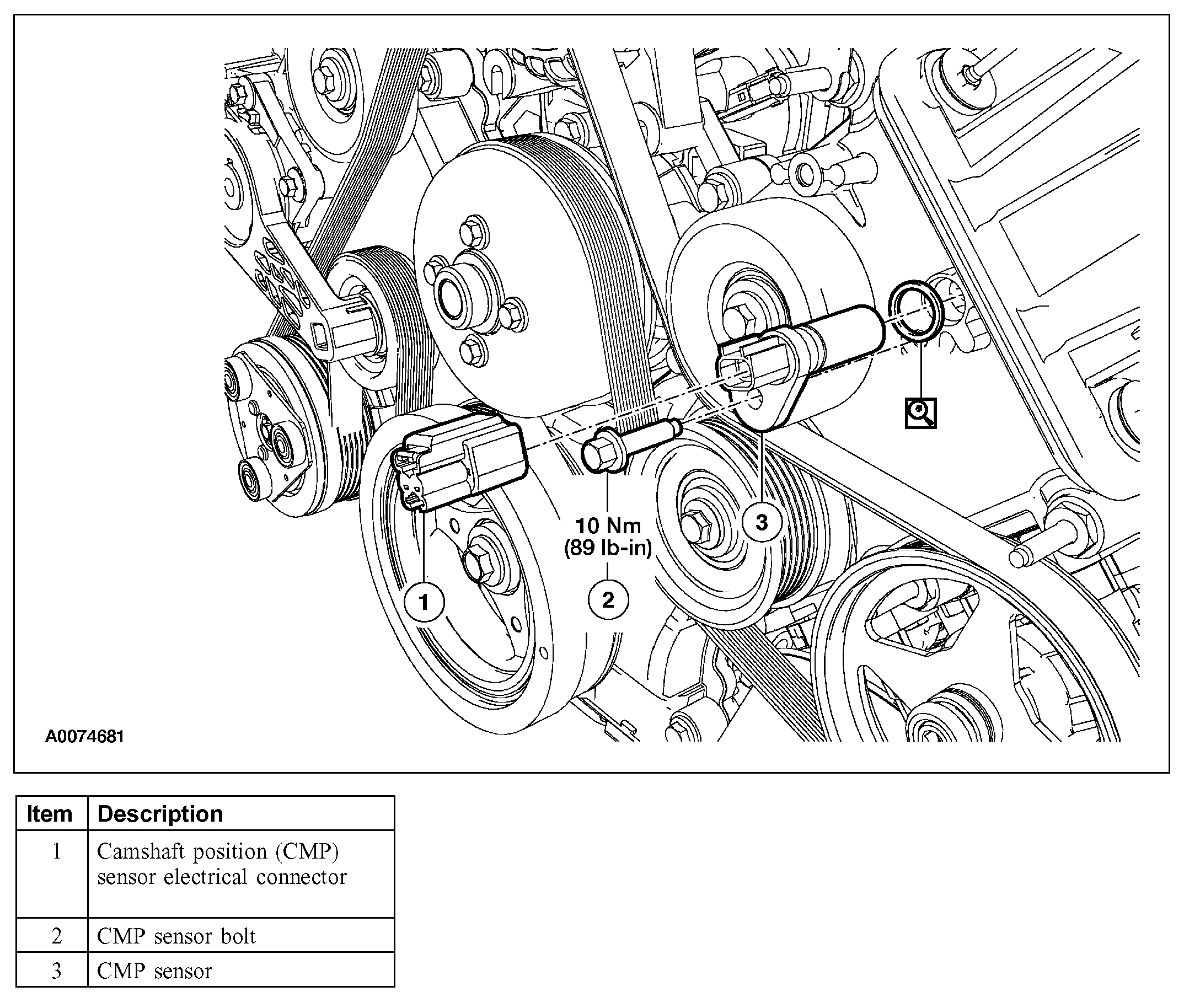

Here is a general link for replacing a cam sensor
https://www.2carpros.com/articles/camshaft-angle-sensor-replacement
Here are the directions specific to your vehicle for replacement of the sensor. The attached picture shows its location and the sequence of removing it. If you check the injectors and they are working, the cam sensor is not the issue.
