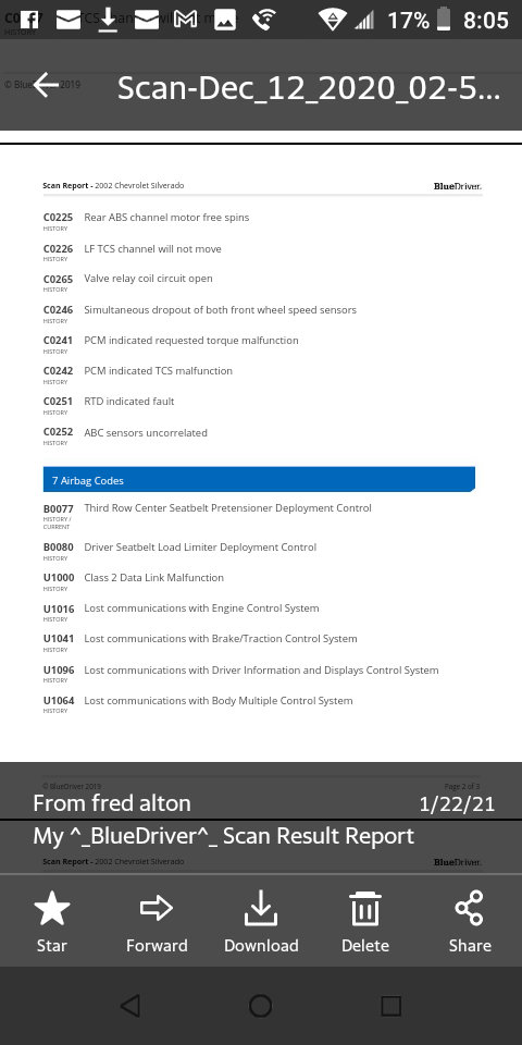

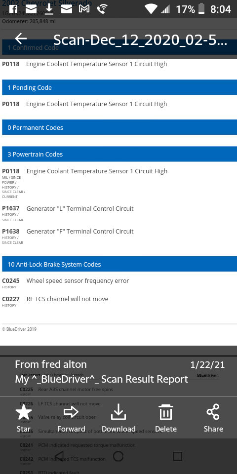

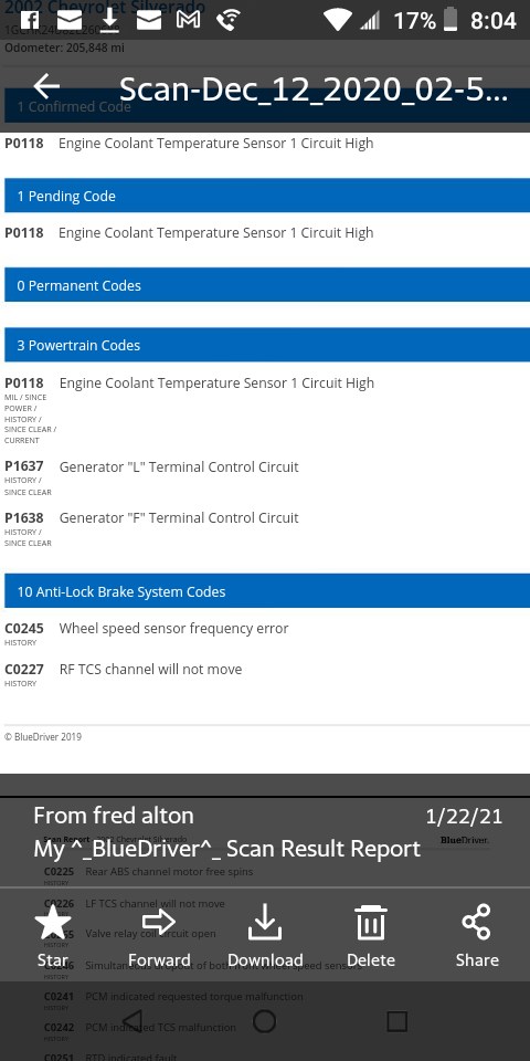

New wires plugs, fuel pump filter, injectors, temperature sensor, crank sensor, fuel filter, exhaust manifold gaskets and fuel filler neck. getting ready to replace ignition switch. security code is voltage to high and voltage too low.

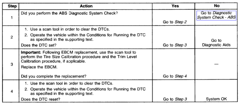

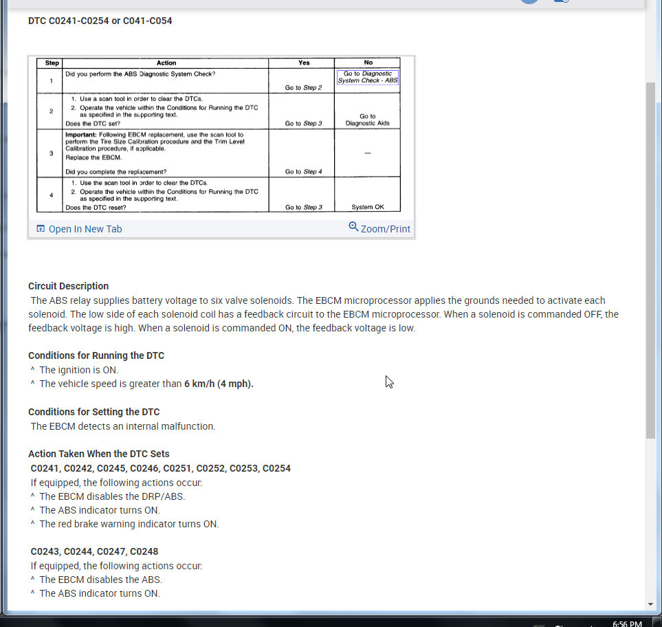

Looks like you have a couple issues. Just looking at some of the C codes and a few of them are pointing to an internal failure of the Electronic Brake Control Module. Unfortunately the only fix for this is to replace it. I attached the info for this below.
However, this will not cause the engine to not start. So we need to find out if we have spark so, we need to pull a plug and hold it against the block and see if there is spark.

As for the other codes like the ECT circuit high, that would not prevent the start either.
