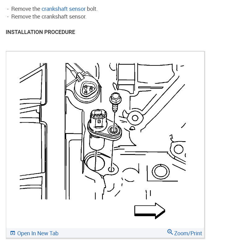

If you get in the car push the brake and hit the start button it turns over normal, but it won't hit at all. If you push the gas pedal all the way to the floor and try to start it, it acts like it wants to start but never does. I've put a new MAF sensor, a new crankshaft sensor, fuel filter/pressure regulator, I've checked the fuel pressure it's good, I've checked all the fuses they're good, I've checked the ground wires they're good and I've lost sleep over this because I can't figure it out it'll be the first vehicle that I have had to go and ask somebody else for help. Please help me!

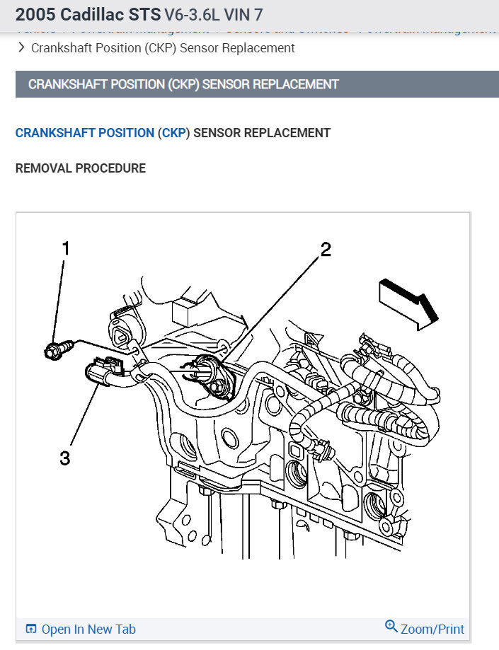

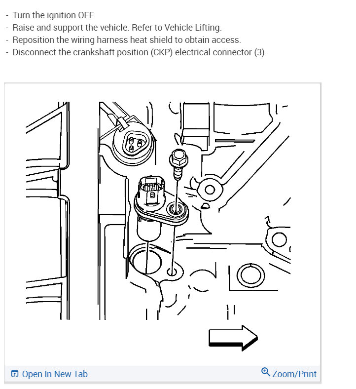

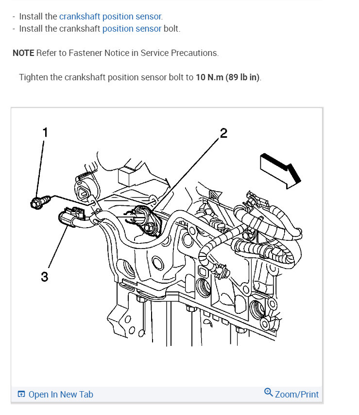

To me it sounds like the crankshaft angle sensor has gone out here is the location so you can swap it out if needed. Check out the images (below). Let us know what happens and please upload pictures or videos of the problem so we can see what's going on.

I've already replaced that part. It has spark.
