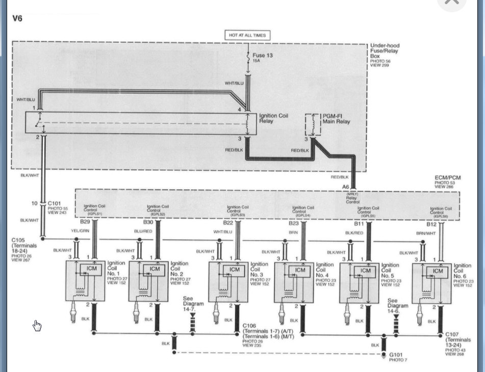

9) At this point I began to test all fuses after new relays and sparks. Fuse #8 in the driver side compartment doesn't have power with key in on position.
What would cause this? Is the the true cause of my new cars no start issue? The fuse is fine even replaced with new.. no power to test light when touching terminal contacts. Every other fuse is fine.
is it the back up Main FI Relay causing this? Or is there a wiring diagram where i can trace the fuse port back to a wire/relay?

We need to back up and find out if we have spark at the plugs. You said you tested the coils and they are good but after changing the plugs it didn't work.
So do you have spark at the plugs? Pull one out and hold it against the block and crank the engine to see if it sparks.
https://youtu.be/dCjmRL3p4Cs
If we have no spark then we can start tracking it through the system to see what is missing but since you have coil on plug we are going to have the check the voltage on the two wires at the coil. I suspect you will have 12 volts but the control wire will not be firing the coils. If that is the case then the ECM may be the issue based on what you have replaced so far. But at least we will know why you are not getting spark at that point. However, if you don't have 12 volts on the black white wire then we have a fuse 13 or coil relay issue.
Below is the wiring diagram that will help with this.

Let me clarify. I checked the spark - it was there but the plugs were terrible, I replaced the plugs with new properly gapped ones. Still have spark. Still crank no start.

@Kenny For the PCM/ECM being the issue, wouldn't my scanner have issues connecting?It doesn't - I have no codes.
Mar 31, 2021 at 10:25 AM
Okay. If you have spark and starter fluid does not get the engine to start then compression would be the next logical thing.
As for having codes, not necessarily. It may set some but depending on the failure it may not know that it is causing the issue so it doesn't set the codes.
Let us know what the compression is and we an go from there. Thanks
