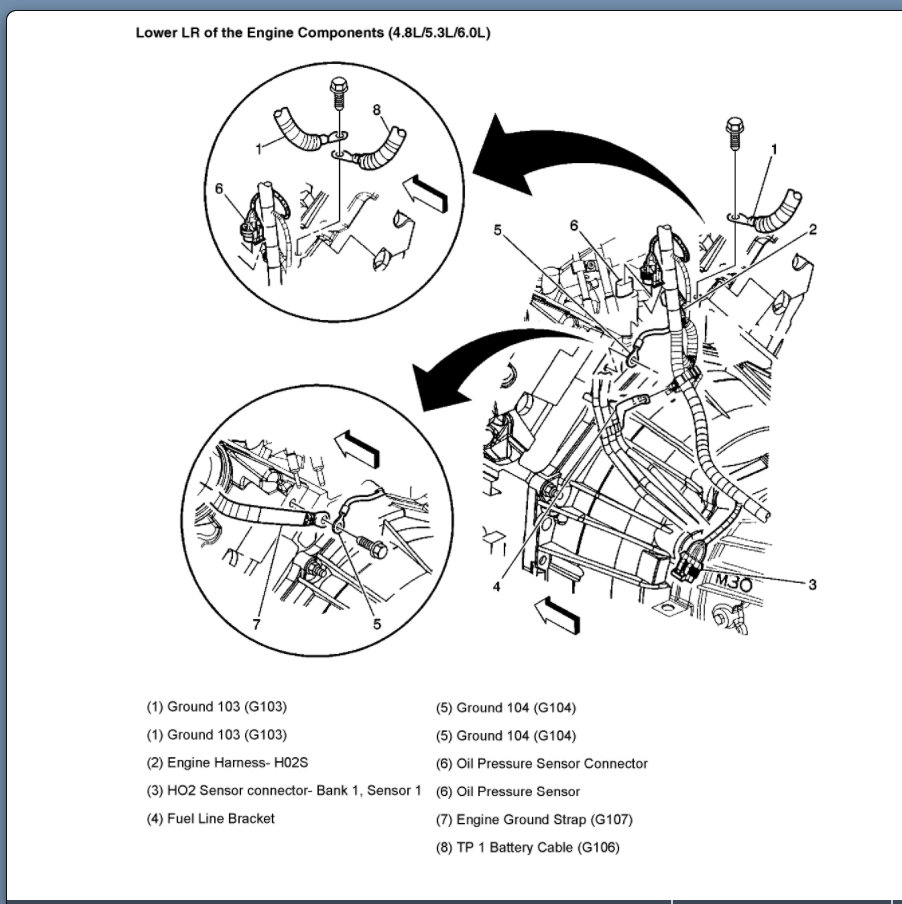

It's the ground I believe for ECM there are two ground wires at back of motor the one on pass it's a black with a stripe. Can you show me we're the Ground wires go in simpler form please?
Nov 6, 2021 at 6:37 AM

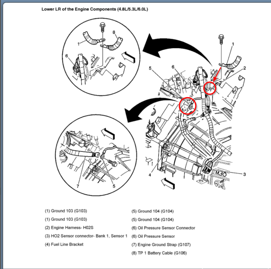

Okay. If this is for the PCM then that will explain a lot. This would make it G103 or G104. Take a look at this picture and see if that helps.
Nov 6, 2021 at 8:17 AM
JDOGGGG
  • 5 POSTS
Okay. so, ground wire from batt goes to back of head driver side with one ground wire then the other goes were. Also these have to go in said place?
Nov 6, 2021 at 8:37 AM
These do not go in the same place but that doesn't matter as long as it is a good ground location. What I would do is pick a location that you want to use and then measure the resistance between that and the ground post of the battery. If the main ground cable is connected to the battery and the engine, then the entire engine block becomes a good ground location as it is all highly conductive metal. So, you should have little to no resistance when checking the resistance through the ground side.
If you do then that is not a good ground, and you should either figure out why or pick another one.
What I would do if you are struggling to find a good ground is just route the wire back to the negative battery post. No matter what, all ground locations are trying to get back to the negative battery post as this is the final destination for all electrical circuits. Electrical circuits must be a complete circle in order to operate and the fact that they all start from the battery means they must end at the battery. The fact that the frame and drivetrain are metal is just a way that they can keep from routing wires all around the vehicle and back to the battery.
