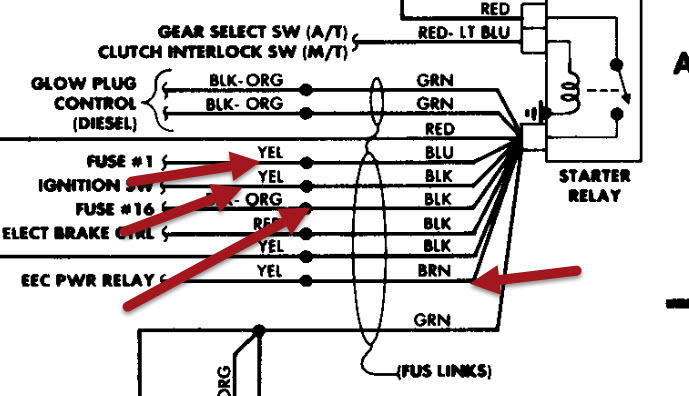

The truck would not start after parking from a short 15 minute drive. When the key was turned to on, the usual 1-2 second fuel pump prime did not happen. I checked the fuel rail and there was no pressure at the Schrader valve. I checked the fuses – all good. After checking anything else I could with limited tools in a Home Depot parking lot, I tried once more to start it and heard the fuel pump prime! It started hesitantly but leveled off and I was able to get it back home and parked. Immediately after turning the engine off, I tried to start it again with no luck.
It’s been a few weeks of troubleshooting when I can after work but I’ve reached a point where I’m not sure what to check anymore. The ECM was replaced about 10 months ago with a refurbished from a reputable auto parts store (not the Zone or Reilly’s) due to moisture corrosion on the original. It ran fine for months after replacing with the refurb and I did my homework to make sure the replacement was an exact match for my truck, so I don’t think the issue is an incorrect ECM.
I ran an EEC-IV self-test and got:
Code 11 – System Pass
Code 95 – Fuel Pump secondary circuit failure – PCM to GROUND
What’s been done/other tests
-Replaced Fuel pump relay
-Tested EEC relay (passed)
-Tested Fuel Pump by jumping with 12v (passed)
-No power on either side of inertia switch with key on (12v show for under 1 sec with initial key on but no fuel pump noise)
-When fuel pump pins are jumped on the self-test harness, 12v on both sides of inertia switch with key on and while cranking, but no fuel pump noise and no pressure at rail
-Checked all wiring and ground locations and everything looks okay
-Looked inside ECM and no signs of moisture or burned components

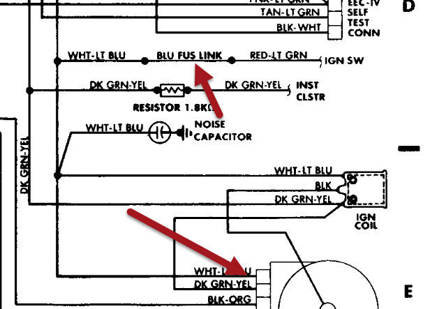

Check the fusible links and ground to the pcm it's agreen/blk wire. The other are in pics. Easiest way is to see if dist has 12 volts on the wire pointed out that will tell you if fusible link in that pic is ok. Then check others and twirl them around as it may only be one strand holding it.
