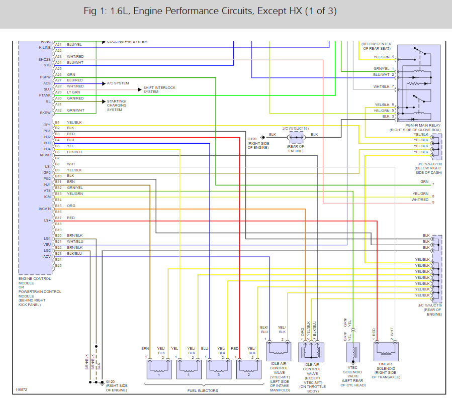

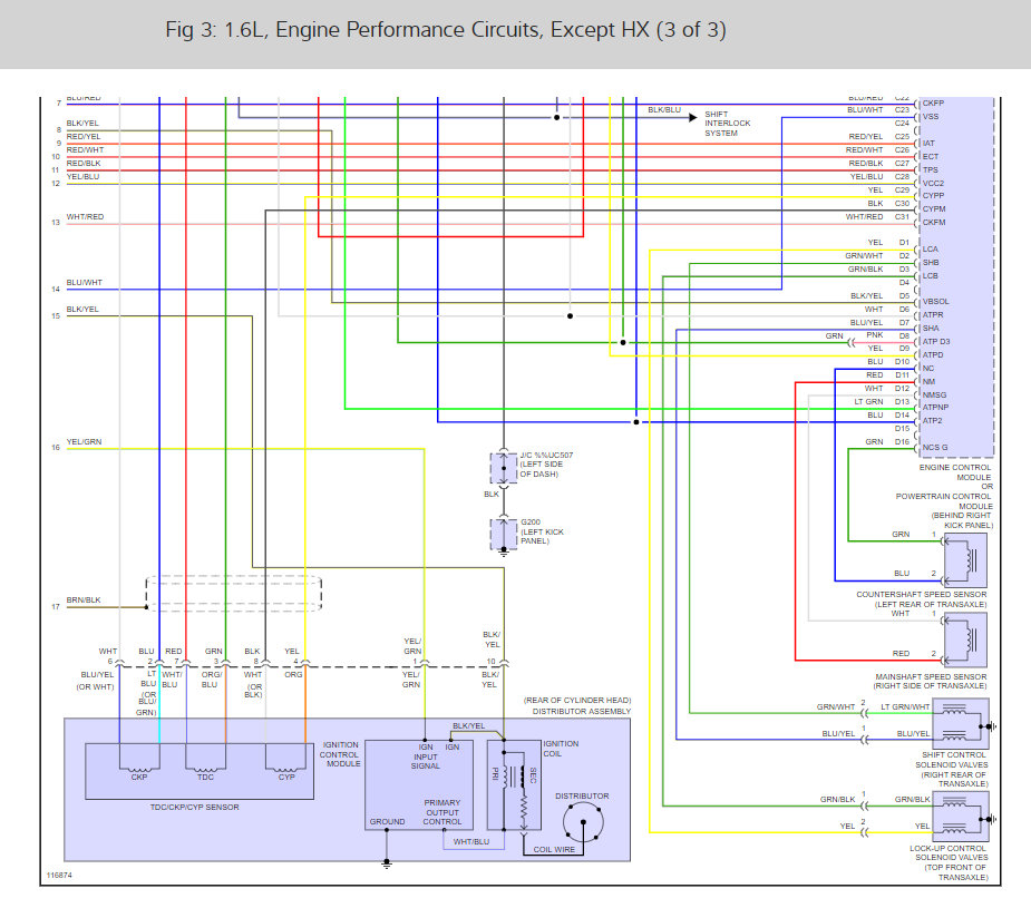

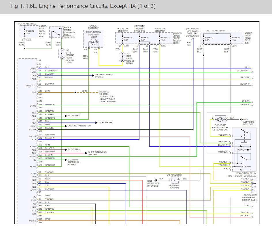

The car just shut off after I put plugs in timing it and it just turned off like I shut the key off. Ever since then it will crank but no power to the distributor. I replaced the relay under the dash behind the glove box controls the fuel pump and the distributor. There is no power to the coil part of the distributor. We have traced the wiring harness from the computer to the relay to the distributor.
Jul 11, 2018 at 10:34 AM
  • 55,710 POSTS

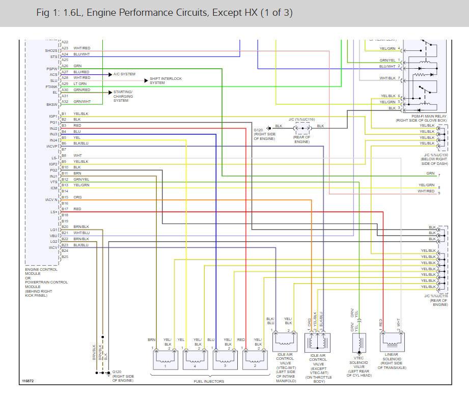

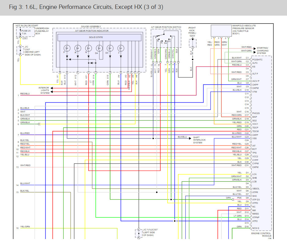

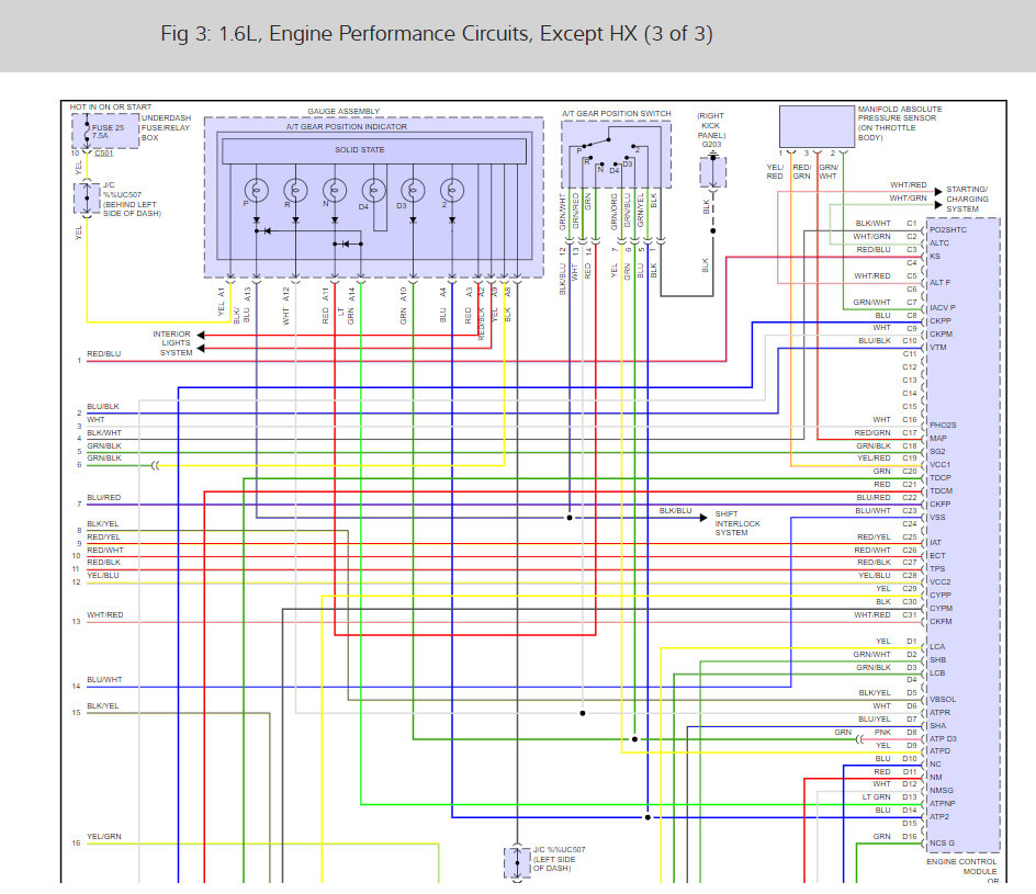

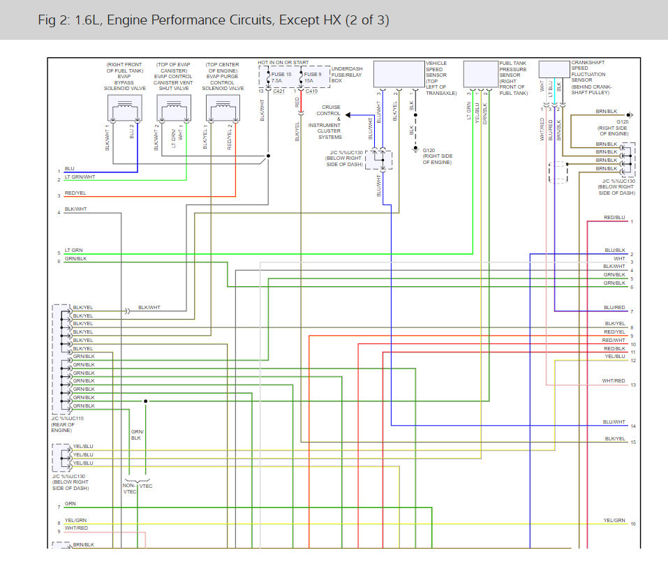

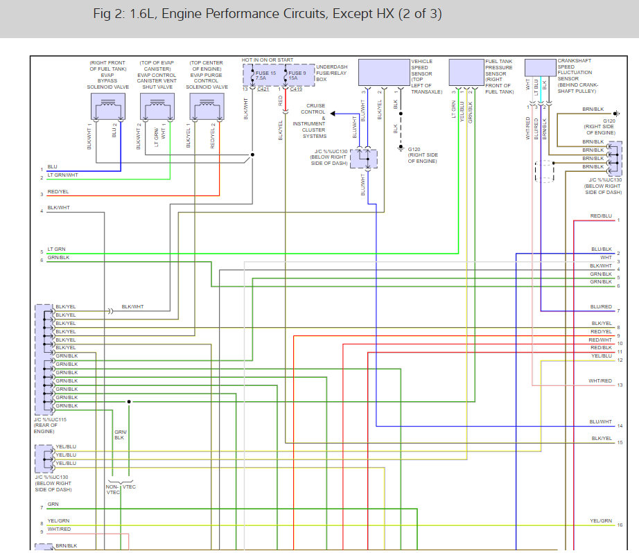

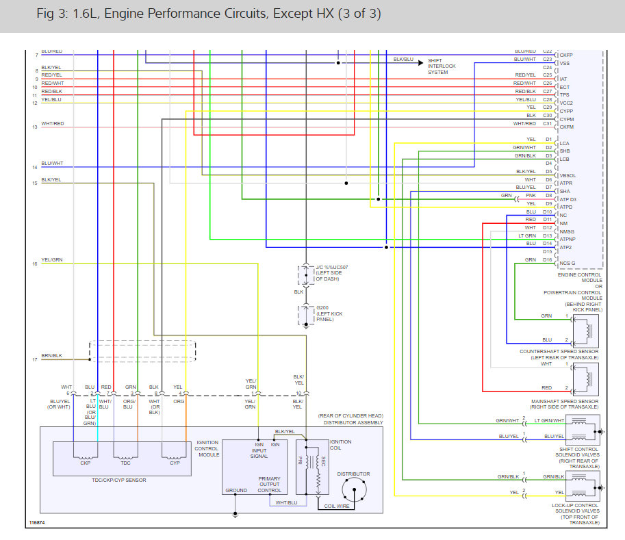

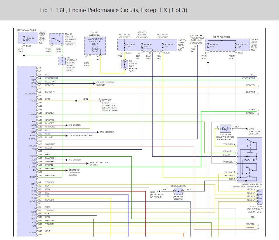

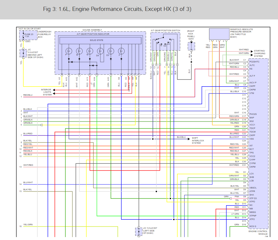

When you say relay you mean the PGM FI relay? We are losing power somewhere. Here is a guide and the engine wiring diagrams so you can test to see where the power loss occurs:
Check out the diagrams (below). Please run some tests and get back to us.

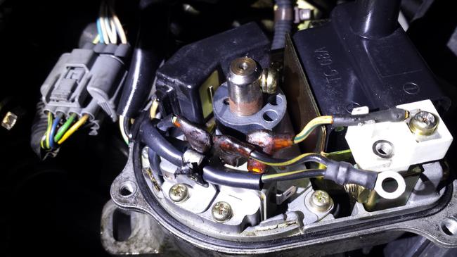

The engine shut off while driving (no restart) and that lead to my diagnosis that coil failed (no spark, ohms out of spec, casing shows sign of arcing/heat damage). After replacing the coil and spark plugs, I realize I hadn't taken a pic of the wire connections within the distributor and didn't have them in correct location (no start). I then realized I had more available connectors on the ICM than wires to attach. I located a wiring diagram and the unattached connector is the stand alone on the ICM (closest to the coil). A wiring diagram shows that to be the 'blue' wire for RPM indicator (but is that correct?). Pix/diagrams seen online show that blue wire is in a 2-wire black insulator with the black/yellow wire (power). I have no blue wire.. and it's not broken off and within insulator. I can't find a blue wire inside the distributor at all..
So is there a wire that should be attached to that stand alone tab on ICM and why isn't it there in insulated wrap ('harness') with power wire for coil ready for me to snap on...
This isn't my first time under the hood..removed heads for valve job -and that was 35 yrs ago. But I admit I'm looking silly with this Magic disappearing wire act.
Pic 1 Shows distributor wired as best guess and the unattached tab on ICM just below center of pic. (distributor mounted)
Pic 2 Show more wiring detail. Wire disconnected from coil + terminal. (distributor dismounted)

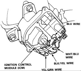

According to the diagram I attatched, the pair of black wires that have the eylet connector, should be attatched via a screw to the ceramic heat sink directly below them, everything else looks correct, but the initial problem sounds more like a failed ICM, if you are able to get all the wiring corrected, and it still wont start, even with a new coil, you might suspect the ICM as the culprit. Check out the diagrams (Below). Please let us know if you need anything else to get the problem fixed.

Ok I see what you mean, there should be a blue wire coming out of the sheath to go onto the side ICM tab....
