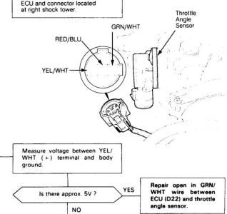

I have a 92 civic hatchback and i need to know what wire on the tps is the output voltage wire the left wire is yellow the middle is green and the right is red

Hi loudcvc98, The wire colors that you provided is different from what I have from our database.
https://images.2carpros.com/forum/automotive_pictures/192750_TPSWire92Civic_1.jpg
