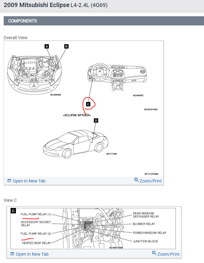

Hi, the shifter light went off beside releasing alarm of the door. all fuses Checked. help please. when connect the obd I receive no connection or respond although there is 12volt in it.

When you turn on the key can you hear the fuel pump?
In operative fuel pump can be due to a faulty relay, wiring issue or a bad pump.
This vehicle has two fuel pump relays. They are located in the fuse box under the driver side dash (see diagram below).
Check for any corrosion or burnt pin(s).

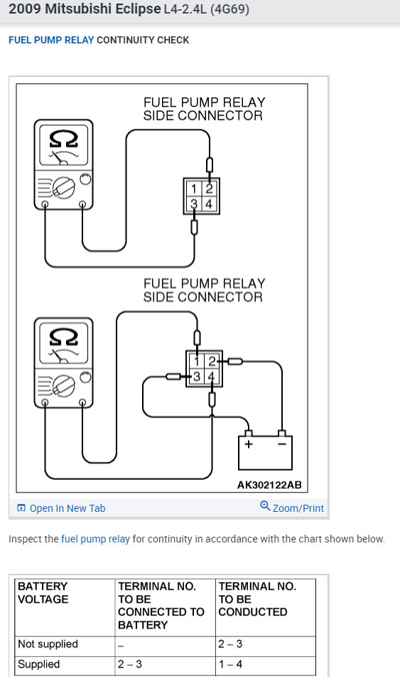

The relay can also be tested.
