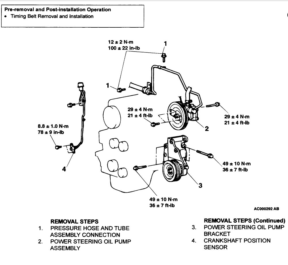

My car runs great always but when I drive some place and shut it off, it turns over but will not start. There is a code that says something about the cam shaft sensor but all the stuff I have been reading, if it is that, I would be having other problems also and I have no other problems. Any ideas?

That sounds exactly what your describing as a crank sensor car will run good when cold but when hot it quits or will not restart. What happens is when the wire on the crank sensor is cold it is expanded so let's car start when car gets hot the wire becomes hot.

Here is a guide and diagram (below) that will give you an idea for what you are in for when replacing the sensor.
