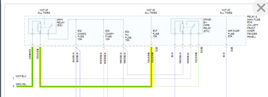

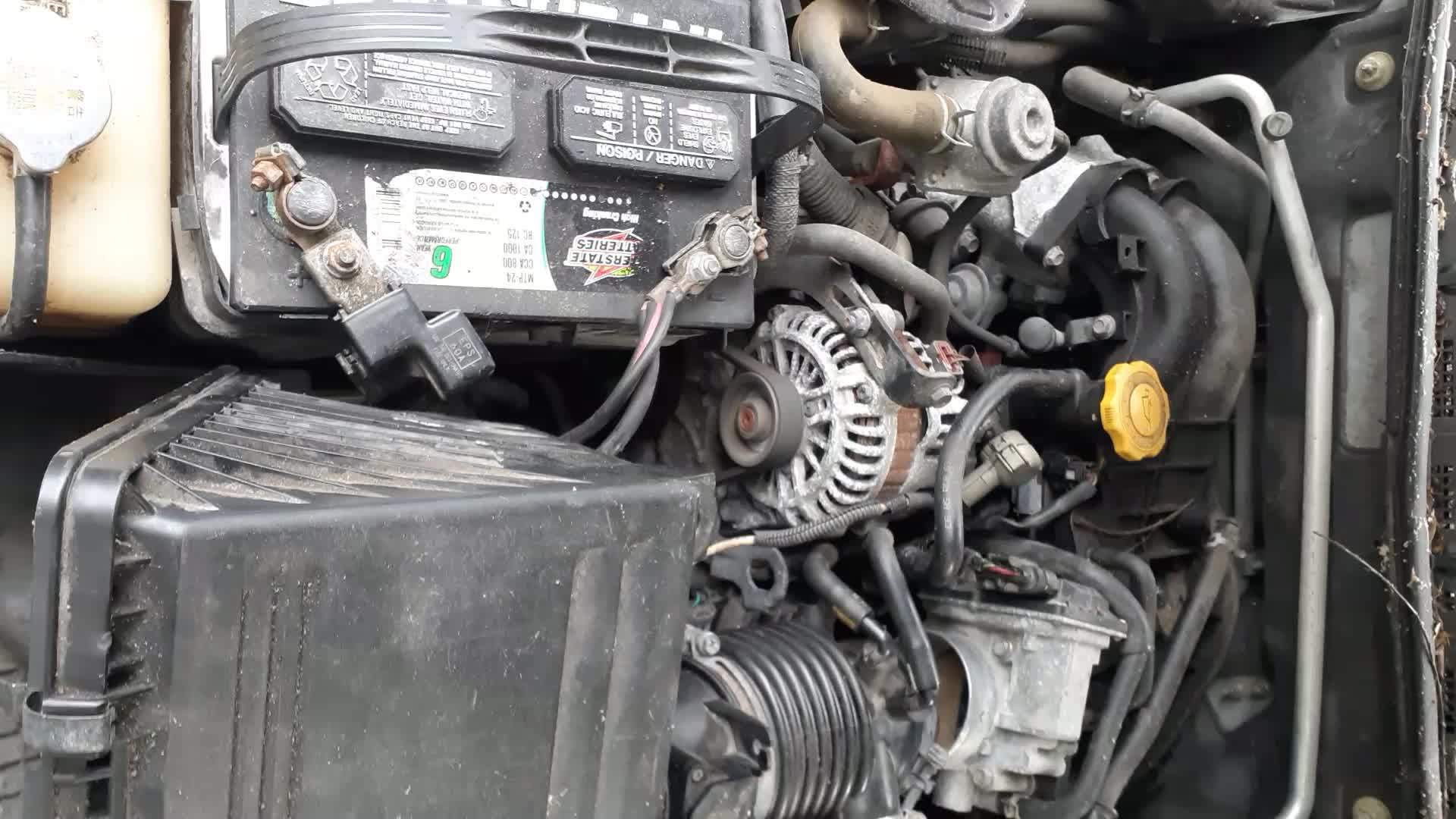

Replaced coil pack, plugs, wires. When I plug into obd port, says unable to communicate with PCM. Not real sure what's going on. Just bought it, and want to get it running.

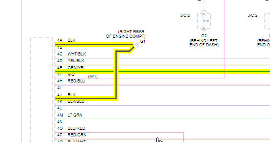

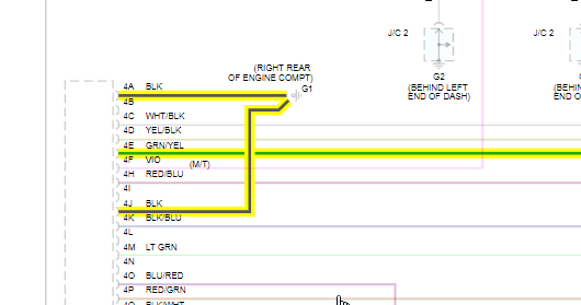

We can assume that the reason you can't communicate with the PCM is the same reason the engine won't start. This could be as simple as the PCM is faulty or the power and ground to the PCM is faulty. So we need to check power on the green/yellow wire and the grounds that are highlighted in the diagrams. If you have no power at the PCM with the key on then the main relay and fuse feeding the relay need to be checked.
Let us know what you find here and we can go from there. Thanks

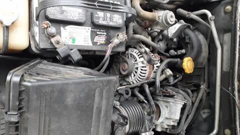

Here's a video of it.

The man who owns it, said he was driving like normal, shut it off at home then all it did was what is showed in the video. I'm really wanting to buy it, because it only has 80,000 to 90,000 miles on it and figure it may be something simple.

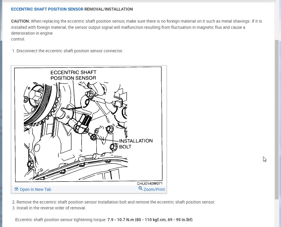

Bought a code reader, it popped up as crankshaft position sensor, the man I bought it from had put a new one on it, still won't fire up. I'm thinking that he didn't put it back in the right position, but I have no clue where it should be positioned.

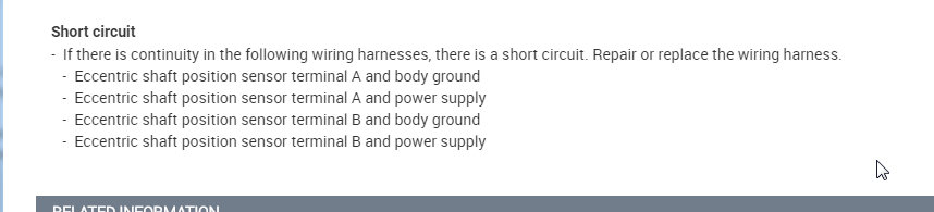

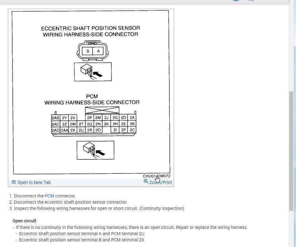

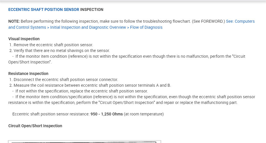

I attached the info on this sensor and the process to replace it. I doubt the installation was wrong unless they just didn't tighten it. However, it should be checked. Then I put the testing there for this sensor.
Can you provide me the actual code that you are getting and I will give you the testing for that code? I suspect you have a wiring issue or control module issue. Thanks
