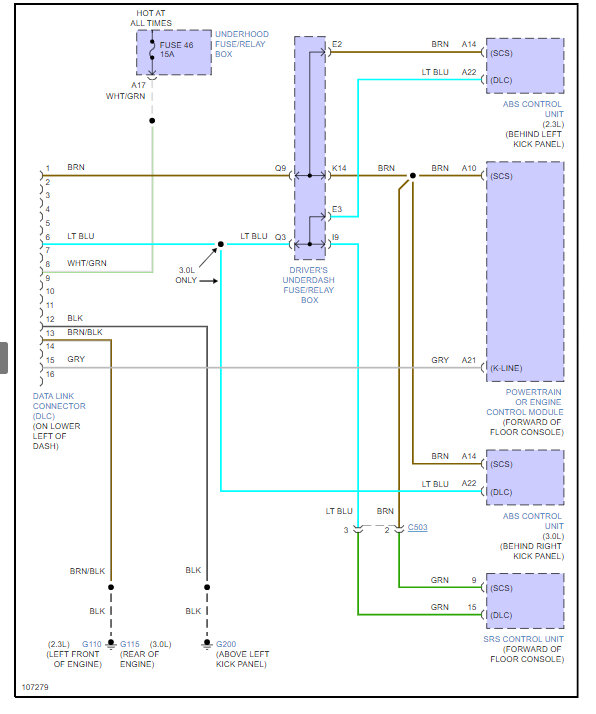

It was helpful in allowing me to identify that my OBD II port is not getting power. Although my vehicle is also having different issue(s).
The car will crank, and crank, but no fire. There is no Schrader valve on the fuel rail so I can't check for fuel pressure, but additionally none of the dash lights will come on, the turn signals do not work (hazards do I presume that is a dedicated circuit?), and the windows (power) will only function if the vehicle is cranking not with the key in the "on, or accessory" position.
This leads me to believe that it is something deeper seated than just possibly a fuel pump issue, and it is something electrical. I am just curious if you might have some insight.

Sure, this guide can help:
https://www.2carpros.com/articles/comprehensive-guide-troubleshooting-your-automotive-obd2-diagnostic-port
I would check to see if the port is getting power and ground here is a guide to help and the OBD2 port wiring diagrams so you can see how it works:
Make sure you have power to fuse # 46 in the under-hood fuse panel. Check out the images (below). Please let us know what happens.
