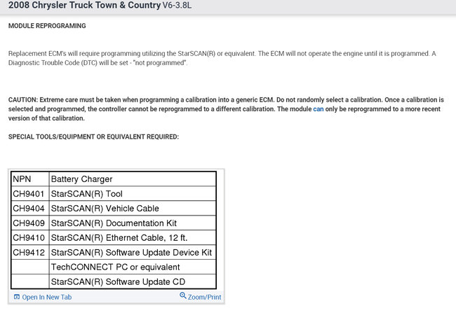

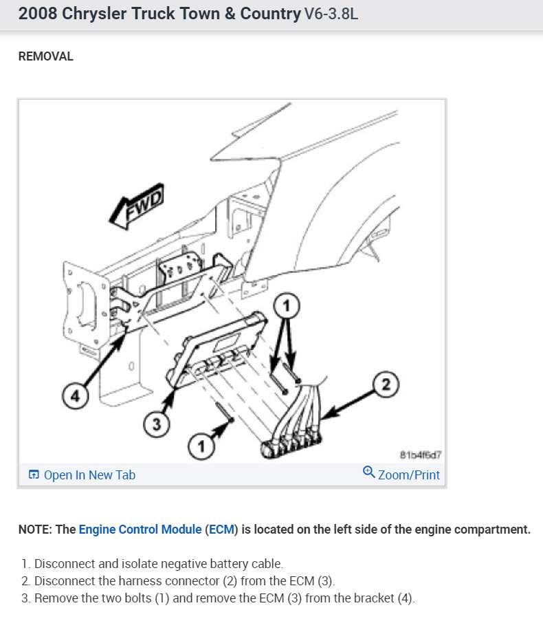

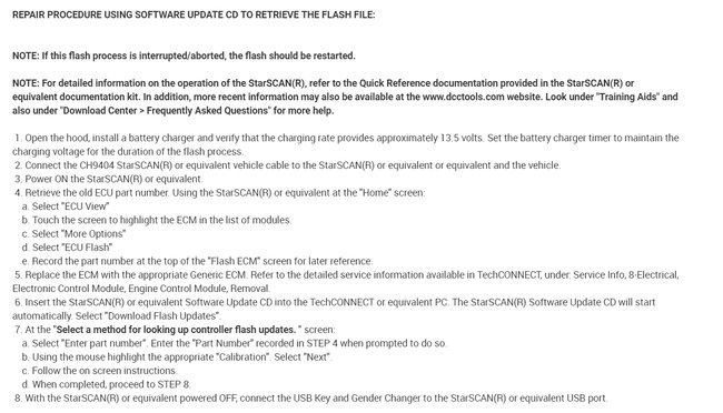

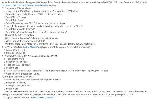

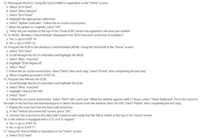

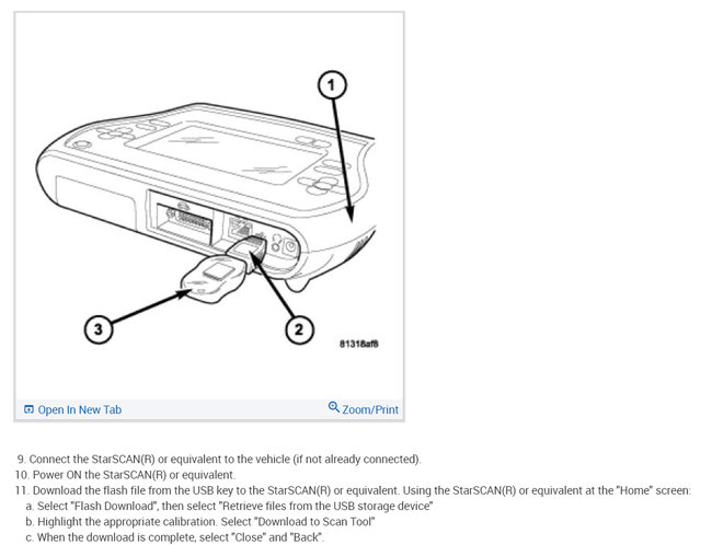

hmm, it should be 12 volts. it sounds like the PCM has gone out. To be sure lets do a CAN scan which is the future of automotive repair. you can get a CAN scanner from Amazon for about $50.00. here is a video to show you how:
https://youtu.be/InIlnsjOVFA
Here is the location of the PCM and replacement instructions I would check the electrical connector for corrosion. Check out the diagrams (below). Let us know what happens and please upload pictures or videos of the problem.
