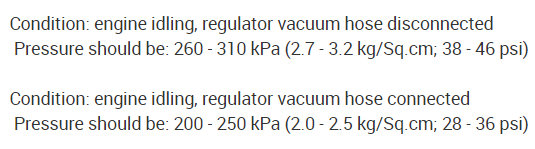

I've attached a picture below showing the fuel pressure specifications for your Honda.Hope this helps and thanks for using 2CarPros.

Don't I need the car to idle for this test? I can't do that since the car doesn't start.

I checked the fuel pressure when the pump primed, it goes to about 30 PSI (second try it went up to 40 PSI) then it drops down to about 5 PSI, then 1 PSI and stays there for like 30 seconds to 1 minute then goes to 0 PSI. Is it supposed to go down to 0 or was it supposed to hold some pressure still?

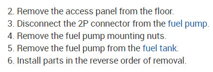

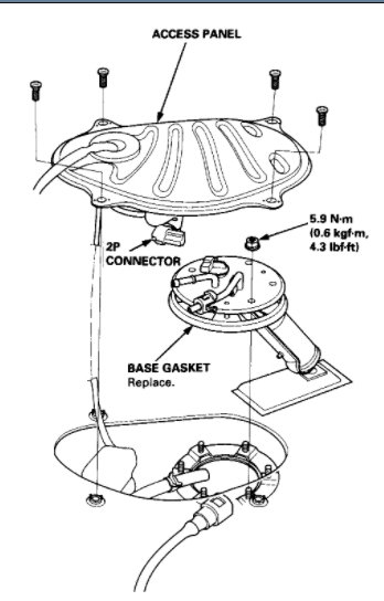

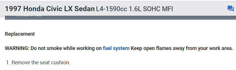

It sounds like the fuel pump is failing.The fuel pressure needs to always stay constant.It should not drop at all.I would suggest replacing the fuel pump.It is an in-tank pump and I will attach the repair steps below.Here is a tutorial showing what is involved:
https://www.2carpros.com/articles/how-to-replace-an-electric-fuel-pump
