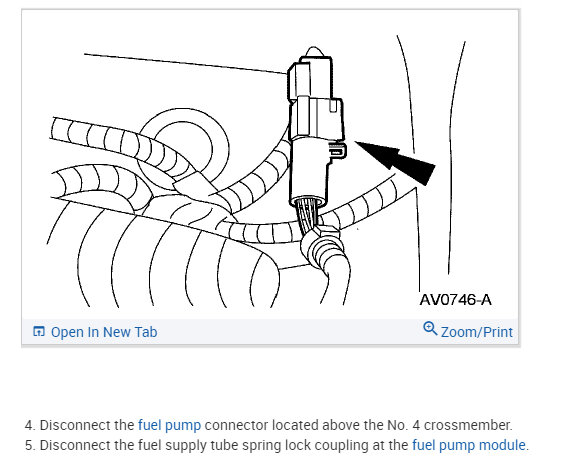

Car sits more than it’s driven. Replaced fuel filter, fuel pump driver module, has plenty of fuel in tank. Runs when starting fluid is sprayed in air box tube, then shuts off.
Was running slightly rough when started a few times over the past few weeks, but then went away after about 5 -10 minutes or so.
My scanner shows the following codes.
PO 191 fuel rail pressure sensor A circuit/range performance.
As well as.
PO 191 fuel rail pressure sensor A circuit range performance (pending).
Thank you for your help.

We need to focus on the fuel rail code. A pending code is a little different. Pending codes are typically generated when the vehicle's onboard systems detect a potential issue or anomaly but have not yet confirmed it as a persistent problem. They act as early warning signals for potential malfunctions that may develop into permanent trouble codes if the problem persists over a certain number of drive cycles.
The pending code, in this case, has become an active one already.

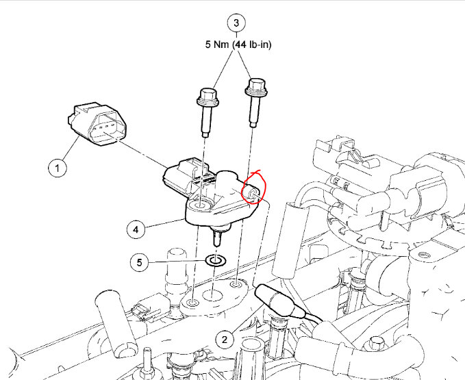

As far as the code, P0191, it can be caused by a few things. The sensor could be failing, there could be a fuel pressure issue, an engine vacuum leak can cause it or even low fuel.
When the vehicle is running, does it have a smooth idle? You mentioned it sits more than driven. Has it been a long time since it was driven?

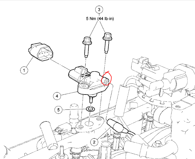

Let's do a couple basic checks. First, the sensor is located on the fuel rail. There will be a vacuum hose going to it. Check the line to make sure it is good and not cracked or disconnected. See pic 1
Next, check for engine vacuum leaks.
Here is a link that explains how it's done:
Let me know what you find. Also, when you check the vacuum hose at the sensor, make sure there is no evidence of fuel getting into it.
See pic below.

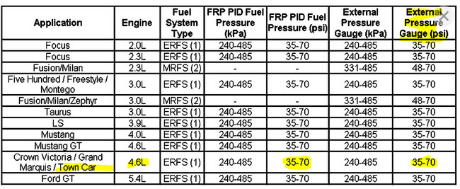

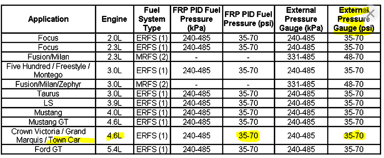

If it starts with starting fluid and then stalls, it isn't getting fuel. The first thing we need to check is fuel pressure. I have a feeling there is low or no pressure and that is what is setting the code. If that isn't the case, we will need to trace injector wiring which isn't difficult.
First, we need to check the fuel pressure.
https://www.2carpros.com/articles/radiator-pressure-test
You will need a fuel pressure gauge for this. If you don't have one, most parts stores will lend one to you.
Try this and let me know the results.
See pic below for the manufacturer's fuel pressure specifications.
Jul 10, 2023 at 2:06 PM

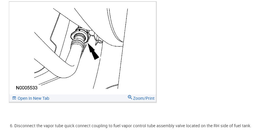

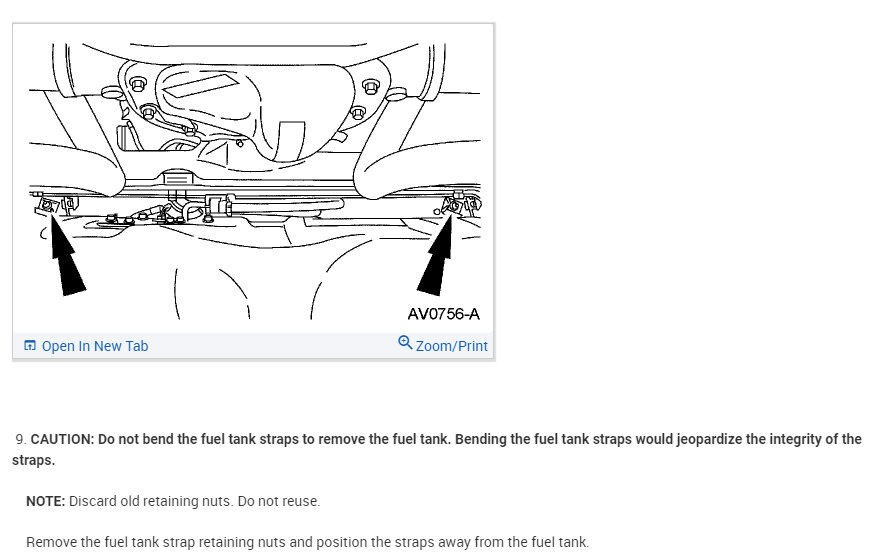

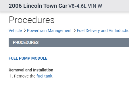

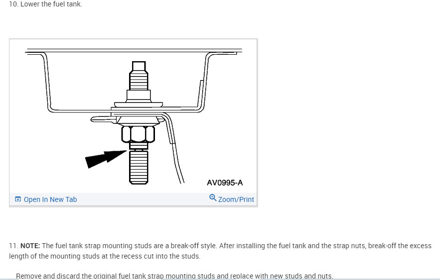

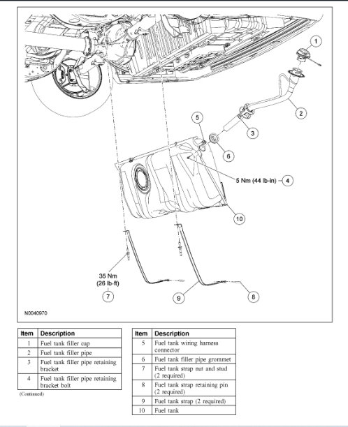

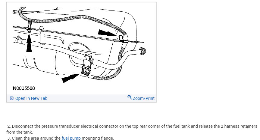

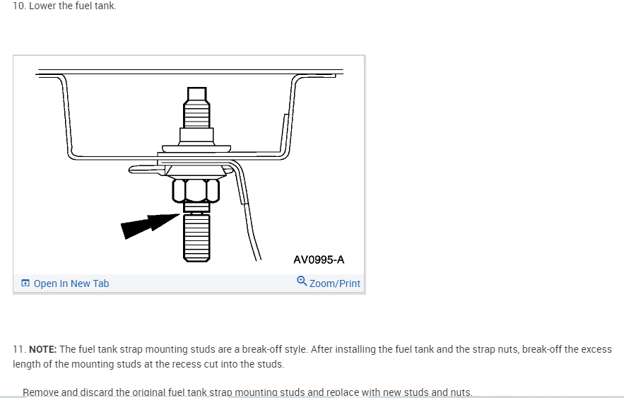

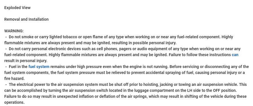

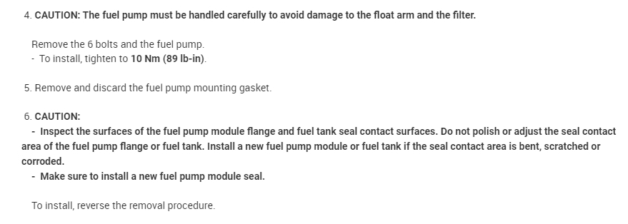

Hi Joe, would you be able to provide me with the correct procedure to replace the fuel pump/sending unit assembly? (I will be doing this on my driveway)
Thanks!
Jul 18, 2023 at 8:21 AM
  • 110,240 POSTS

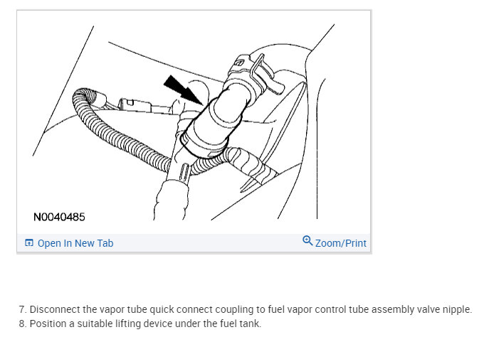

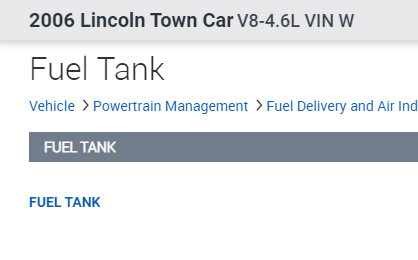

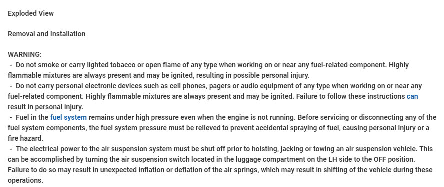

If you are doing this at home, you will need to lift the rear of the vehicle a bit. Make sure you use good safety stands to support the vehicle.
Also, you will need a floor jack because the tank is heavy, especially if there is fuel in it. You don't want it to fall. If you use a floor jack to support and lower the tank, place something like a 2x6 between the jack to prevent damage to the tank.
If you look below, I attached the directions. Basically, the majority of the directions are the removal of the tank. I placed them first.
