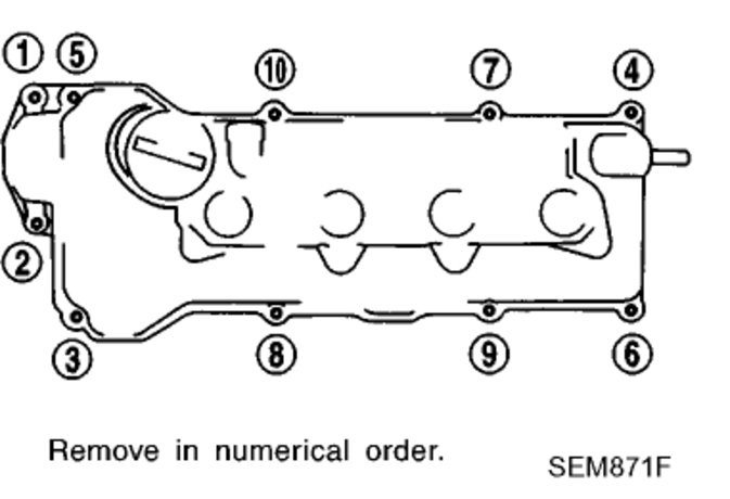

My vehicle would jerk each time I would switch on the engine. I also noticed a lot vibration on the engine. At times it would drop speed by itself on the highway and there was some hesitation of some sort.
Yesterday when I tried to start the car it would not start. I can hear the starter crank but the engine. I can hear the fuel pump buzz each time I turn the car on. I have tried to clean my plugs but the car still will not start. Could you kindly advise me on the things I should check? How can I go about the checklist?

It sounds like you have a blown head gasket between two cylinders but to be sure we need to do a compression test. If you don't have a gauge you can rent one for free at the local auto parts store.

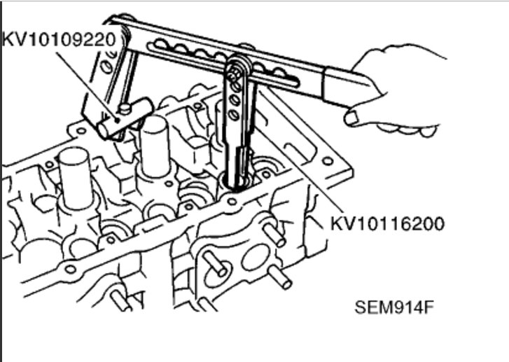

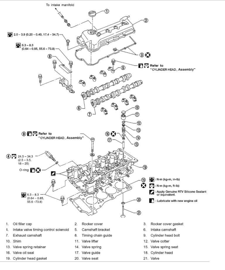

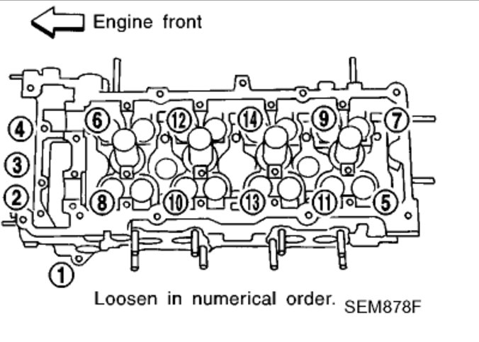

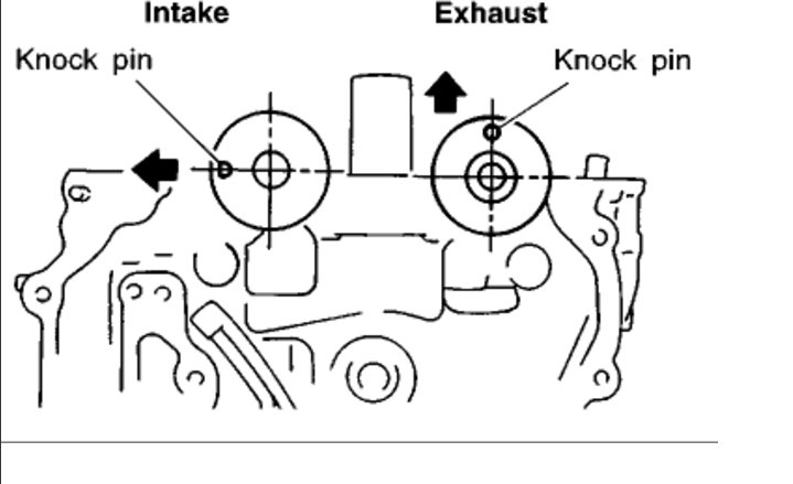

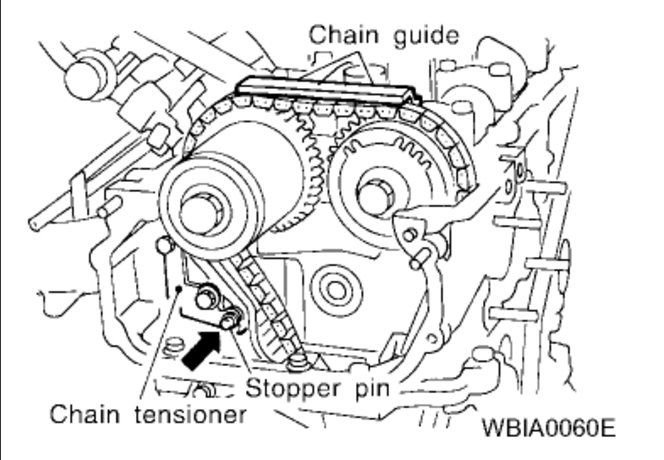

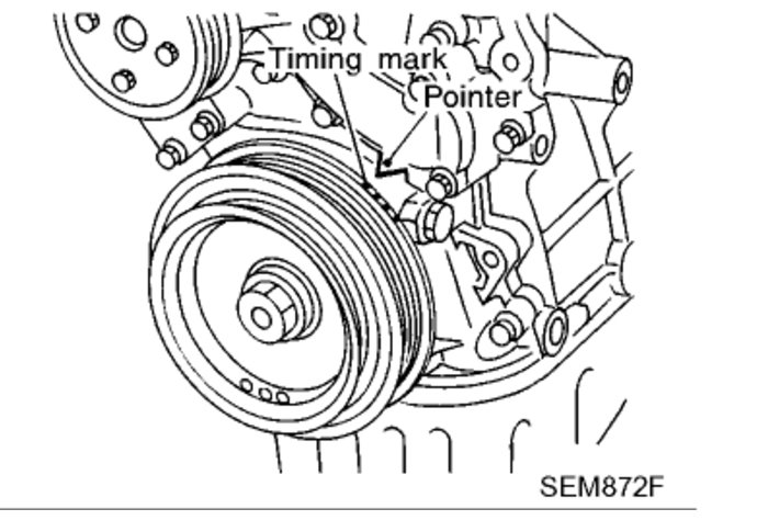

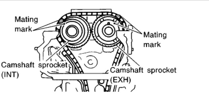

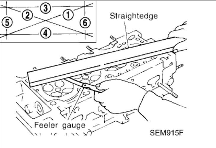

Yep the head needs to come off I would check the valves while the head is off. Here are some diagrams to help you get started.
Have the head resurfaced before reinstalling it.
Here is the instructions by the book.

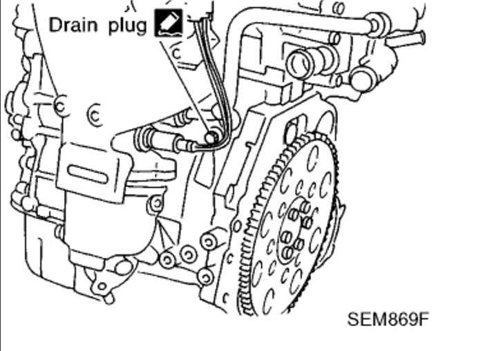

Release the fuel pressure.
Drain engine coolant. Be careful not to spill coolant on drive belts.

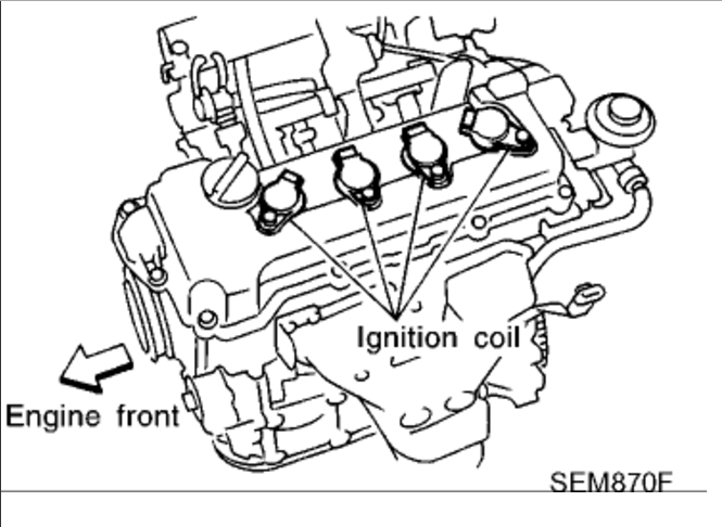

Remove the ignition coils.
Remove the spark plugs.

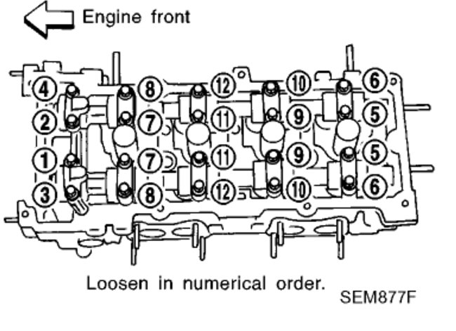

Remove the rocker cover bolts in numerical order as shown.

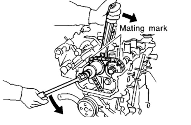

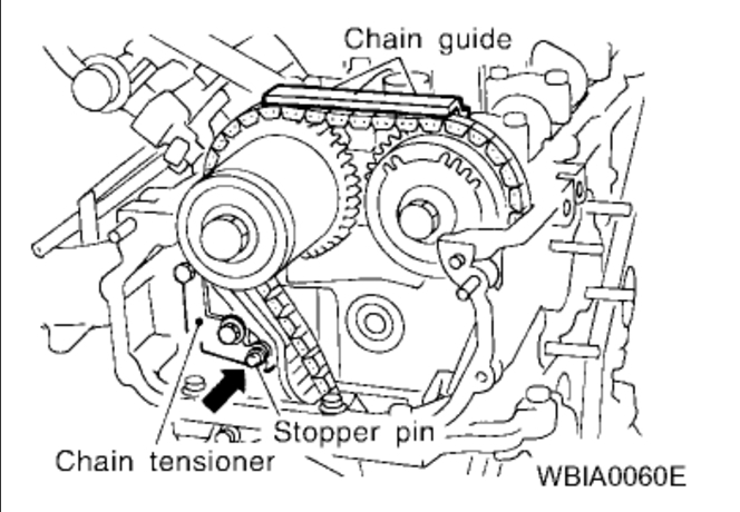

Set No. 1 piston at TDC on its compression stroke.
Rotate crankshaft until mating mark on camshaft sprocket is set at position indicated in figure.

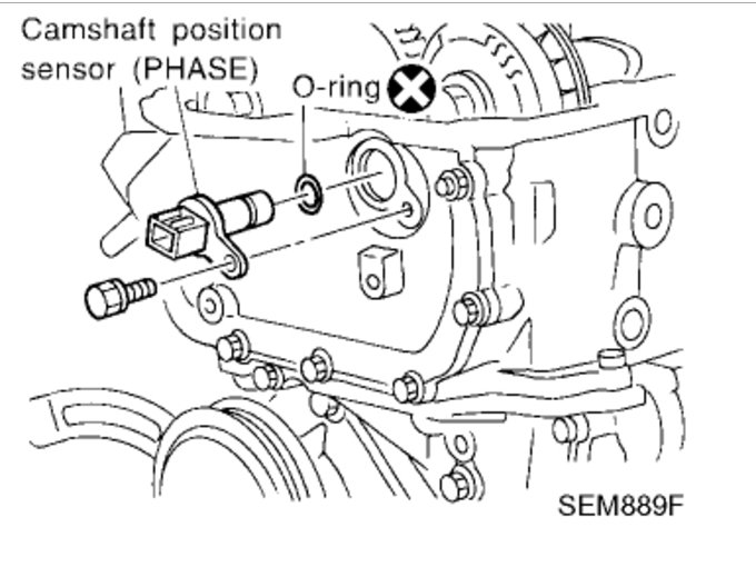

Remove camshaft position sensor (PHASE).
Do not allow any magnetic materials to contact the camshaft position sensor (PHASE).
Be careful not to damage sensor.
Remove intake valve timing control solenoid.
Remove cylinder head front cover.
Remove timing chain guide from camshaft bracket.
Attach a suitable stopper pin to chain tensioner.
Remove chain tensioner.
Remove camshaft sprocket bolts.
Apply paint to timing chain and cam sprockets for alignment during installation.
Remove camshaft sprockets.
Remove camshaft brackets and camshafts.
Apply I.D. marks to brackets to ensure correct reassembly.
Bolts should be loosened in two or three steps.
Remove cylinder head bolts.
Remove cylinder head with intake manifold.
Head warping or cracking could result from removing in incorrect order.
Cylinder head bolts should be loosened in two or three steps.
You will need to change the oil when you are done.
https://www.2carpros.com/articles/how-to-change-engine-oil-and-filter
and flush the coolant
https://www.2carpros.com/articles/coolant-flush-and-refill-all-cars
