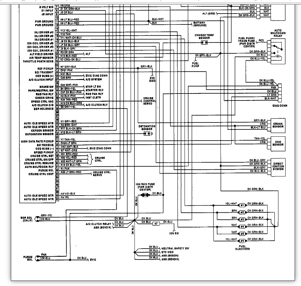

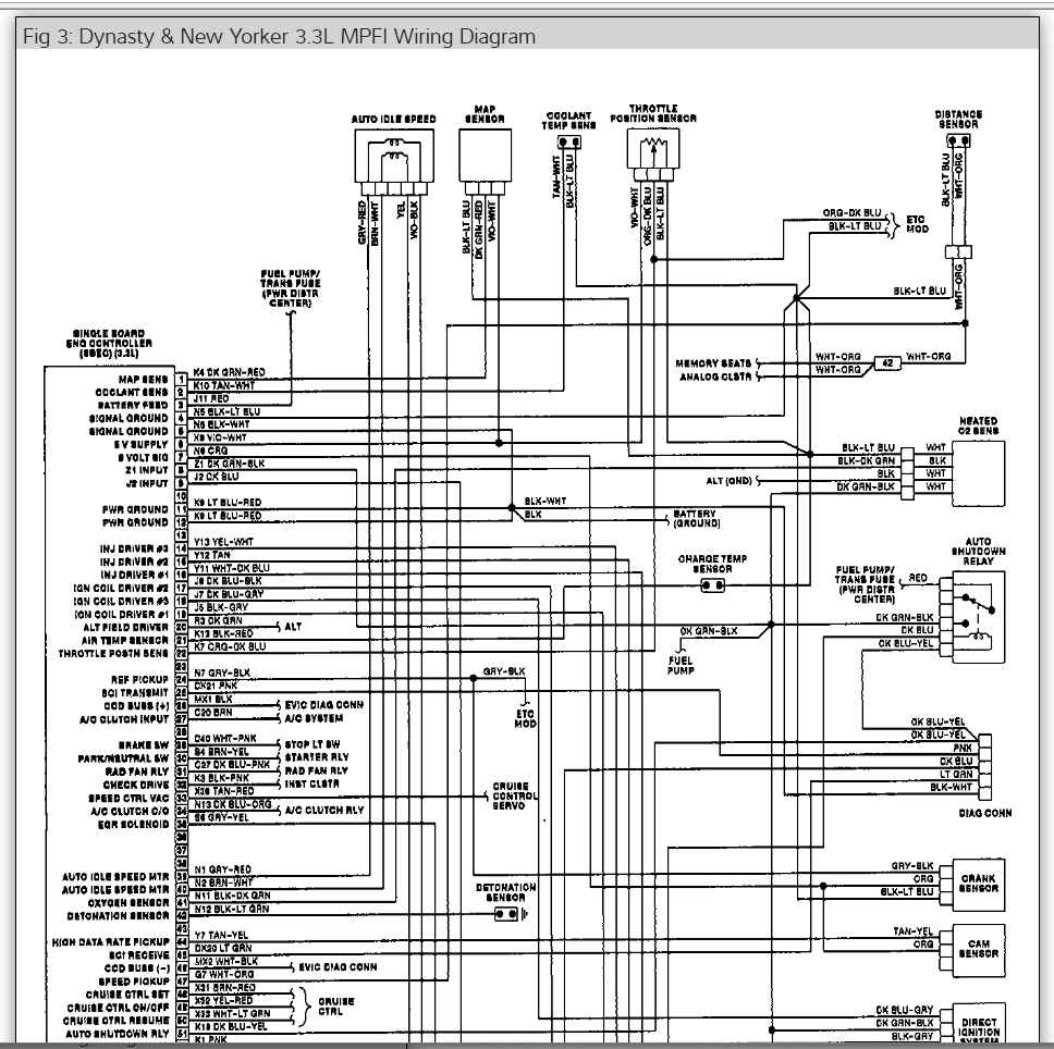

Ok. The new engine computer is on. Still no spark. I unplugged the 02 sensor and it popped only once. The fuel is a year old now so I have to drain it "but" with a spark tester in line there is no spark on any plug.
New question. "IF" the flywheel is on wrong "or" has been damaged as in a dent in the crank sensor ring. (Would this cause it not to spark)?
Tuesday, July 26th, 2016 AT 10:19 AM
KEN L
  • MASTER CERTIFIED MECHANIC
  • 48,363 POSTS
Hey Steve,
Yes this would be a problem. Lets use a voltmeter set on millivolts and test the sensor while the engine is cranking over to see if you can get any voltage out of it.
Also have you tried the auto shutdown relay, they had big problems with thoses.
Here is a wiring guide to help out.
Sorry for the delay, the post must have fallen through the cracks. :(
Let me know if you got the problem fixed
Best, ken
