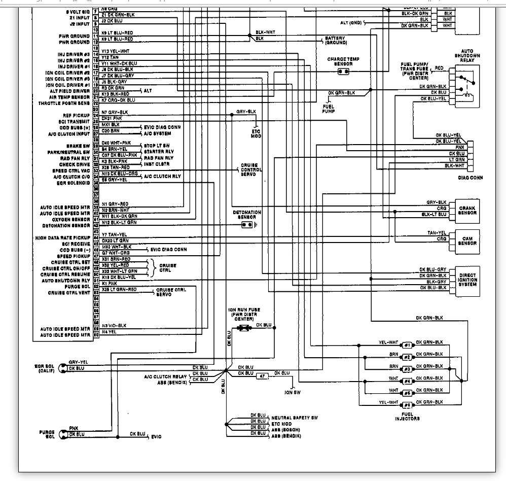

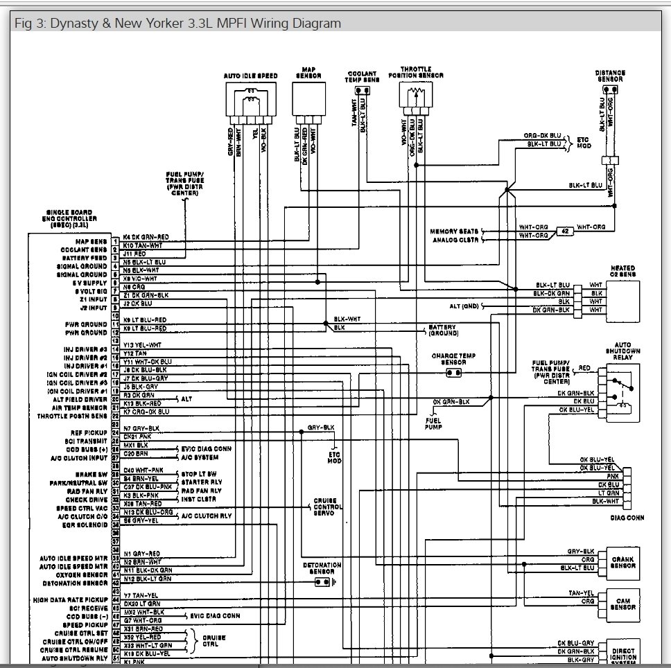

Yes this would be a problem. Lets use a voltmeter set on millivolts and test the sensor while the engine is cranking over to see if you can get any voltage out of it.
Also have you tried the auto shutdown relay, they had big problems with thoses.
Here is a wiring guide to help out.
