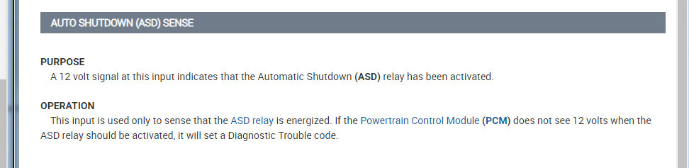

I suspect you have a code of 3 and then 55. 3 is for the air flow sensor and then 55 is an end of message code. Here is a guide that will help with this:
https://www.2carpros.com/articles/retrieve-trouble-codes-for-chrysler-dodge-plymouth-odb1-1995-and-earlier-car-mini-van-and-light-trucks
Your engine needs air, fuel, spark, and compression to start. Here is a guide that will help with this:
https://youtu.be/dCjmRL3p4Cs

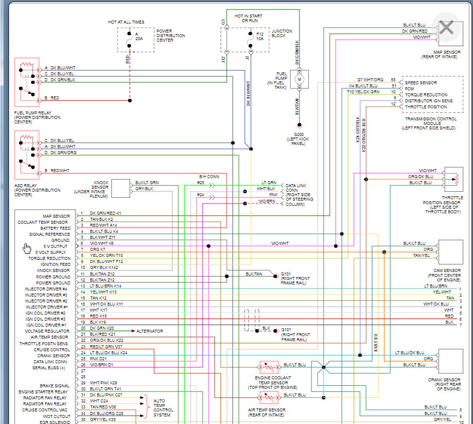

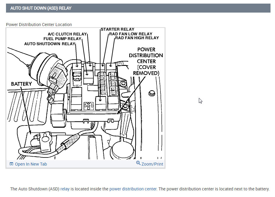

Normally the air flow sensor will not prevent the engine from starting so we need to start with checking the ASD relay output.
I attached the info below on this.
Let's start with this and go from there.

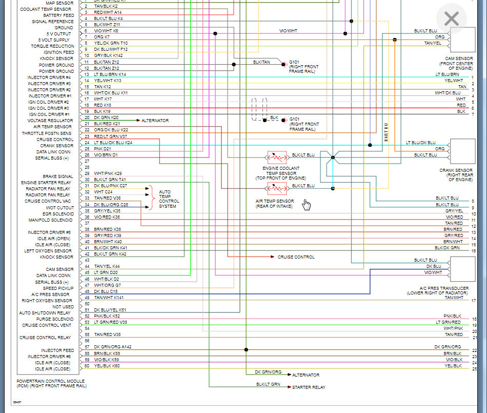

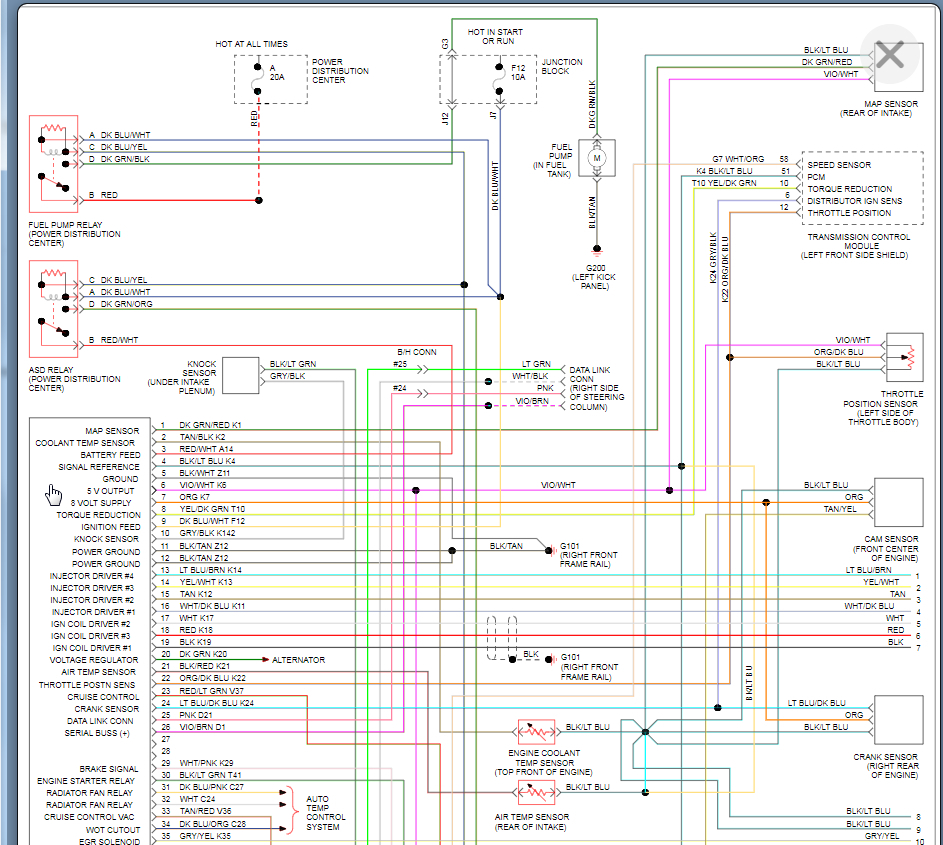

You mentioned you found 12 volts at the ignition coil, but when was that? The automatic shutdown, (ASD) relay gets turned on for one second when the ignition switch is turned on. That relay sends current to the ignition coil, injectors, and fuel pump or pump relay. That one-second pulse is to insure fuel pressure is up for starting. What can appear to be normal fuel pressure can be misleading. The pump may not be running at other times.
Specifically, the Engine Computer must see signal pulses from the crankshaft position sensor and the camshaft position sensor to know the engine is rotating, (cranking or running). If either signal is missing, the ASD relay does not get turned back on during cranking, and you'll find 0 volts at the ignition coil at that time. Many people see the 12 volts at the coil for that first one second, and conclude incorrectly it's there all the time The easiest way to tell if the ASD relay circuit is working is to listen for the hum of the fuel pump for that one second when the ignition switch is turned on.
The next step should be to determine if those two position sensor signals are showing up. It is quite common to not have a diagnostic fault code related to them just from cranking the engine. That means don't assume both are working just because no fault code is set related to them. They often need more time to set, as in when a stalled engine is coasting to a stop. The best way is to view these two sensors on a scanner under "live data". On Chrysler's DRB3 scanner, they're listed as "No" or "Present" during cranking. When one signal is missing, the sensor itself is responsible only about half of the time. First we look for wiring and connector terminal problems. Aftermarket scanners should have a similar method of saying if those signals are showing up.
A slightly less-reliable method is to check for 12 volts at the ignition coil or the same-color wire at any injector, while a helper is cranking the engine. It must be there steady.
