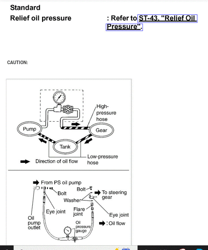

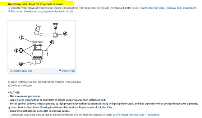

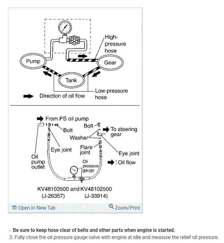

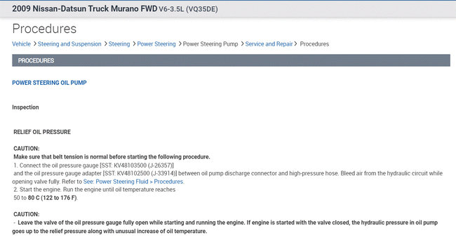

Hi Veronica,
I certainly hear the sound. Is that only happening when you turn the steering wheel? It does sound like a power steering pump.
Let me know if there is any evidence of air still in the system such as foaming in the fluid.

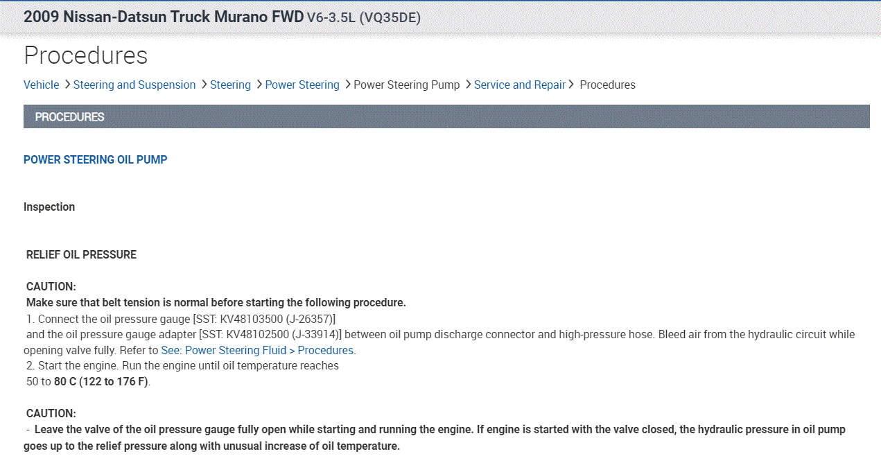

Also, let me know if there is any assistance. One last thought. With the front wheels off the ground, does the steering turn freely?
I attached diagnostics for checking the pressure. Take a look through it and let me know if this is something you feel comfortable doing. If there is a restriction, likely there is a blockage. If the steering with the wheels off the ground is tighter than normal, it could be related to the rack and pinion.

I just put a new pump on the 3rd in over a year due to the 1st and 2nd being done by an idiot that left me to finish removing then redoing the 2nd and now the 3rd pump due to excessive leaking and Aamco saying the pump was bad. but yes it only screams like that when turning the wheel both on and off the ground i replaced the rack about 6 months or so ago, but it was a used one. However, after replacing the pump this last time i found that the hose going from the reservoir to the top of the pump called the feeder hose was ripped on one end and starting on the other. so, you said that you included how to find a blockage if there is one above i think but does it tell how to clear it as well. I will look at the info you gave and try them and get back to you ASAP. thank you but even though all that leaking fluid that's built up on the alternator you don't feel its related to this.

You know the highlighted words in your diagrams i'm not able to open them up. do you know why by chance?
May 29, 2022 at 11:54 PM
  • 110,244 POSTS
That isn't a thread to open. It is referring to the tool being used to test pressure.
