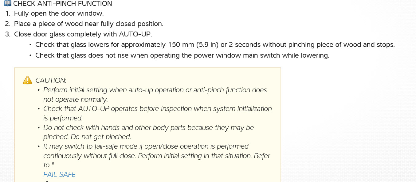

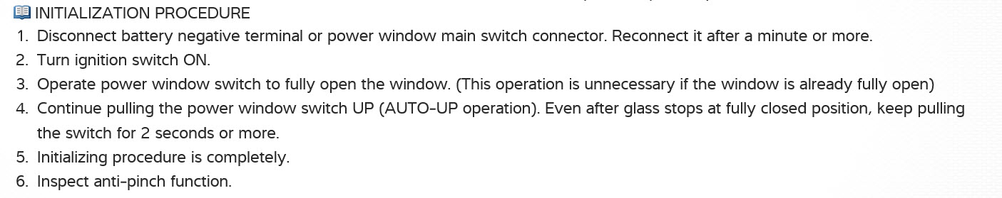

The dealer would not say because they want to charge you money to fix it. This may be in your manual as well.see picture for window reset then check the manual. I cannot find anything for radio reset.

Thank You so very much! I was able to fix the window auto up by myself with your instructions, but on the clock, the radio, cd player and the overhead light by the front windshield, We checked all of the fuses in the car under the dash and did not find a blown fuse, but someone said there is a relay/fuse box under the hood. Do you think all of that could be from a blown relay or fuse from under the hood?

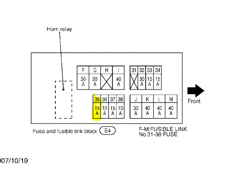

This should all be laid out in your driver's manual, but check fuses 10 and 35 in the fuse box the under hood. it also may tell you how to reset radio after a battery disconnect we have nothing on this.

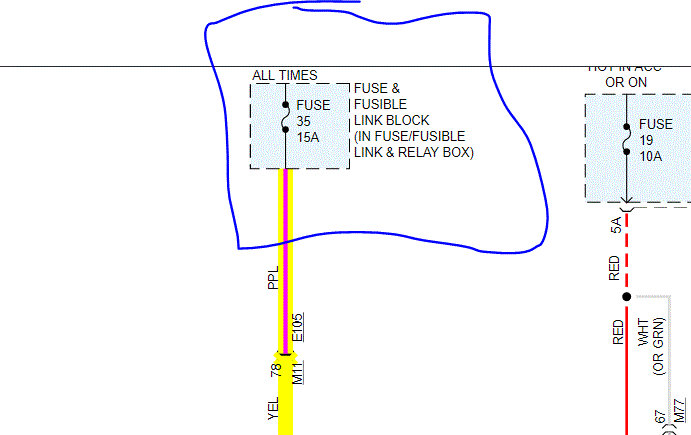

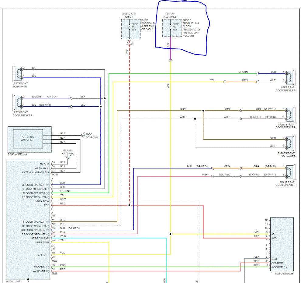

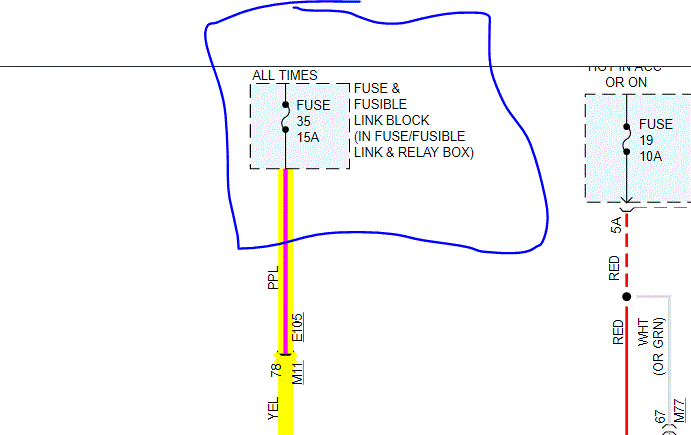

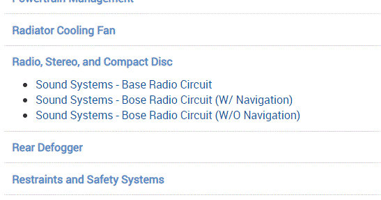

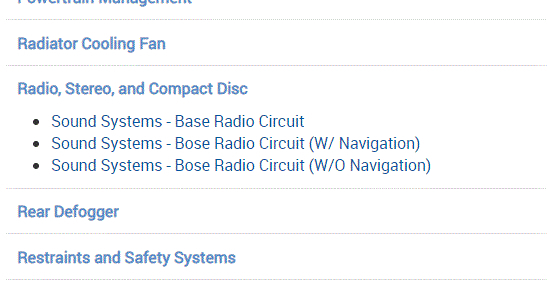

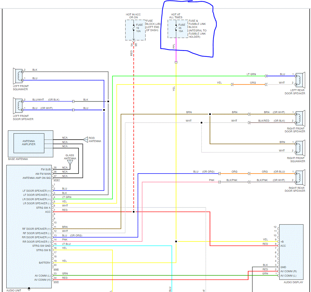

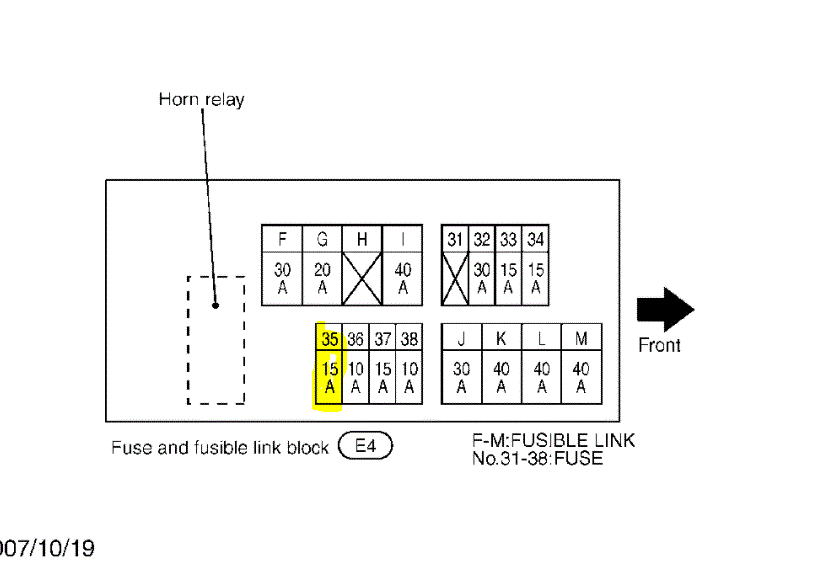

Is your vehicle the same year make and model? If so, I looked at the wiring schematic for a base radio. It shows a 15amp fuse in the fuse/fusible link box near the battery. I attached a pic below showing the fuse location. Check that fuse. Also, if you have a different stereo system, let me know what you have. Pic 3 shows the options.
One other thing, in addition to checking the fuse, confirm there is power to and from it. Here is a link you may find helpful:
Let me know what you find or if you have other questions. Also, that is the only fuse the schematic shows for that radio,

Wow, there is a difference. The wiring schematics for a base radio on this vehicle is five pages long. LOL Fuse 35 is the key for powering it. (see pic 1). If you are simply checking for power, you could get a simple test light, but that's your call.
when you checked fuse 35, did you confirm there is power to and from it?

I got a multimeter and measured the voltage a both ends of the fuse 35 (through the holes on top) at 13.13V. Also the fuse passes continuity test and shows as 0 ohm in the multimeter. Please let me know if you want me to check anything else.

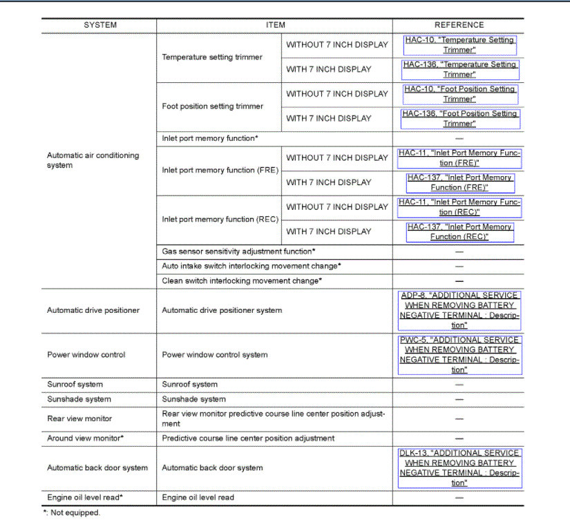

There are several resets when removing the battery on this vehicle. I attached a pic below indicating what is required. However, there is nothing with the radio.
When you try turning it on, does it light up?
