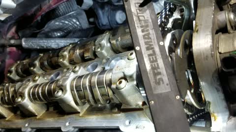

Upon another two revolutions the opposite r bank exhaust and left bank intake line up.
Aug 4, 2018 at 5:39 AM
MARK FRIZZELL
  • 142 POSTS
They never all four cams line up on marks again at the same time.
Aug 4, 2018 at 5:40 AM
MARK FRIZZELL
  • 142 POSTS
More I search, I am beginning to believe I have a bad Intake VVT sprocket on bank 2.

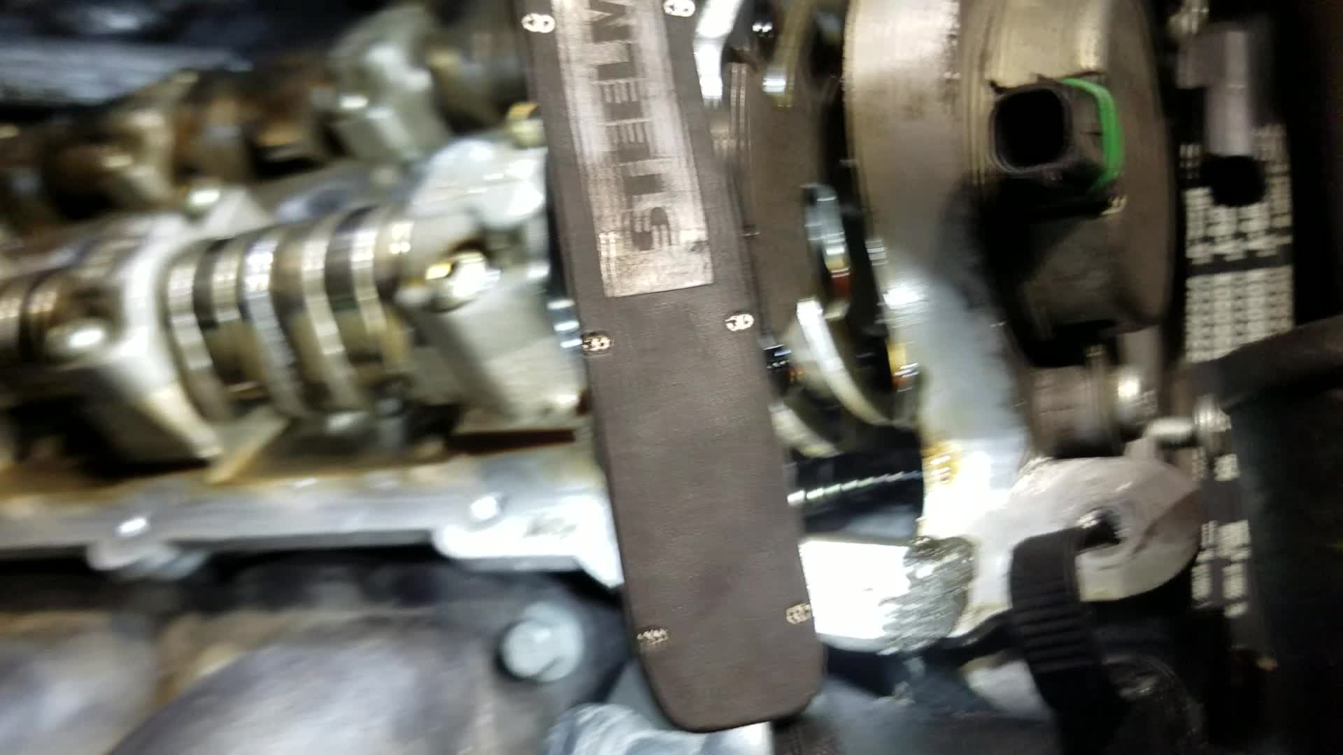

Okay, have new VVT's installed, chain on every thing is lined up good. Getting ready to put tension wrench on VVT's but not sure, do I remove cam locking block before I put VVT tool on and turn? The picture steps do not say anything thing about the the cam holding tool after you install it on cams?
Thanks, Mark
Aug 10, 2018 at 4:29 AM
  • 55,421 POSTS
The VVT's should be tight in the camshafts before installing the chain. Then back the actuators all the way back then install the cam tool and chain while lining everything up.

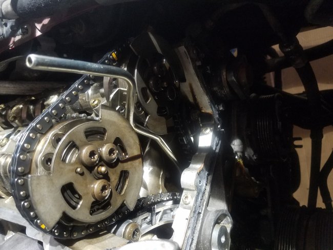

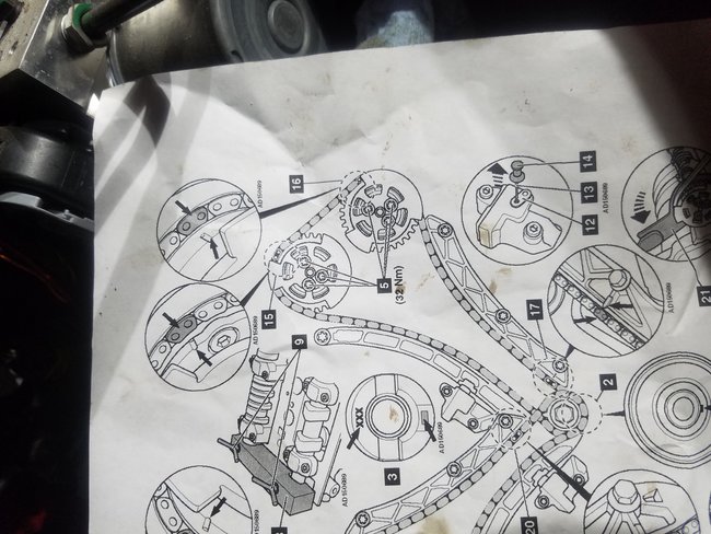

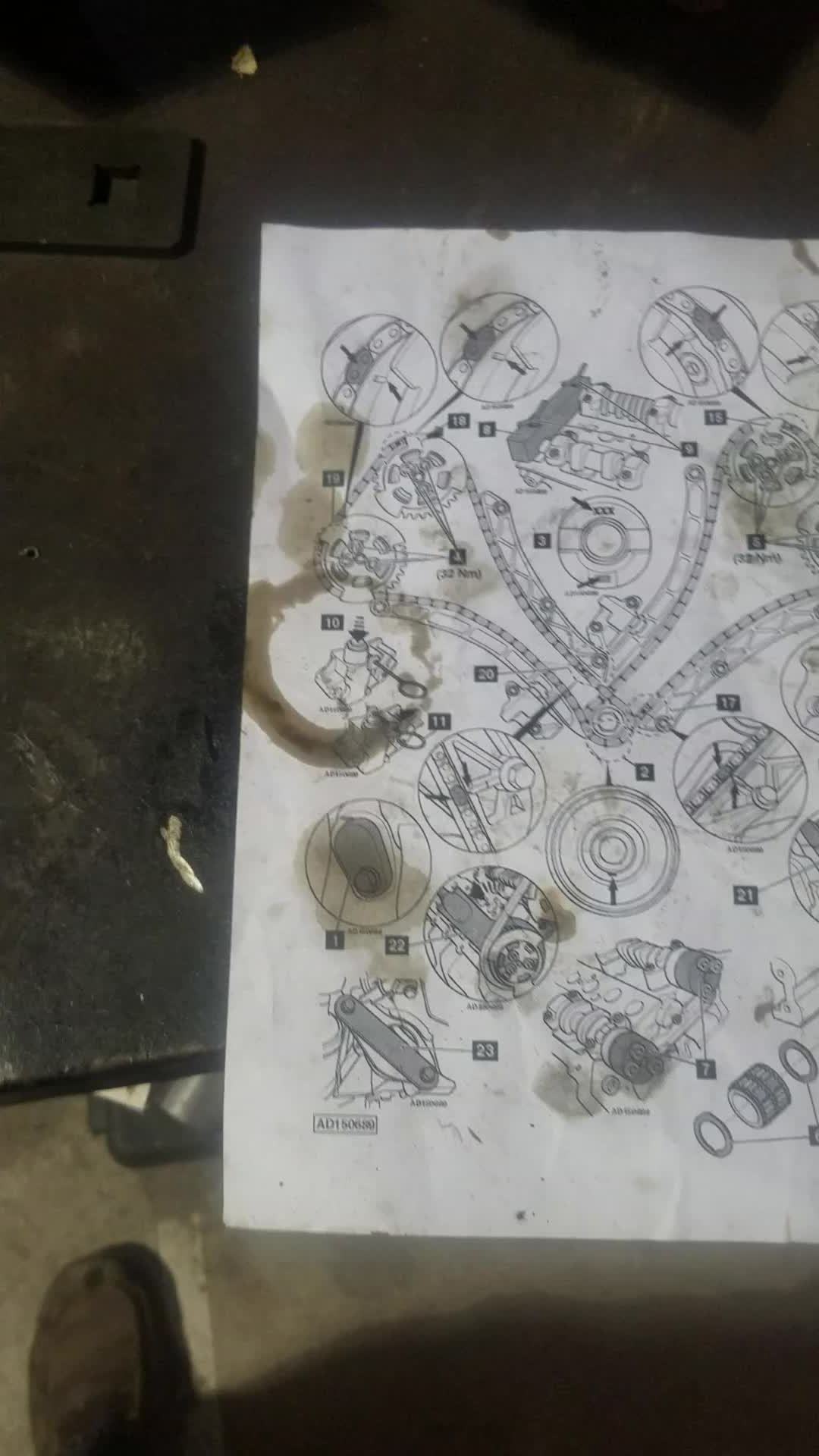

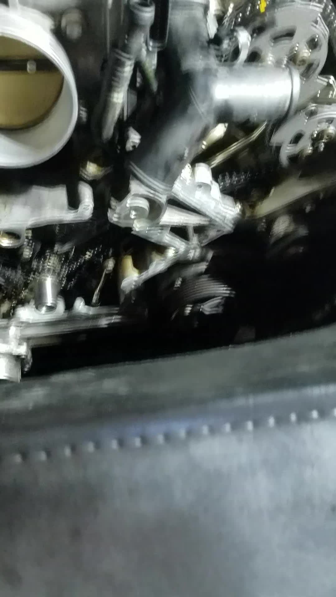

I will check but I am sure the plugs are correct. I am still on the fence about the printout I showed you of the timing marks especially the left bank. All three cams lined exactly like the printed photoelectric except that left baking intake, all. 6 points on chains were on the marks but that sprocket face plate was not. Not even on the new one. Does not look like picture.
Aug 14, 2018 at 7:04 AM
MARK FRIZZELL
  • 142 POSTS
I sent a video about the actuator question from last week, this puzzles me. The mark on the chain is on the mark on sprocket but on wrong side of face plate.
Aug 14, 2018 at 7:55 AM

Also with exhaust cam in correct place LH the number of chain links from one mark to the next are to many to put the exhaust cam mark on the other side of the tab. That is why I went the marks on chain lining up with marks on actuators. So what is the problem?
Aug 15, 2018 at 9:50 PM
  • 55,421 POSTS
Not sure, I am looking at the video you sent and the diagrams from the manual they both show actuator in a different place than what you have. Did the engine run okay? The sensor will never be happy with the actuator timer being that far off.
Aug 16, 2018 at 5:00 AM

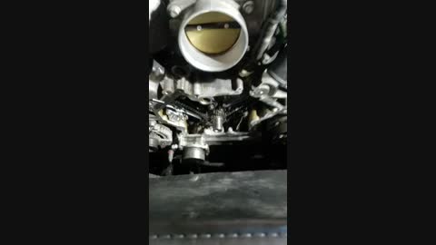

I guess I will disassemble that side again in on TDC and see where it has landed, and send you a video.
Aug 16, 2018 at 5:14 AM
MARK FRIZZELL
  • 142 POSTS
With that being said no one is perfect. If I was one link off on the bottom around crank would that give the effect of starting good, runs quite, but adjusters cannot compensate? And give those codes?
Aug 16, 2018 at 10:46 AM
  • 55,421 POSTS
Oh yes, if you are one tooth off it will make the code and the actuators will try and compensate. Please send the video when done. Please hang in there we will get this right.

  • 55,421 POSTS
Yep, one link off looks that way to me as well. Let try it with the links moved one, sorry this is kind of a learning experience like most car repair.
Aug 18, 2018 at 6:21 AM
MARK FRIZZELL
  • 142 POSTS
Hope, it looks right.
Aug 20, 2018 at 1:12 AM
MARK FRIZZELL
  • 142 POSTS
Success!
Aug 20, 2018 at 8:21 AM
  • 55,421 POSTS
My man! nice work mark, we both learned something on this one. Glad you got it fixed I knew we would win. :)

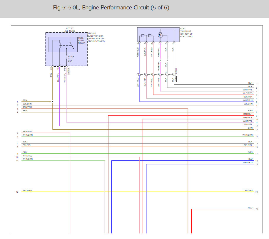

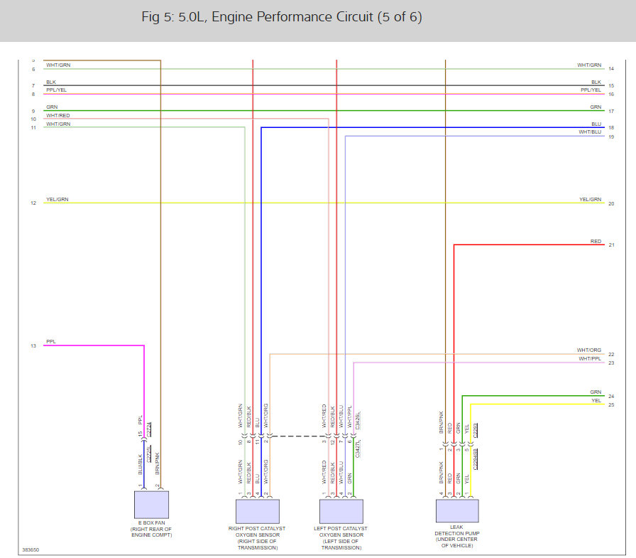

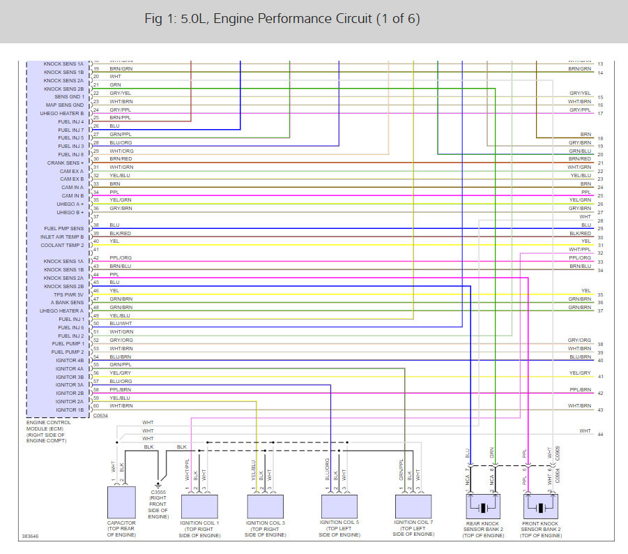

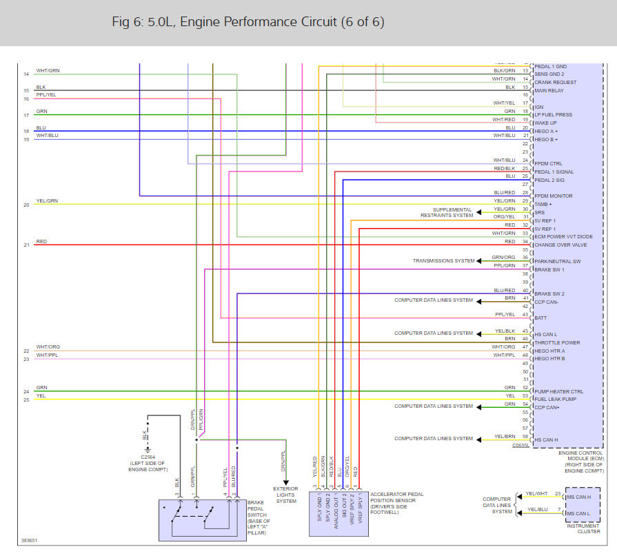

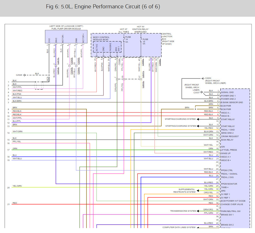

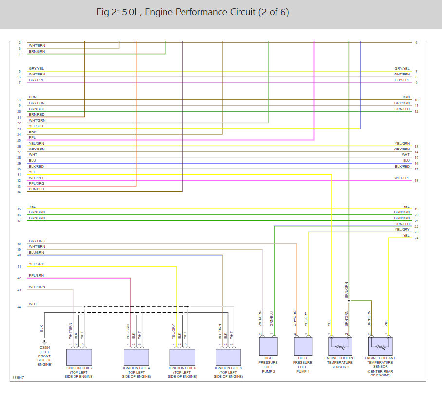

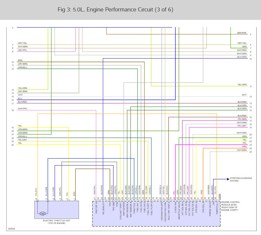

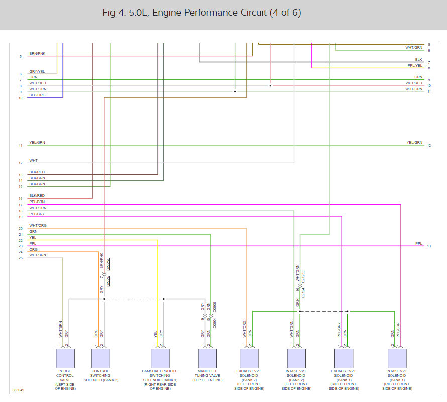

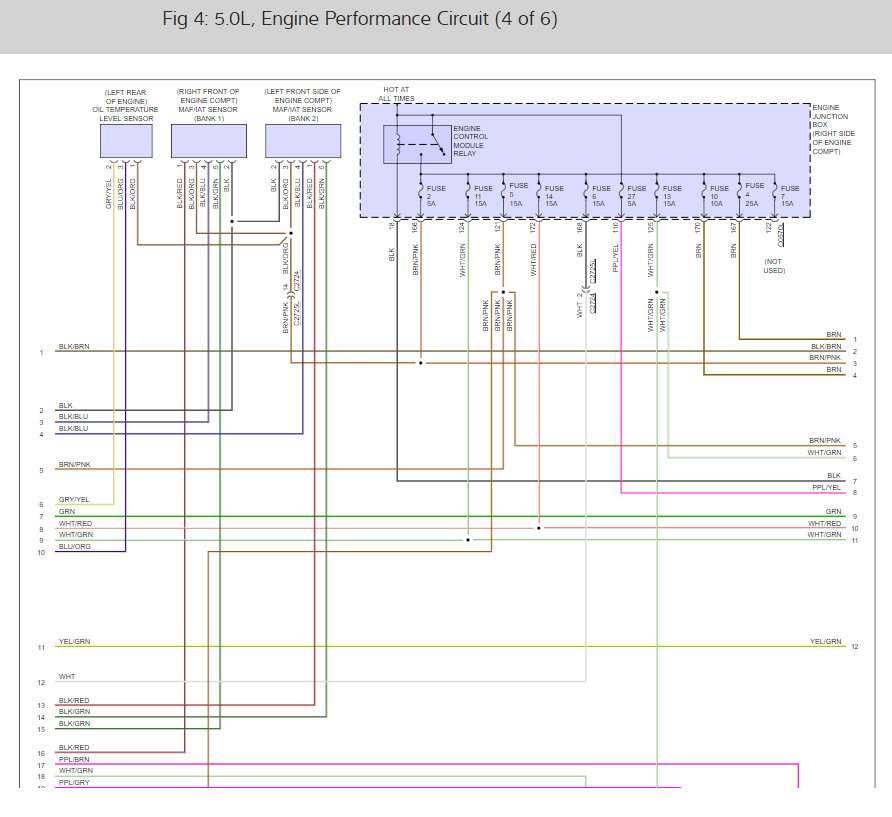

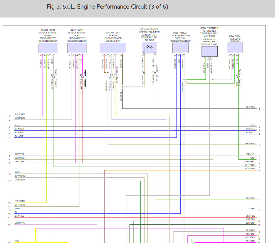

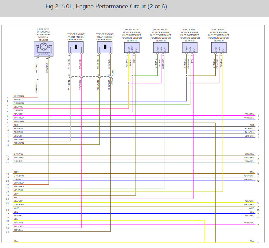

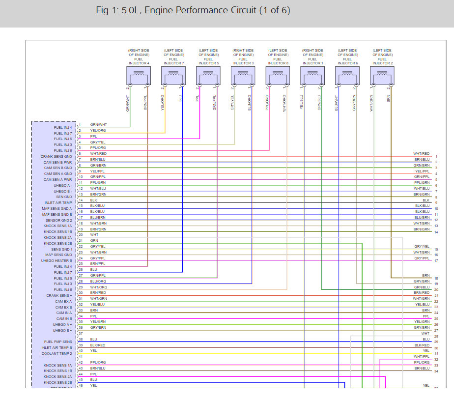

Yes, definitely one side of the engine. At least there are no p0012, p0011 codes. Still sounds like a grounding issue to me for the coils. Here are the engine wiring diagram and a guide to help you test the grounds. Is the main ground strap from the battery to the block and then to the frame in good shape all connected?
Sep 11, 2018 at 4:59 AM
MARK FRIZZELL
  • 142 POSTS
Grounds are good, another possibility?
