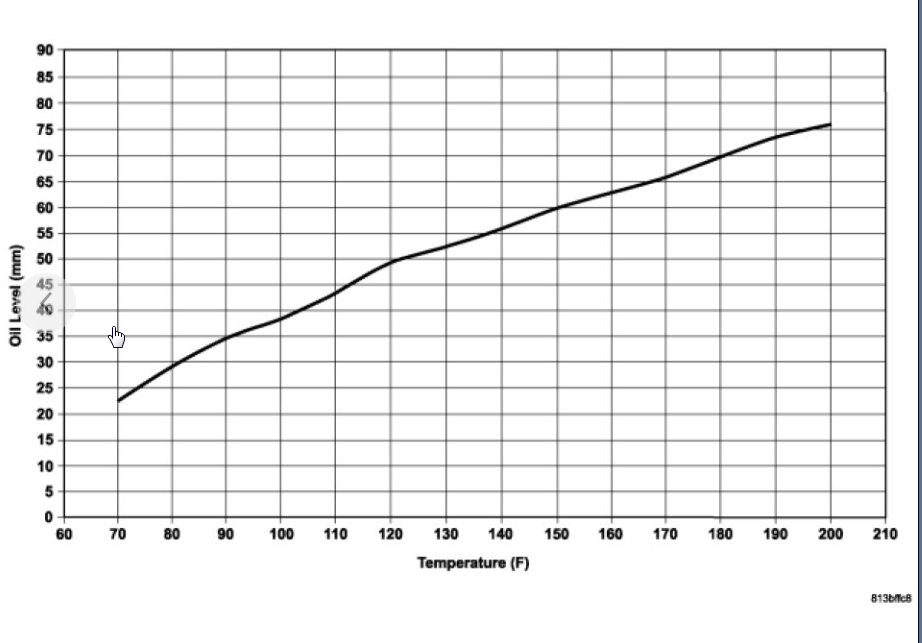

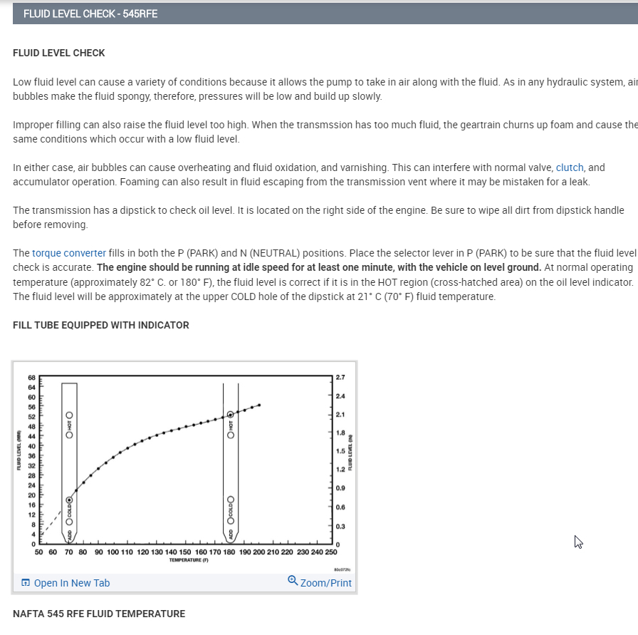

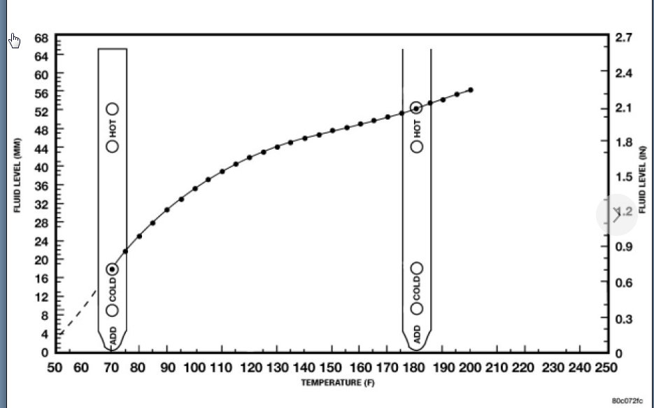

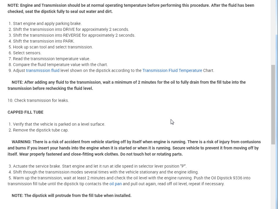

This could be an issue with the internal components of the transmission but I am thinking it is just low on fluid. Here is the process on how to check the fluid on this 545RFE transmission.
If this is not the issue then we need to check for codes. If there are codes then that will point us in a better direction. Let me know and we can go from there. Thanks
