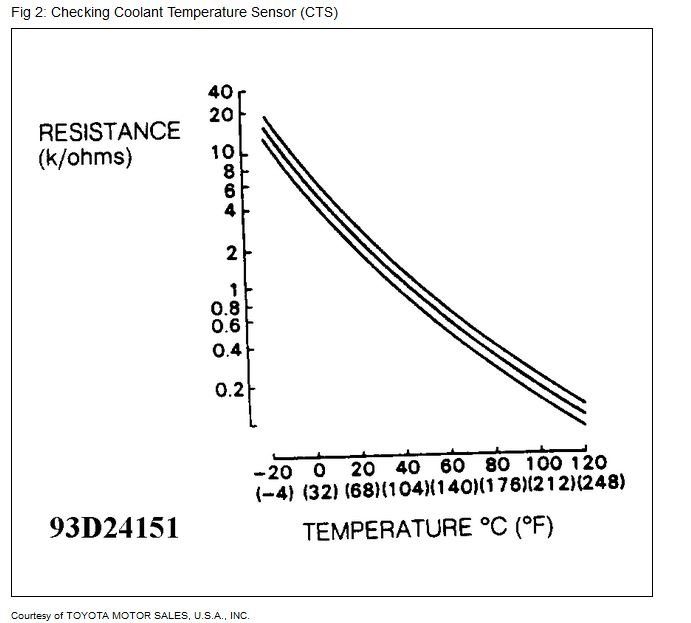

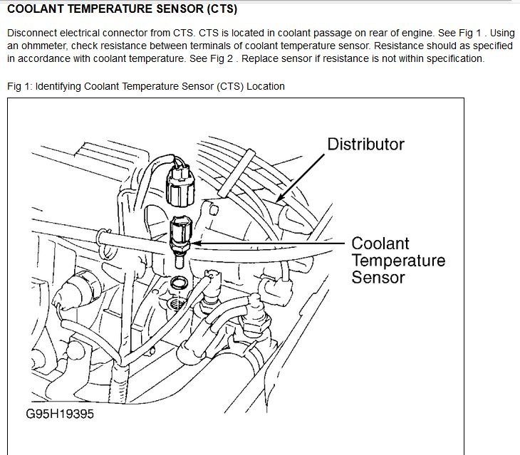

I would suspect a bad engine coolant temperature sensor and possibly a stuck thermostat. That sensor sends a signal to the computer which the computer uses to judge when to turn on the fan(s). The thermostat could have gotten stuck after the car overheated, as sometimes the shaft of a thermostat will bend when the car overheats, causing to be stuck in place.
I am attaching Toyota's instructions on how to test the coolant temperature sensor in the images below. You will need a multi-meter or ohmmeter for this. A decent multi-meter can be bought for $15.00 to $20.00 (last I checked, at least). You will need to set it to Ohms and go from there as outlined below.

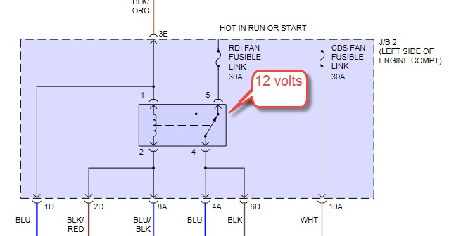

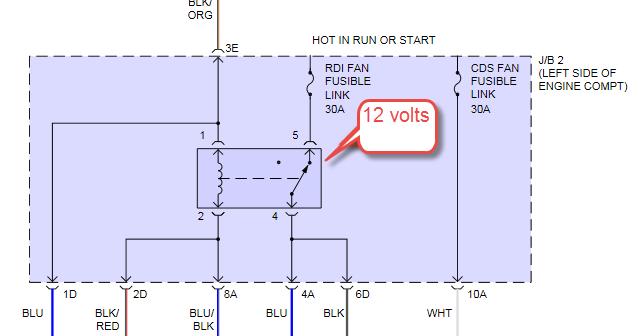

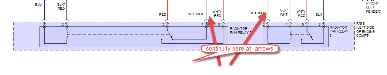

I have posted this problem before but since then I have put a new switch on the radiator, new sending unit on motor, and I got a almost brand new radiator still not working.I was reading a article on 4 terminal relays and it said check one of terminals check continuity to ground, and I am talking about where the relays plug into in the distribution box can someone tell me what that means am I suppose to have continuity there or not and I think they was talking about terminal 3. So what does that mean and how many volts should there be in the other ones.
Monday, January 25th, 2021 AT 12:42 PM (Merged)
HMAC300
  • 48,601 POSTS
I t means you take an ohm meter and probe where the terminals go into box and one on ground and see if you have continuity or the ohm meter should go to zero. See pics then after checking this go to repair/electrical how to check a relay on our site. If that doesn't fix it take to a pro because I may be beyond your ability.
RANDY SHARP
  • 165 POSTS
It was the relay thank you
