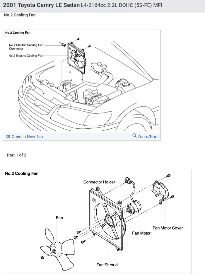

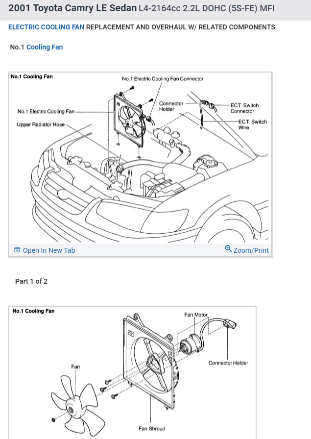

Why don't my radiator fans turn on?
Jul 13, 2008 at 6:00 AM
SQM
  • 6,383 POSTS

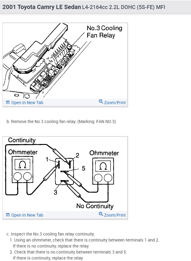

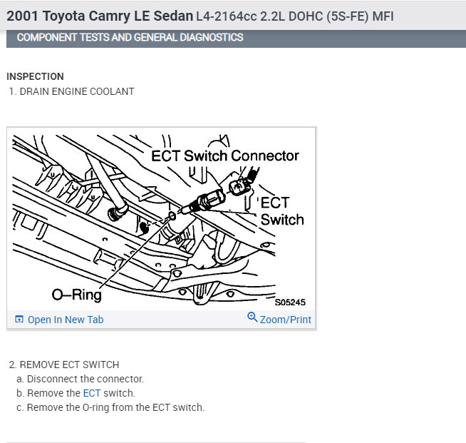

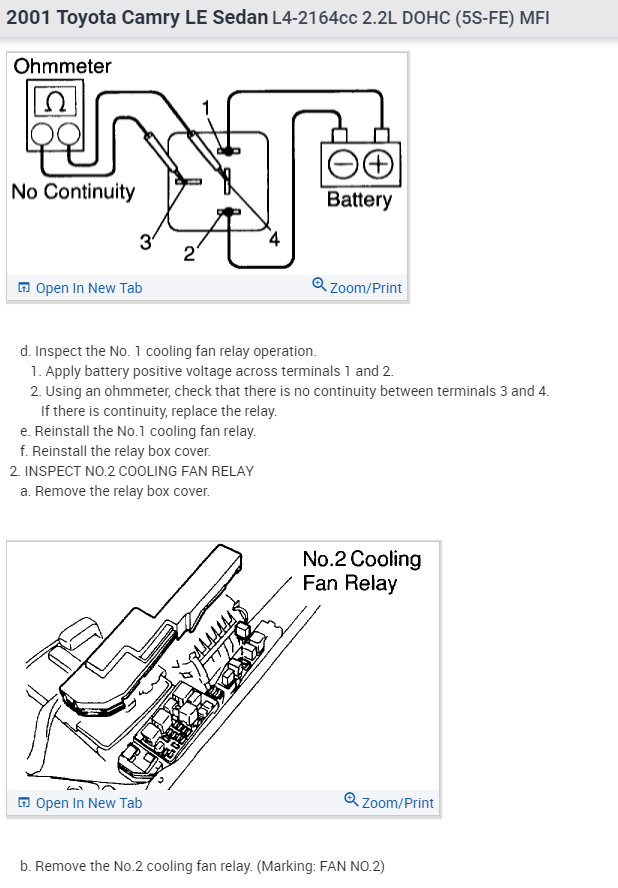

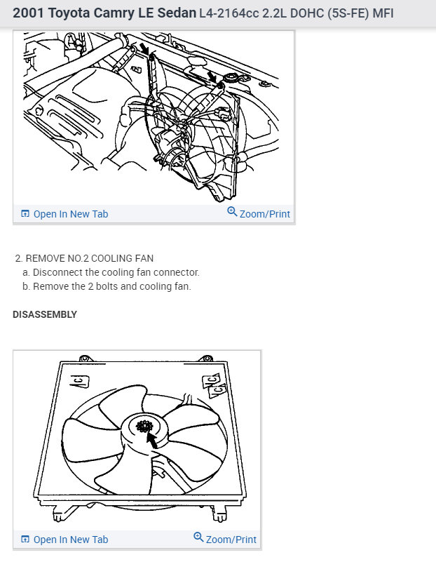

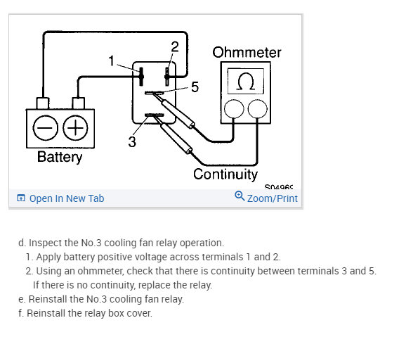

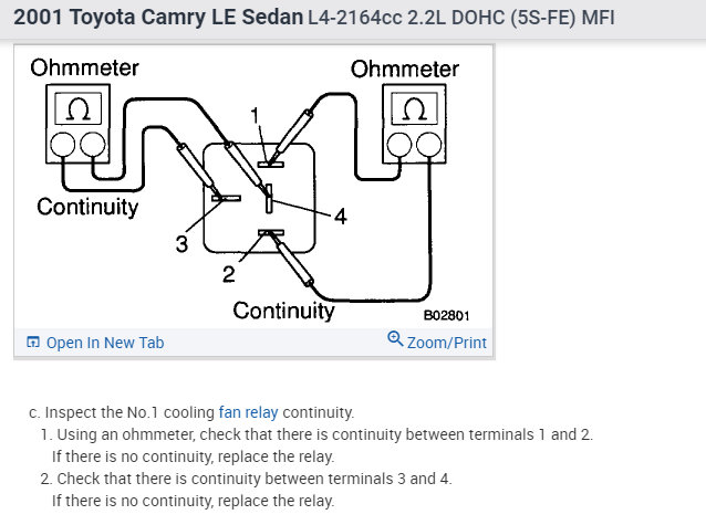

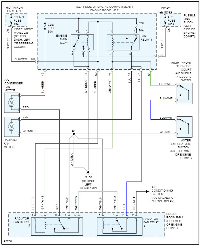

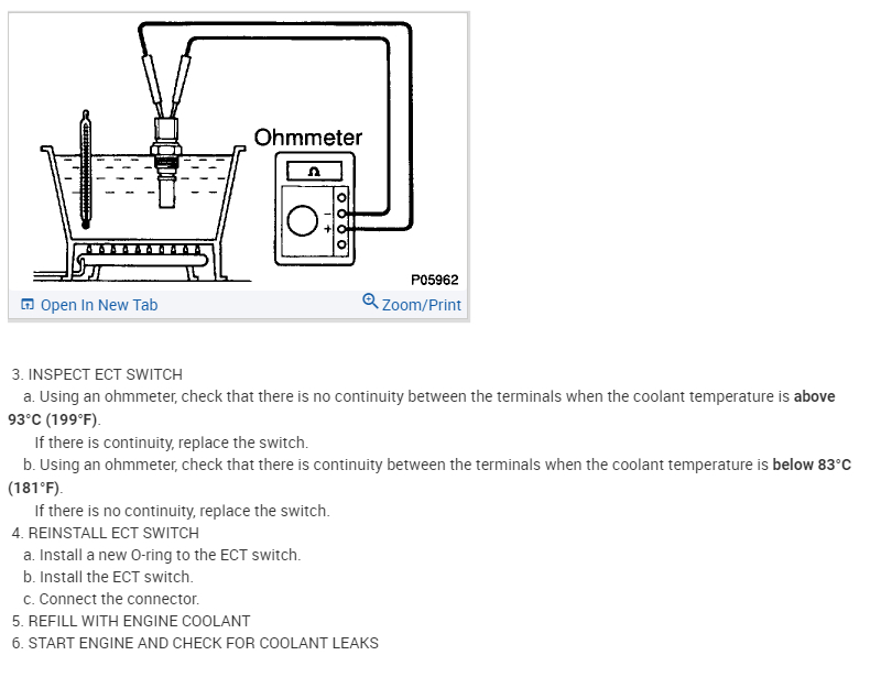

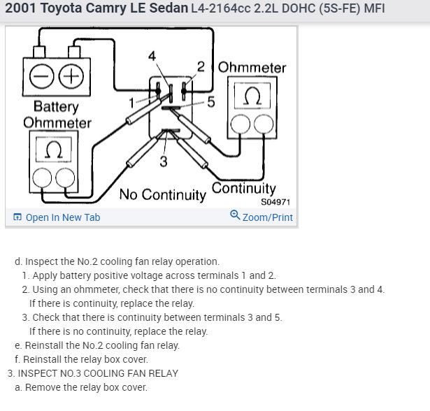

First of all, the radiator fan should turn on when the engine reaches its operating temperature. It also turns on when the A/C is on.

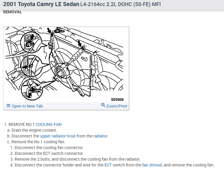

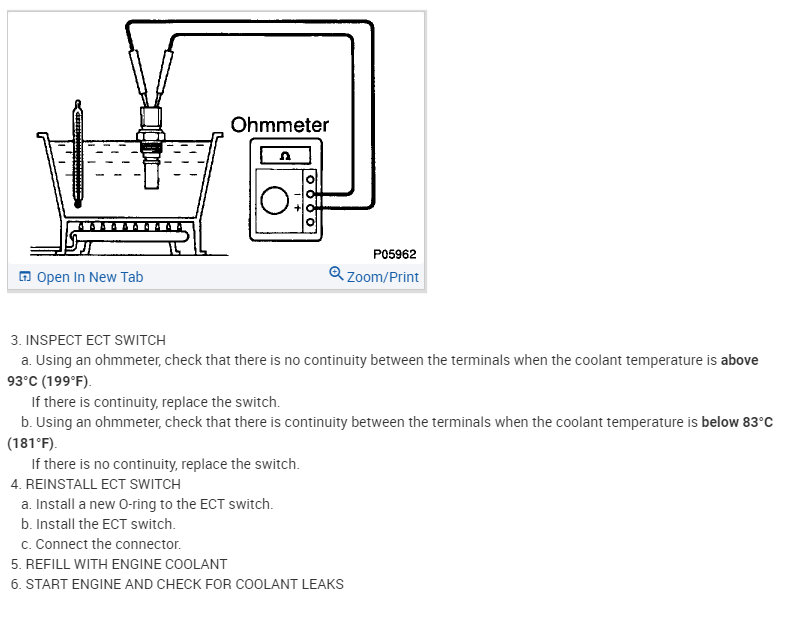

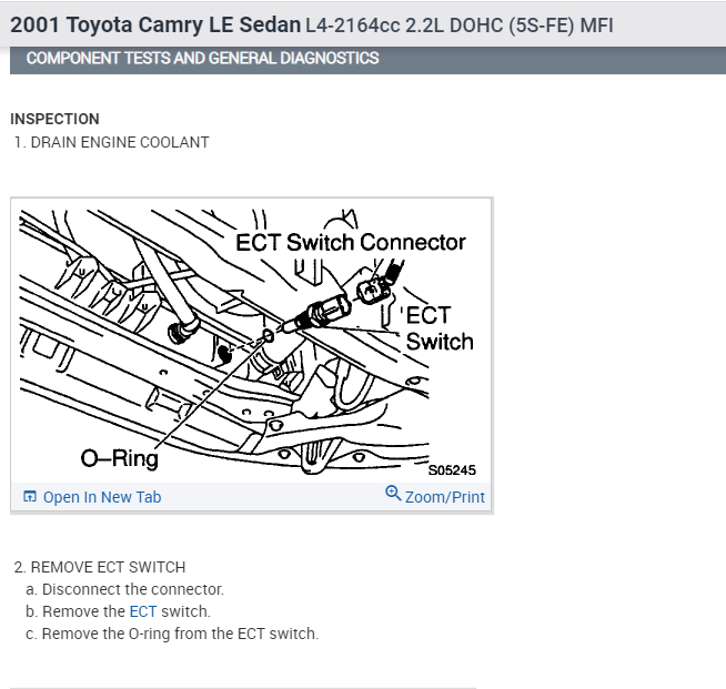

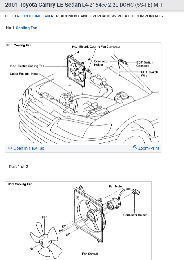

An inoperative radiator fan can be due to a bad relay, faulty wiring, defective coolant temperature sensor or a bad fan motor.
https://www.2carpros.com/articles/how-an-electric-cooling-fan-works

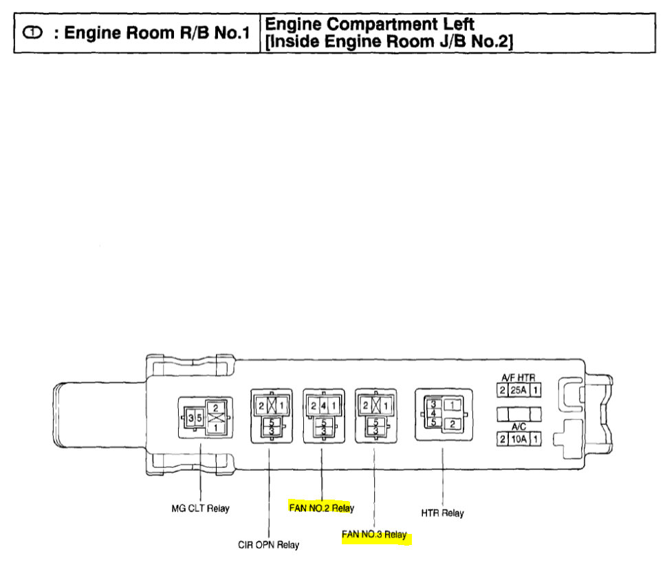

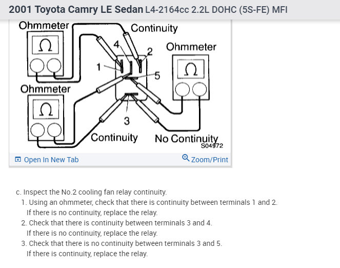

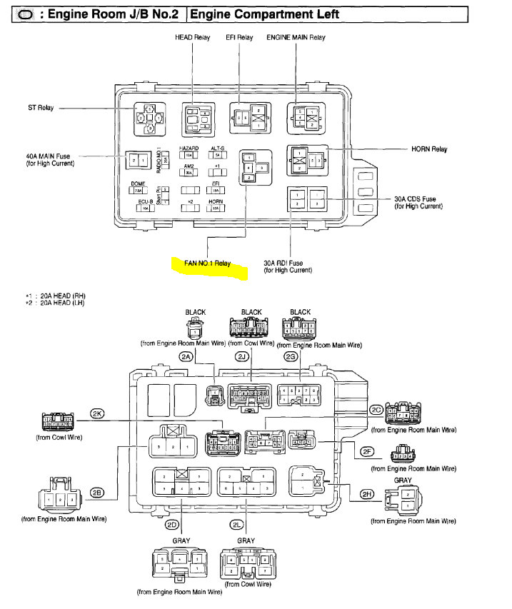

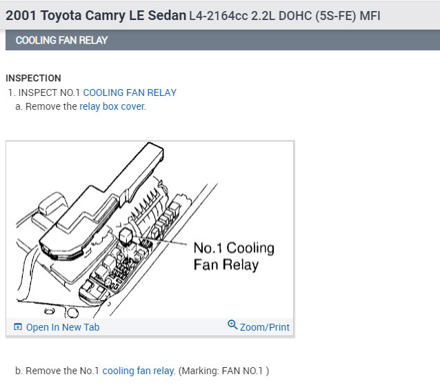

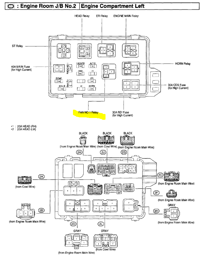

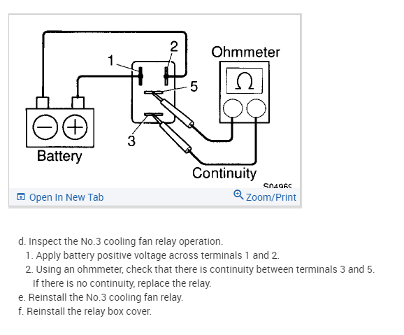

First check the relay. This vehicle has 3 relays for the cooling fan. They are located in the under-hood fuse box.

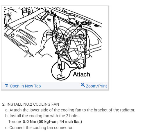

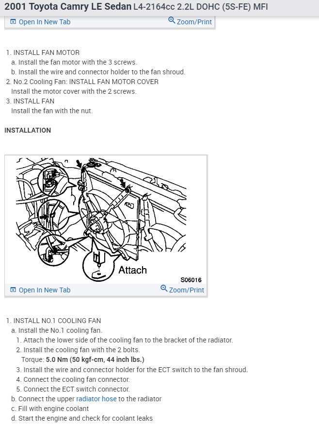

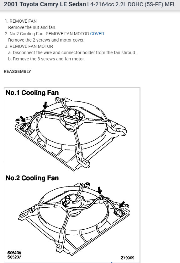

I have attached diagrams on how to test the relays as well as the temperature sensor and the fan replacement procedure below for your reference.
