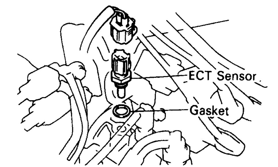

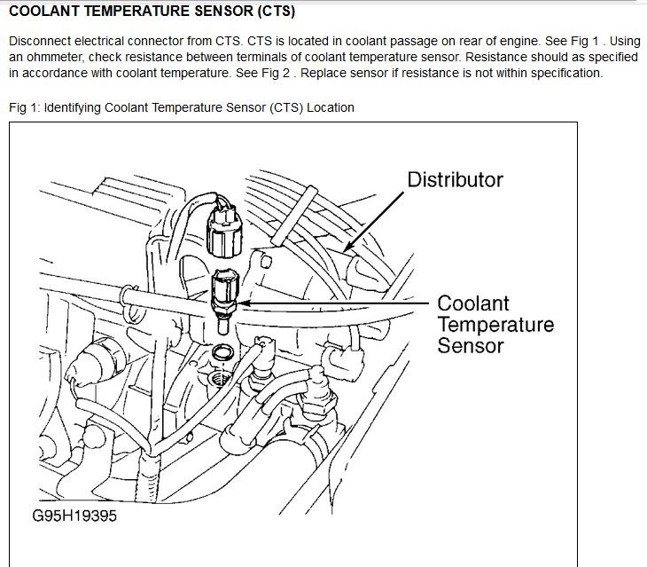

Good afternoon,
The coolant sensor that controls the fans is on top of the motor at the distributor. I attached a picture for you to view. Check that sensor.
https://www.2carpros.com/articles/engine-overheating-or-running-hot
I am worried from the overheating that you may have damaged the head gasket.

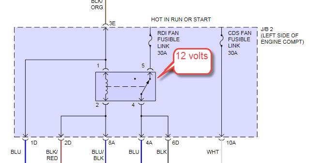

  • 52,797 POSTS
Sensor should have 5 volts.
Switches have 12.

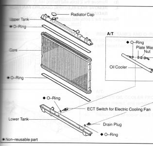

Suggestion: Try checking the ECT (Engine coolant temperature) switch for electric cooling fan located at the bottom of the radiator. (either left or right side). With the engine OFF, unhook the wire connected to the ECT switch. Now turn ON the engine, if the fan runs, then maybe it is the ECT switch. You need a new one pictured at the bottom with the O rubber ring.
https://www.2carpros.com/forum/automotive_pictures/89255_ect_switch_1.jpg
https://www.2carpros.com/forum/automotive_pictures/89255_ect_sensor_1.jpg

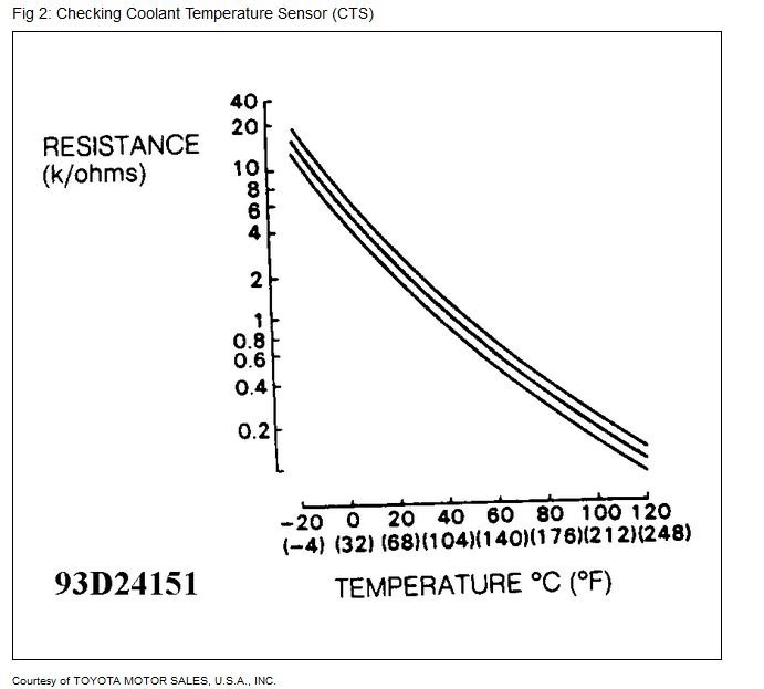

I have a 95 Toyota Camry - 4 cyl DX. The radiator cooling fans are not coming on. I flushed the radiator and tested the fan switch and it is working fine. It opens up at about 205 degrees. The coolant sensor is also good - it read about 3500 ohms at about 45 degrees (cold car). I also tested the 2 relays associated with the fans (the main and fan 1). They were also good. As the temp increases I can disconnect (essentially open up) the fan switch wire and the fans will run. Also if I leave the switch wire disconnected the fans run when I start the car as well. But once I hook up the wire from the fan switch to the control it does not come on (essentially a short). Any help would be appreciated. Thanks Kevin
