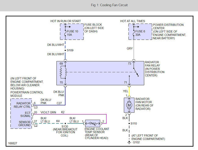

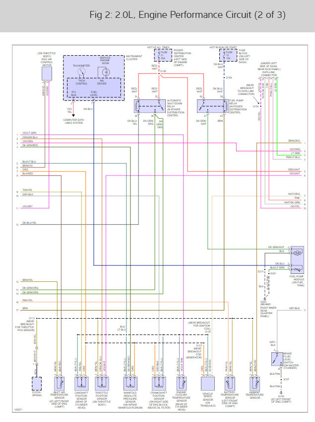

Both cooling fans come on within three seconds or so of starting the engine. Code p0481 on OBD. Fan relay and coolant temperature sensor have been replaced. No ground on 70 pin in relay box until engine is started. I have also tested with the AC high pressure and low pressure unplugged. No other error codes.

The codes says there is a problem in the circuit. Lets do a pin to pin check on the coolant fan wiring to see what you can find. here is a guide:
Use the wiring diagram above.
Mar 30, 2018 at 3:25 AM

It like the PCM is thinking the engine is overheating and you say you tested the wiring to the sensor? You may need a scanner that can read live data to see what the computer sees as engine temperature.

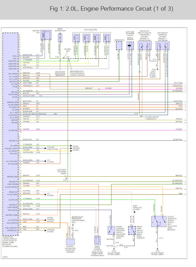

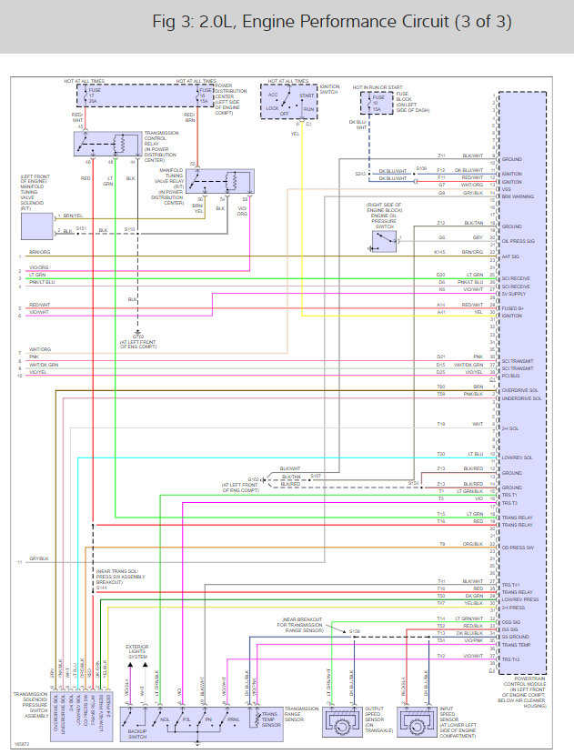

It does sounds like you have a wiring issue. Below are the rest of the wiring diagrams for you.

Okay, I am a couple weeks late, but back to the car. So far no change. I have not had a chance to start through the PCM harnesses yet. If I pull the plug on the y harness to the two fans, I get a p0480 and a p0481 so it recognizes an issue in both fan circuits. Plugged back in, I only get p0481. Should I start on the circuits that tell the PCM to turn the AC fans on?

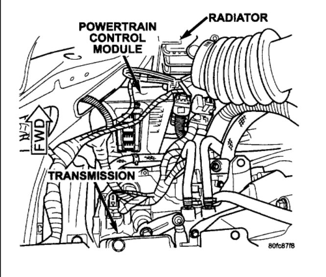

The computer runs the fans, it sounds like its having a problem with the coolant fan control driver inside the PCM. If you checked the wiring I would try swapping the PCM out with a used one to see what happens. Here is the location.

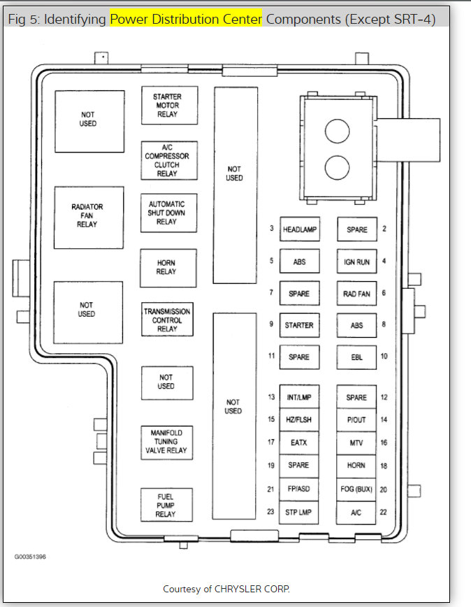

That code is cooling fan circuit failure we must be missing something int he wiring or the relay or fan motor is bad.
This guide will help you test the relay:
May 27, 2018 at 4:50 AM
