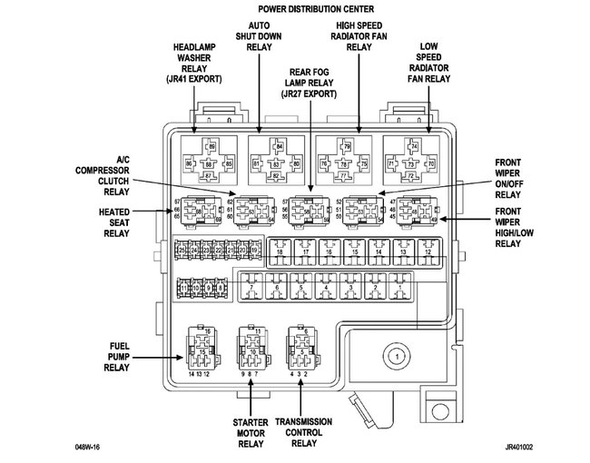

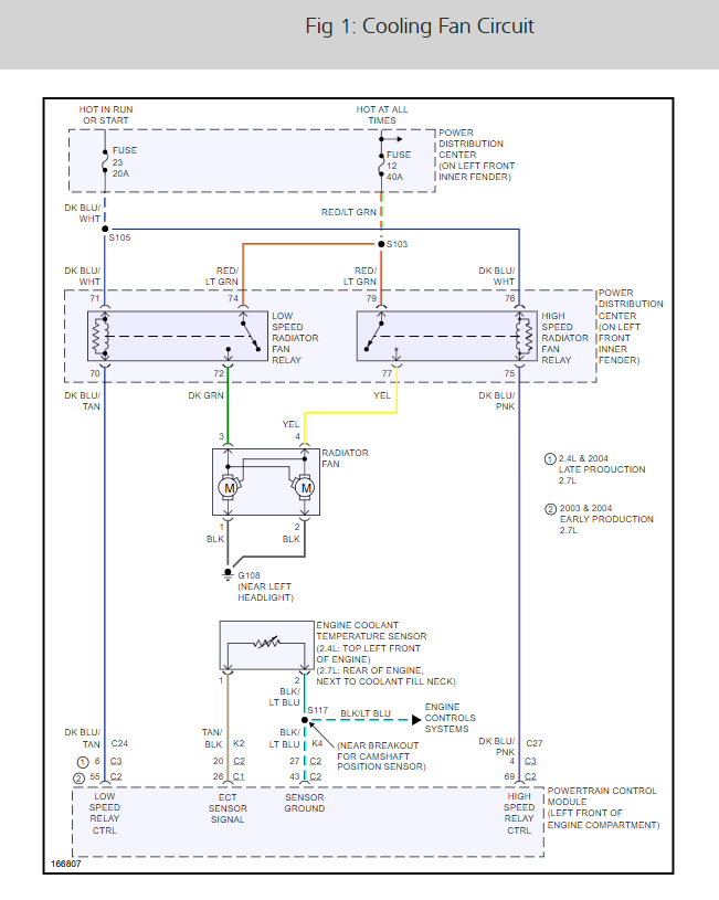

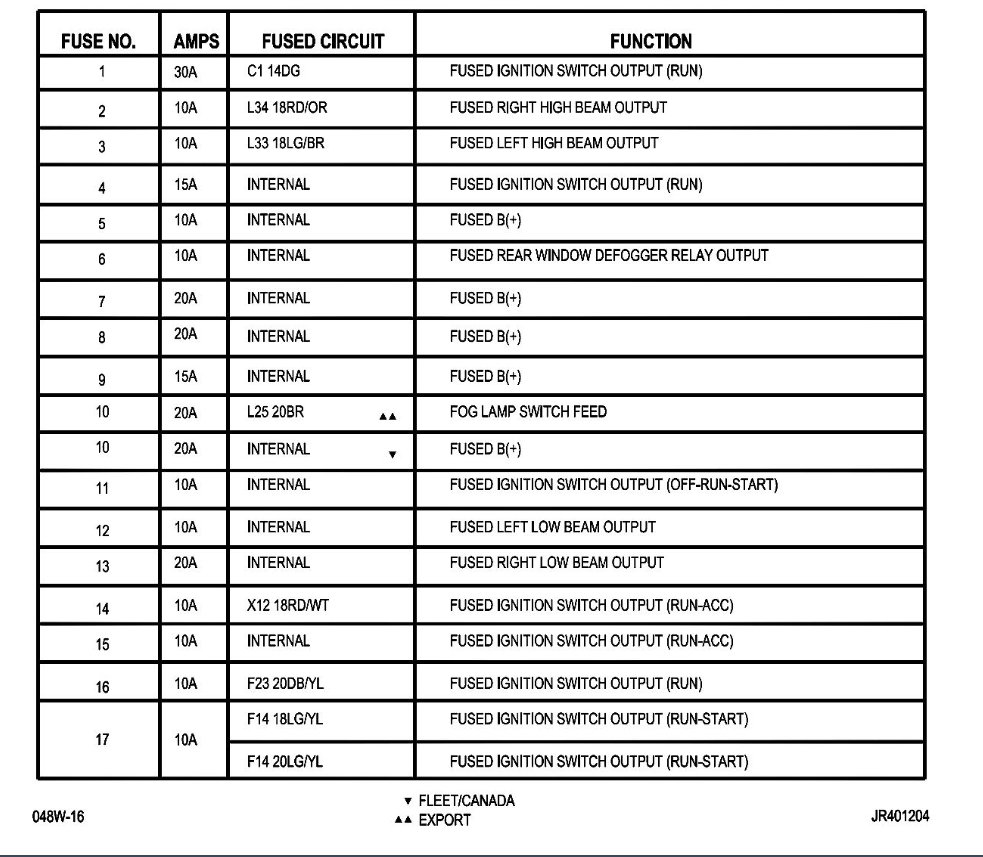

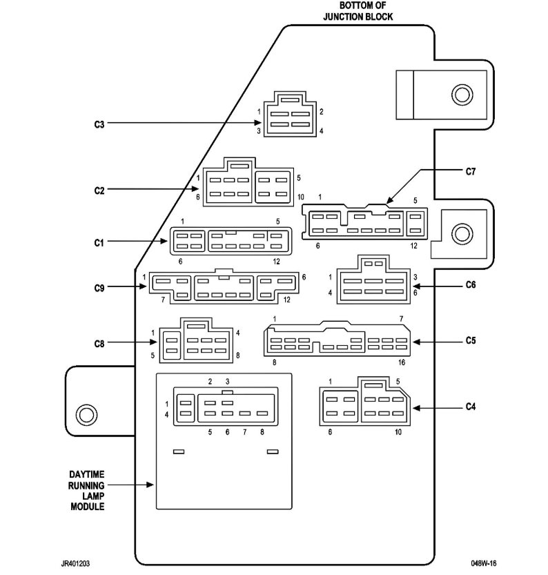

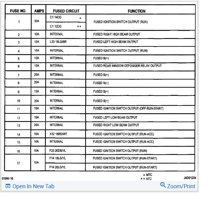

cooling fans not running and over heating
2005 CHRYSLER SEBRING
92,122 MILES
DPDANCER1
I replaced the thermostat and not realized the cooling fans are not running. the heater core is out and is leaking into my passenger floor board also. Thinking about it being the sensors or relay. Should I run it directly to the electrical lines? I don't want it jus rigged up!! It over heats very easily and quickly.
Jul 3, 2013 at 7:00 PM
WRENCHTECH
  • 20,761 POSTS

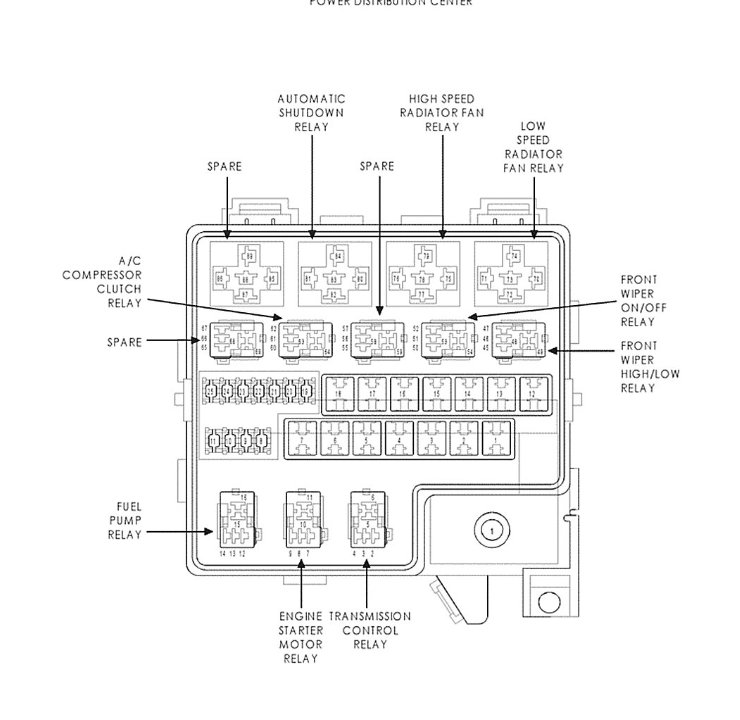

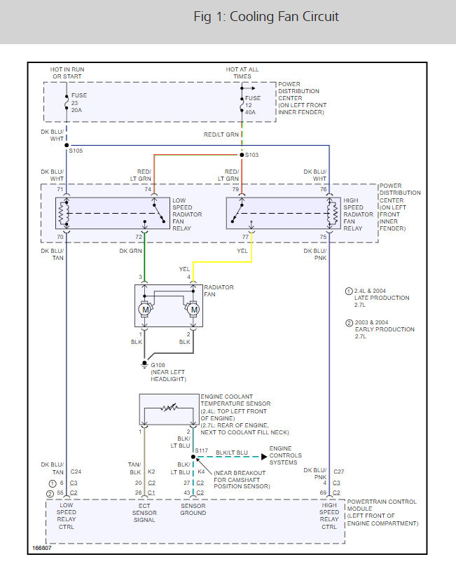

It sounds like you have a relay or fan motor out but to be sure here are diagrams and guides to help us figure out the problem. Please check the diagrams below.
and
and
https://www.2carpros.com/articles/replace-electric-fan-motor
Check out the diagrams (Below). Please let us know what you find. We are interested to see what it is.

Sorry for the late reply. Hope you got it fixed by now. Any applicable trouble codes? You might check the circuits at the fan relay?

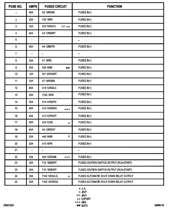

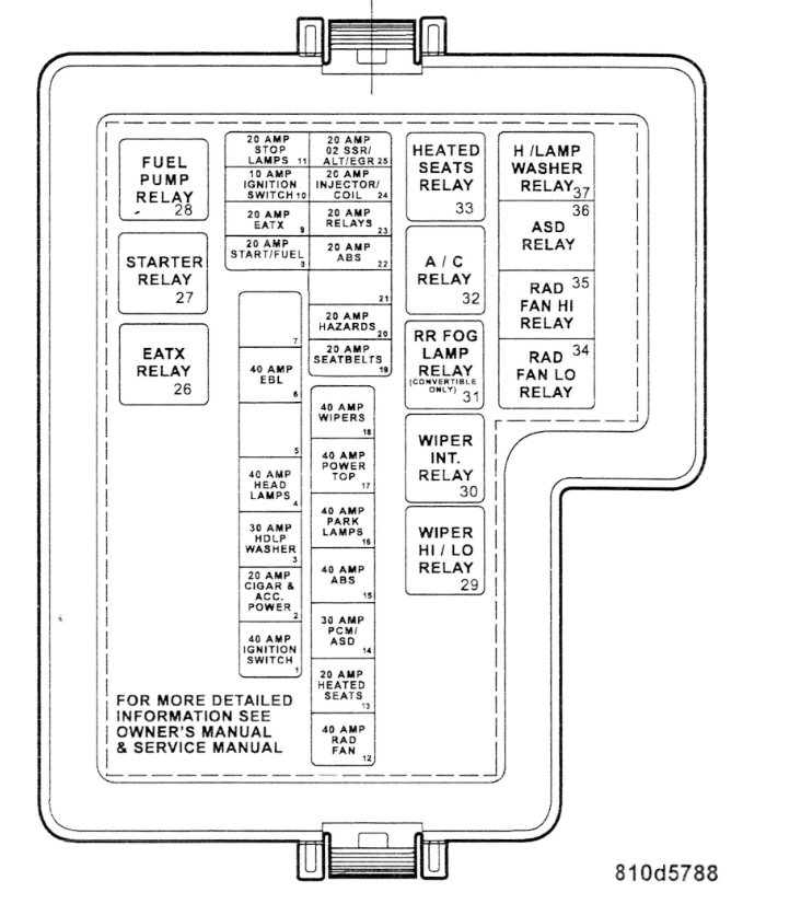

The cooling fan don't turn on and motor will start to over heat. Checked relay and the a/c stop working 2, days before that.
Nov 18, 2019 at 4:39 AM (Merged)
PATRICK MENDIS

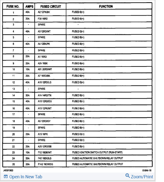

Check the Rad Fan Fuse. Its a 40 Amp Fuse in the fuse box. Fuse Box Cover shows the Name and Location of the Fuse. The Fuse Box is located in the engine compartment on the driver side.

PATRICK MENDIS
Try to rotate the Rad Fans by hand. I had the same problem. I found my high Speed fan was sticking. It did not rotate freely. Here are the fan fuse and relay locations. Check out the diagrams (Below). Please let us know if you need anything else to get the problem fixed.

I have a 2001 sebring LXI 3.0L V6 Coupe, my cooling fans work when i turn compressor on and engine is fine i can hear the high speed fan kick in and all is good. when the fans are off and the motor reaches operating temperature the fans wont kick in, and the gauge starts to rise. I have changed the relay, thermostat and temperature sensor. and nothing seems to solve this problem. There is a sensor by the front of the radiator that is closed ended. i don't know what it is but it just sits there. Did i mention its a Mitsubishi motor. I hope some one out there knows this motor and can help its only in 17% of cars.

It is extremely rare for the gauge's temp. sensor to fail. If the resistance value is off a little, the gauge will just read a little high or low. Problems occur when someone installs the sensor with teflon tape around the threads to insure a good seal. Most of these sensors use a single wire. The second wire is the threaded body. Teflon tape can insulate the sensor and the gauge will stay on full cold. Another problem is bent and stretched pins in the connector.
All kinds of new problems are showing up on newer cars because instead of simple mechanical gauges, instrument clusters are unreliable computer modules that run the gauges which are just voltmeters. Information is passed through the body computer, then sent to the cluster. Since computers over-complicate the circuitry, gauges are giving a lot more problems than in the past. Nevertheless, the gauge circuitry is completely independent of the computer controls that affect engine performance.
Temp sensors for the engine computer always have two wires. Rather than using the brass threads for the ground connection, the ground wire goes back through the computer so it can monitor current flow. These sensors have caused a lot of problems on Fords, but not on other car brands. If anything causes an open circuit, such as unplugging it, the computer won't know actual engine temperature, so the it will command the radiator fan on in case the engine is overheating. On older cars, this also killed any electronic timing advance. It was common practice to unplug the sensor when setting base ignition timing with a distributor when doing a tune-up.
Under normal conditions, the engine computer turns the radiator fan relay on at 210 or 212 degrees, and off at 198 degrees. In addition, the computer will command the relay on whenever the air conditioning is turned on because of the extra heat load presented by the condenser which sits in front of the radiator. On some models, the fan runs constantly with the AC on. On some models, the compressor cycles on and off, and the fan cycles on and off at the same time. This cycling has nothing to do with engine coolant temperature. It is in anticipation of the condenser temperature.
The engine computer performs a check on the coolant temp sensor when the engine is cold. It expects the temperature to be the same as the ambient air temp sensor or the battery temp sensor. If significant disagreement is found, the computer may memorize a diagnostic fault code and turn on the "Check Engine" light. This is a pretty rare occurrence.
Hope that clarifies the fan operation. The AC and the temp sensor are two different circuits that independently affect when the radiator fan runs. Your mechanic can connect a hand-held computer that will read out the sensor values the engine computer sees. You can watch coolant temperature rise as the engine warms up. This is the sensor that affects fuel metering and emissions, but it has nothing to do with the gauge.

VINCE325
  • 5 POSTS
Fan works when a/c & defrost are running. Put in new temp sensor and high speed fan relay, ran up to temp and NO fan. What's next? Thanks.

INTERNETMECHANIC
  • 700 POSTS
Did you try checking for mil codes? According to MOD, you should be able to access some mil codes? You cycle the ignition switch, on--off, on--off, on. Turn turn key just till the dash lites come on, no further. The mil starts flashing, you count the flashes to get the codes. Your looking for two digit codes. The databases are not always correct,but, it won't hurt to try. Below is diagram for low speed fan relay. The info I looked at was sebring LX. Terminal #5 is voltage for the load switch side of relay, hot all the time. Terminal #3 is voltage for the coil side of relay, goes hot when you turn on the key. Terminal #1 is ground for the coil side of relay, controlled by the pcm. When the relay is energized terminal #4 becomes hot and carries voltage to fan.

VINCE325
  • 5 POSTS
Tested problem this morning. Cooling fan only kicks in when A/C or Defroster is on. When turned off, cooling fan will not kick in. Is this a relay problem? If so, where is it located? Thank you.

VINCE325
  • 5 POSTS
Not yet. Been using it with A/C running all the time (not a bad thing since I live in Florida) just to keep the fan going. I'm probably going to finally bring it in. I've replaced the temp sensor on coolant line, fan relay, and battery. No luck.

LAVINCO
  • 10 POSTS
Mine seems to be working now. I changed all 4 relays in the box under the air filter arm to the intake.
After that, I flushed the radiator and bled out all air bubbles by running the engine from first start for 10 minutes with the radiator cap off, heat on full blast and jumping on the car to wiggle bubbles out. I also made sure that the coolant in the radiator fill area was full to the top because the engine temp sensor is just past the cap so if air gets in that area it will malfunction.
From there, I pulled out the aftermarket radio and double checked all the wiring finding that the stock amp plug was never taped off by Best Buy install techs. So I taped it off and put it all back.
It works great now.
